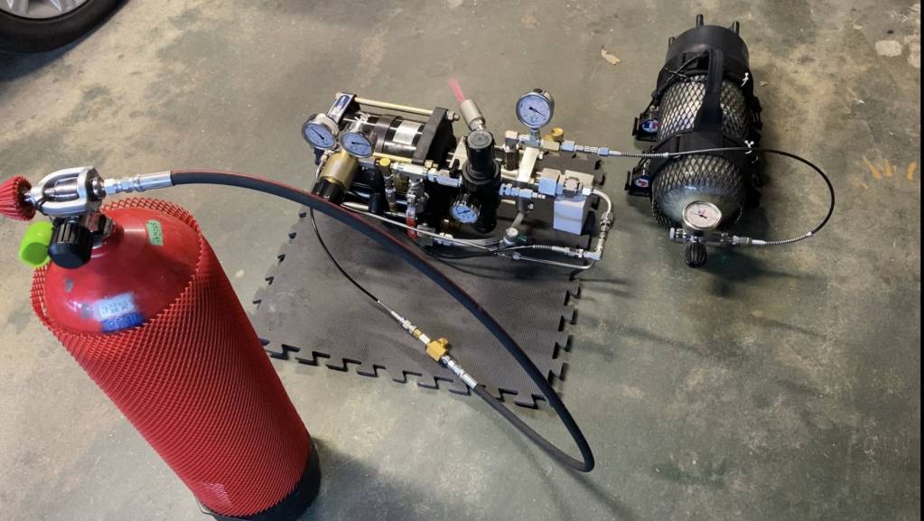

That depends on your supply air to the booster pump. If your supply air source is dry from a scuba tank with lower pressure and not enough to fill your airgun and you are using that as your supply air then I don’t believe you will need a moisture filter. If you are not sure if your supply air then an filter is recommended. For example on this setup I’m using a scuba tank as my supply air which is filled up to 3000 psi from my scuba compressor then it’s use to boost to my CF tank then their is no need for a moisture filter since my supply air is dry.

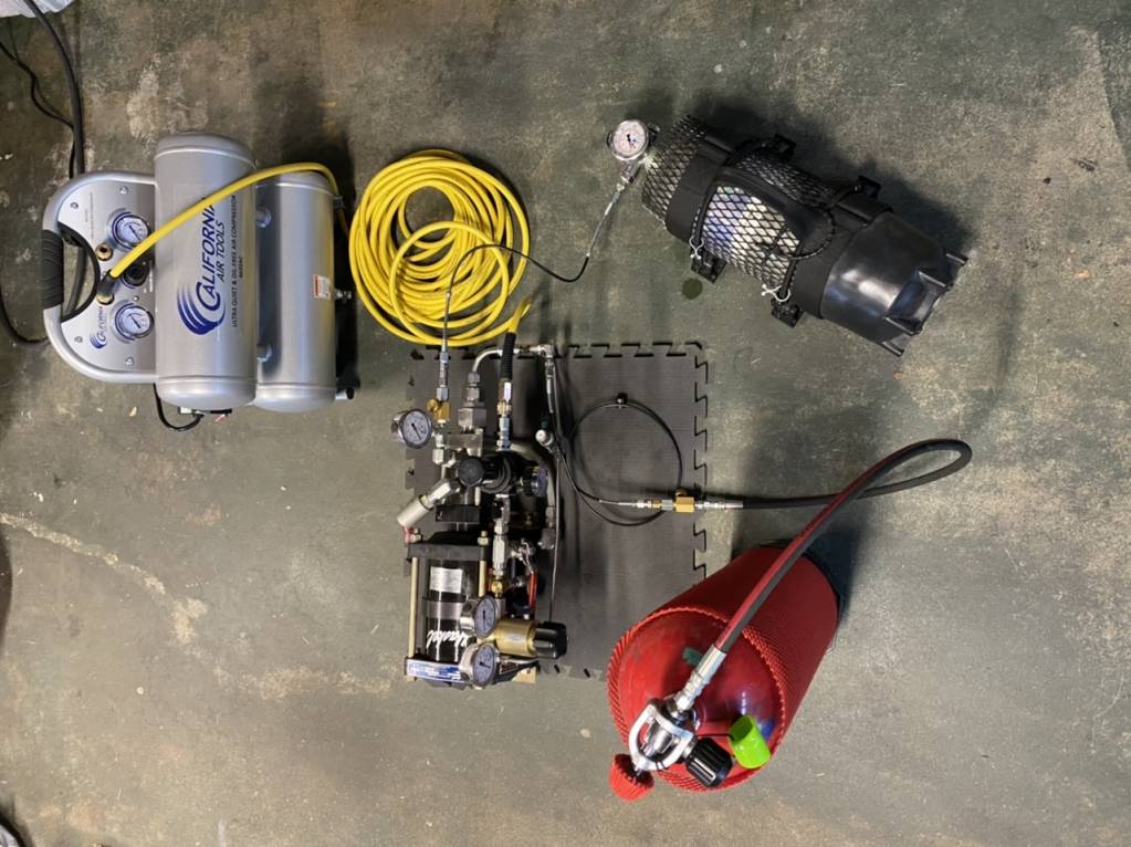

This is my airguns tank filling setup.

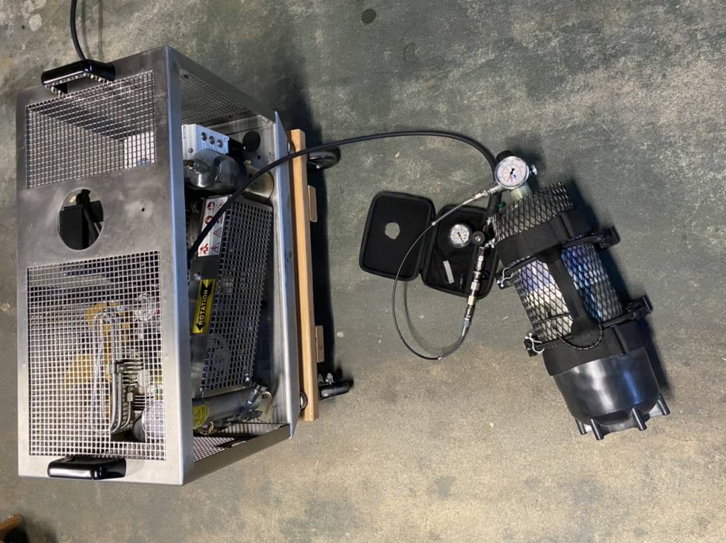

1. Top up CF tank with scuba compressor to 4000 psi (don’t want to over work my compressor even though it’s rated at 4500 psi)
2. I use an extra scuba tank as my supply air for the Haskel booster to booster the CF tank from 4000 to 4500 psi. The shop compressor is used as my drive air for my booster and the red scuba tank is used as the supply air as shown here.

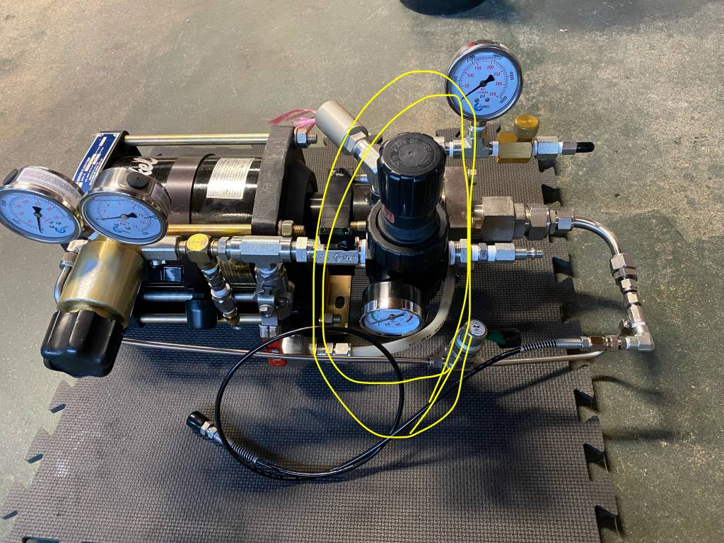

I builded my booster setup as it can be driven by the supply air with a regulator regulating the scuba tank air down to about 150 psi as that the maximum drive air the Haskel booster needs as shown here on this video.
