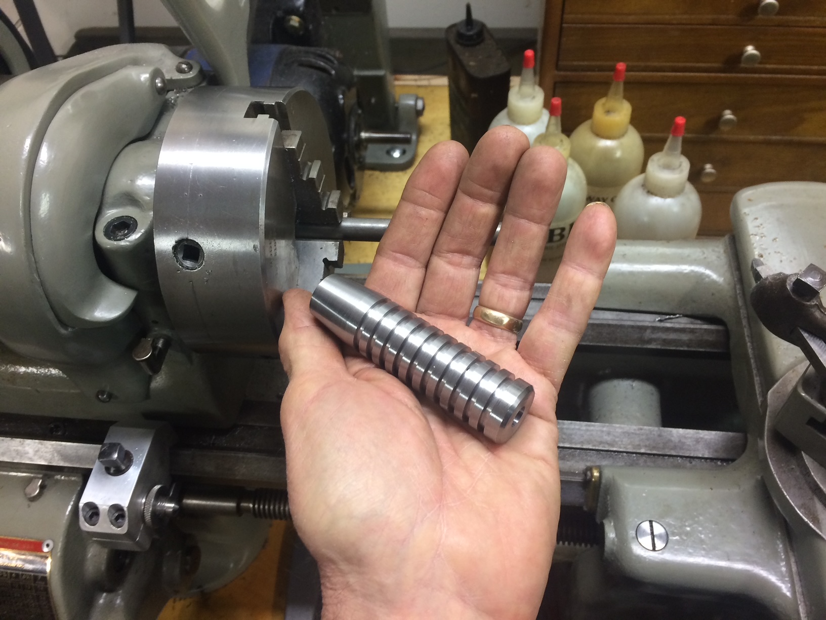

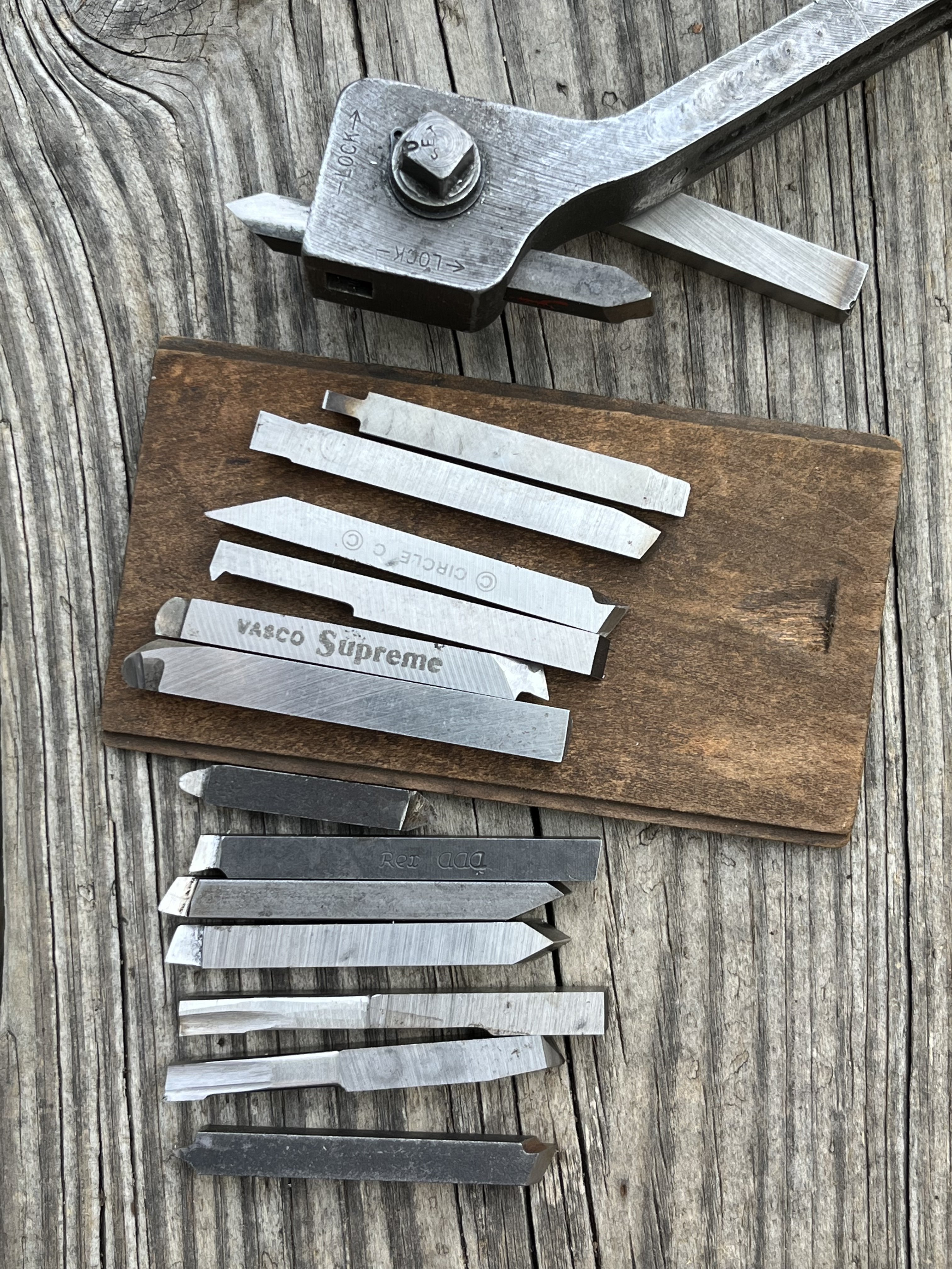

I use cobalt high speed tool steel. Sometimes a parting tool. Use a radius gauge to check profile to grind proper radius on tool.
Hold tool and gauge up to a light source. Grind or hone on a stone until you see no light. Break sharp edges on part machined.
Taper tool a few thousandths front to back and top to bottom for clearance of tool to part so it want chatter on larger O rings.
MM
You need to learn to grind HSS tool bits to get the most out of that lathe. Form bits and parting tools are prone to chatter. You might have to slow it down some. I recommend 0 top rake for form bits, parting tools, and threading bits.
