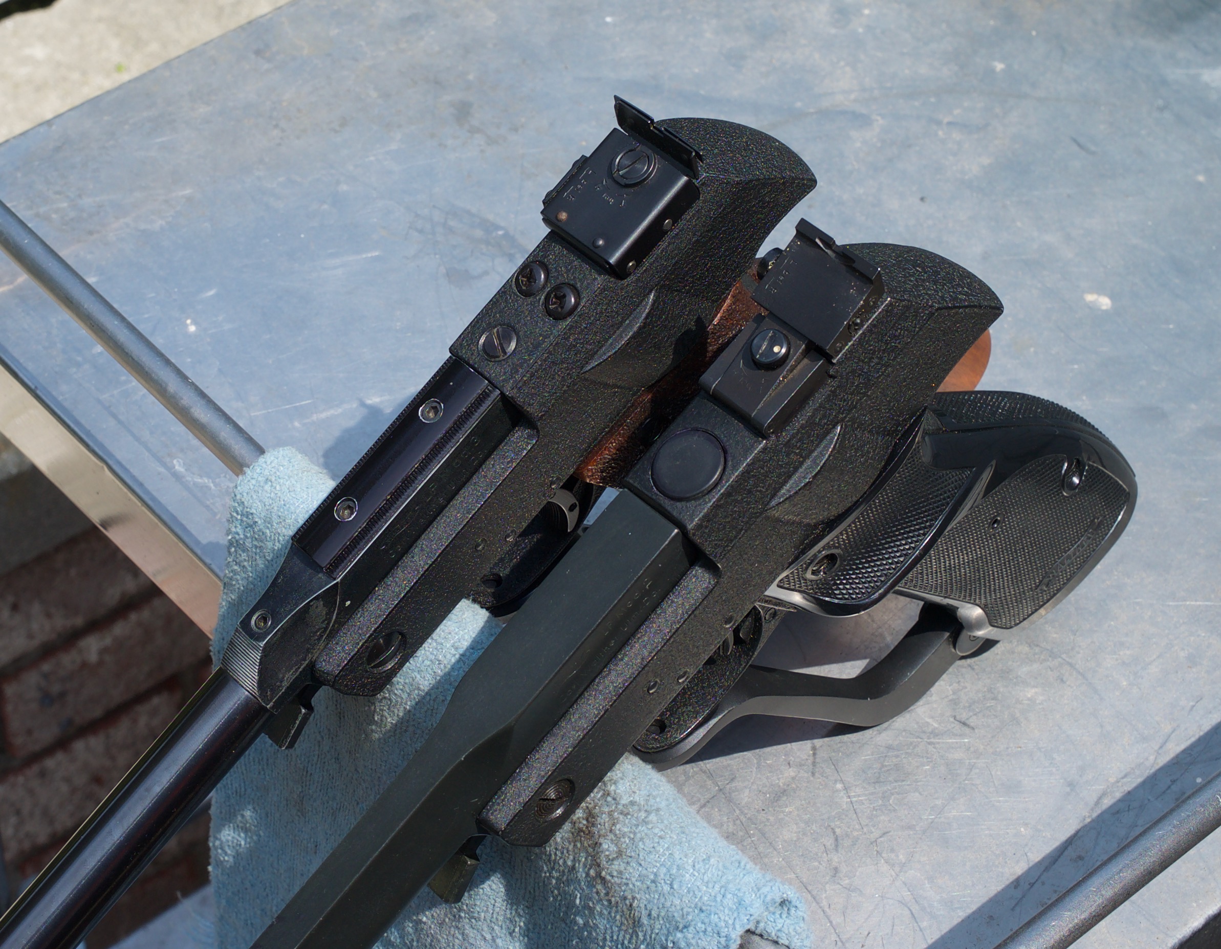

Interesting question! Do an experiment, and just mount the dovetail using the already present tapped sight holes on the Weihrauch breech block as someone did here, using
a Walther LP SSP?
Reactions: beerthief
Interesting question! Do an experiment, and just mount the dovetail using the already present tapped sight holes on the Weihrauch breech block as someone did here, usingView attachment 379088 a Walther LP SSP?
yup just what i am talking about . on Break barrel guns the rear sight is mounted on the barrel to eliminate barrel lock up issues , SO why not a scope mount ?
