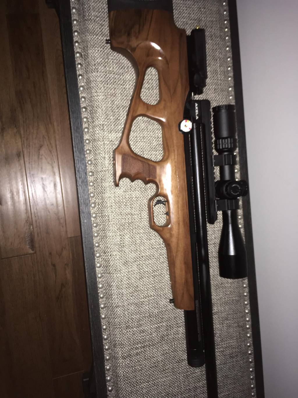

Can anyone advise me on how to use this product? I want a nice satin "in the wood " finish. I tried RLO and it turned into a messy nightmare. Could not get an even finish and now it seems too built up. Perhaps somebody experienced can assist with some advise. Looks like I am going to have to strip this stock and start over. Resand and restain. UGH! A real nice walnut stock the stain came out great and then problems with the RLO. I get really great results with Tru oil but don't want that look on this stock. Maybe I should use a different product? Thanks

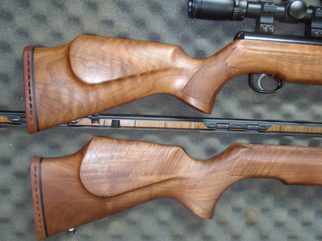

Moving ahead,I chased out the checkering with a triangle needle file and sanded everything with 600. We'll see what happens next. Came out well and the pores are filled nicely. So that much is accomplished. This stock is a looker.
wethy, your work looks great. Inspiration! Thanks.
I;m working on the lower stock. Both are Tomahawks. I trimmed down the comb because it was too high. As shown. Took a 1/2 inch off. It's looking great. The stain I used really turned it on. Will post finished pictures later....
