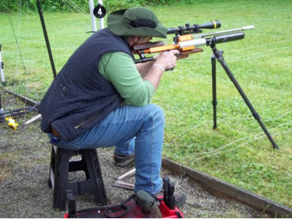

I assume you want to shoot hunter.
(Assuming that your USFT is within spec) You might want to think about shooting open instead. Just starting out.
Open gives you more comfort, less wobble, more positional consistency, more stable shooting platform, higher scope magnification...then as you get more comfortable, get higher scores, graduate to hunter.
Then if you want a real challenge....go to WFTF (WFTF springers if you are bitten by the FT bug).
I agree also with slowing down your shot cycle, slowing down your trigger pull, etc.

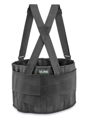

One obstacle choosing open class is going to be the harness. I know the Price harness is no longer available. I thought someone else started making one recently but I could be wrong. The good news is that if you are handy, this might be a DIY project by modifying a back support strap.
