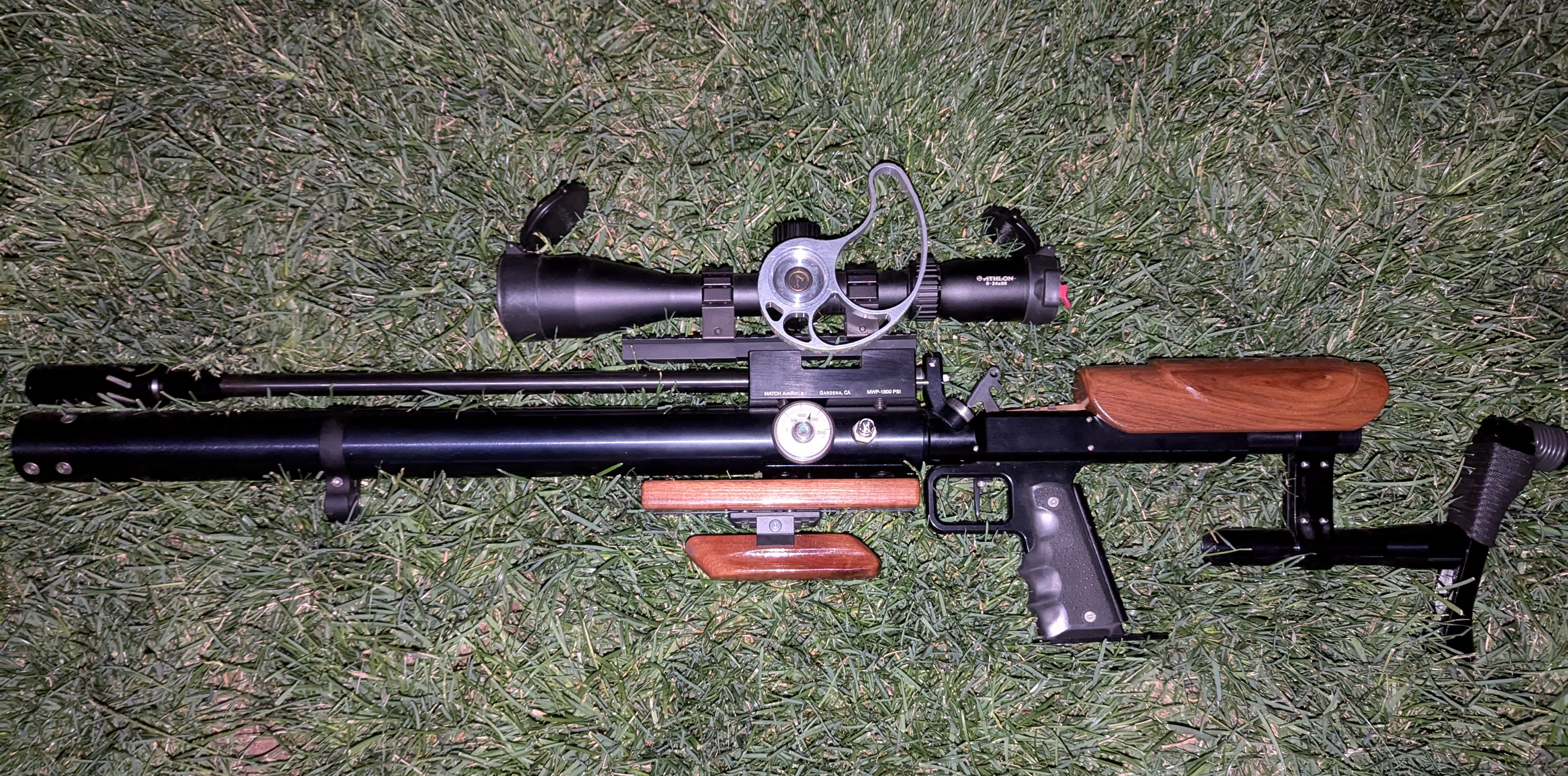

Dawned on me a few weeks ago that I already have a simple version of a hamster. It came with a different gun, but was easily attached to the USFT, via a UIT to picatinny adaptor, that I also already had. Gotta say, the walnut and walnut and black and black almost makes this look like it was supposed to be. This is a big improvement over the heavy MAC1 hamster. For Open class, yeah, id prefer the MAC1, but when all that weight is otherwise a liability, and the adjustment isn't necessary, or helpful, or allowed ( Hunter class) than this simple riser is the better of the two options.

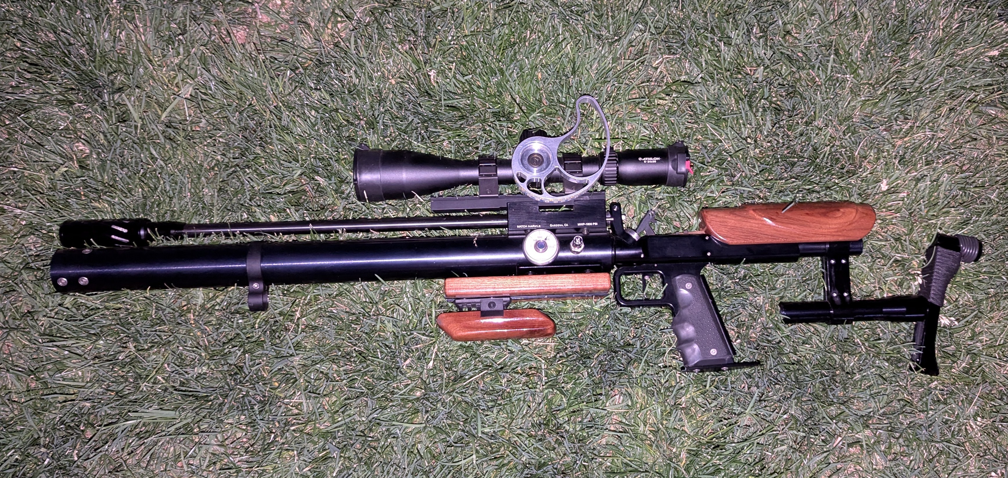

Here was the first attempt ..
Realize I needed it back a couple more inches for balance point/preference/ergonomics so did just that...

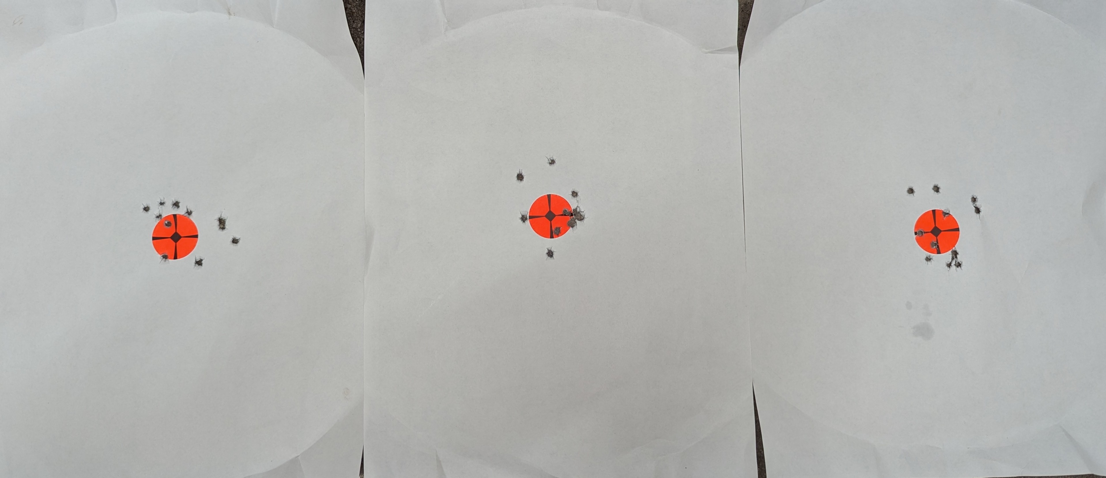

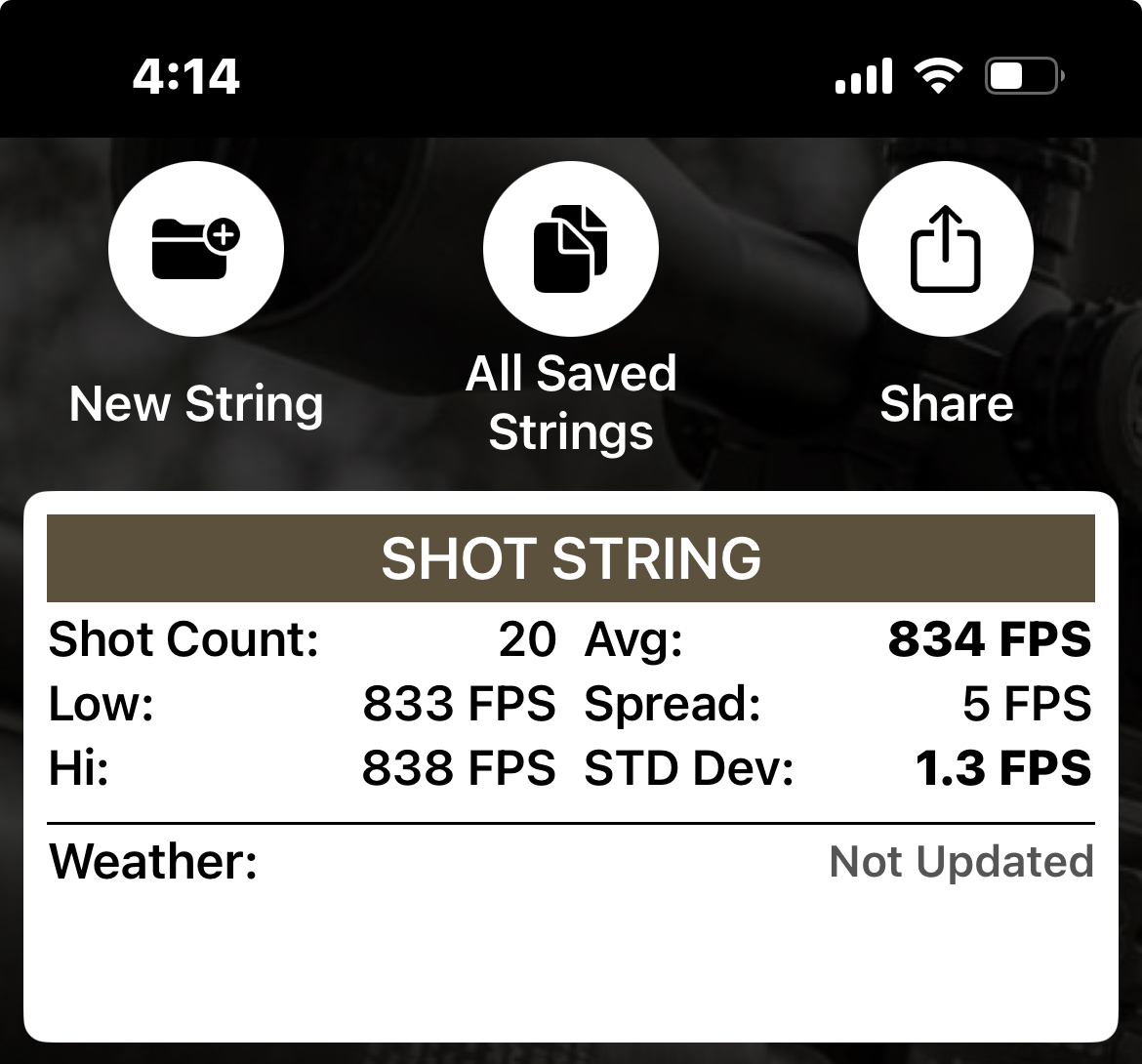

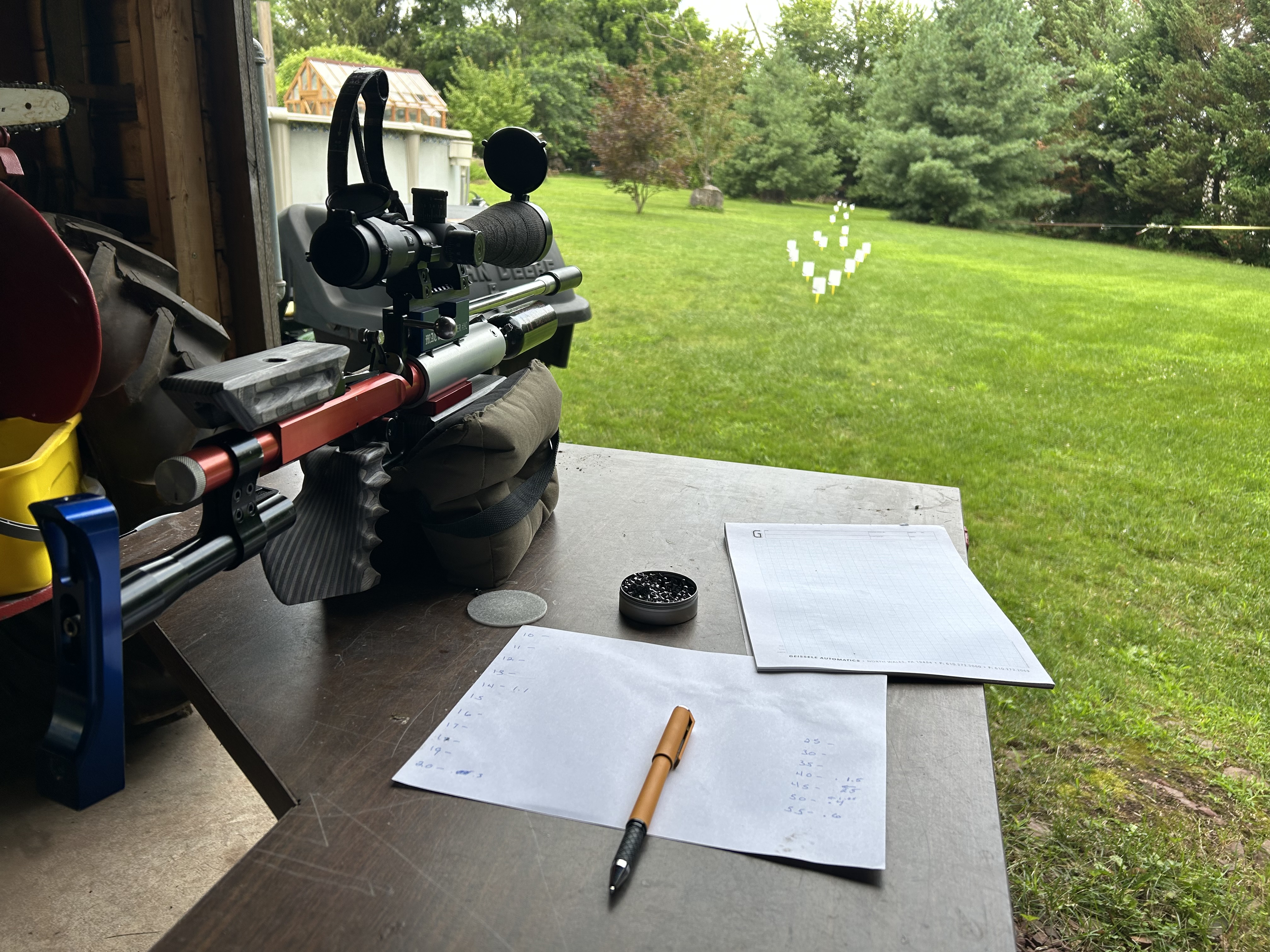

Had a little session with it this evening, shooting 3x10 or 11 shot groups at 30yards, from offhand position. Nothing to be too horribly proud of, and certainly some room for improvement. There's an interesting point where muscles get fatigued and the sight picture becomes more and more of a drive by. I'm embarrassed to say that was less then the 30ish shots I took from offhand during this session. I'll need to get in offhand shape for the summer matches.
The orange stickers are 1" if I remember right. Lol, yeah, nothing to be proud of here.

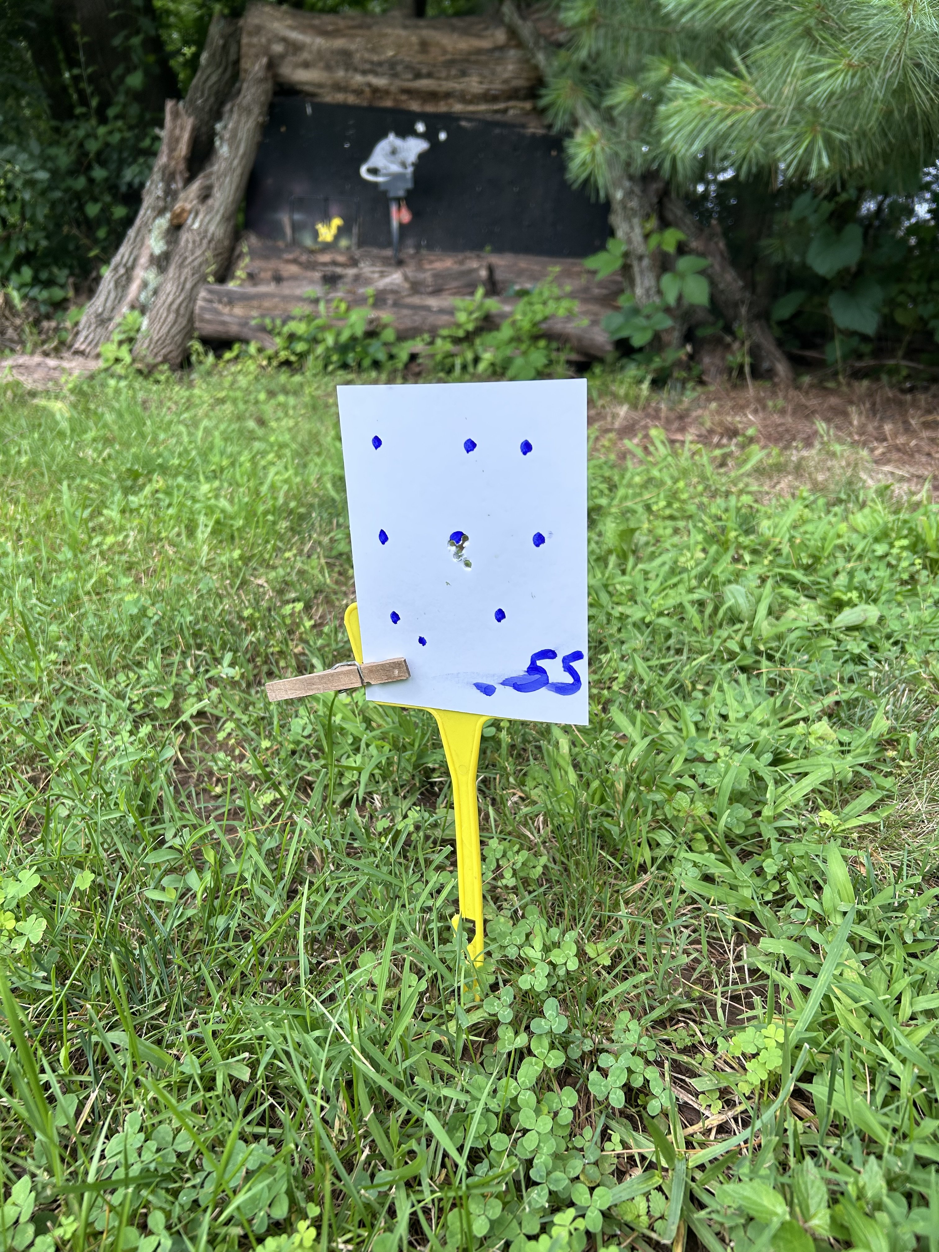

Second round of shoot-off: Same 1/2" KZ at 50 yards, but offhand!!! Yeah right-that's a 197 Troyer target!!! We all three missed, two of us drew faceplate at least, lol.
Third round of shoot-off: same 1/2" kill zone, but scooted the shooters back to 54-55 yards, and let us go back to stool and sticks. We're now looking at a 122+ Troyer target. We all missed the first round @ 55yards, but I thought I could see my and Bobby's hit on the right, lower edge of the kz, due to a little bit of wind quartering in from about 10:30-11:00 .

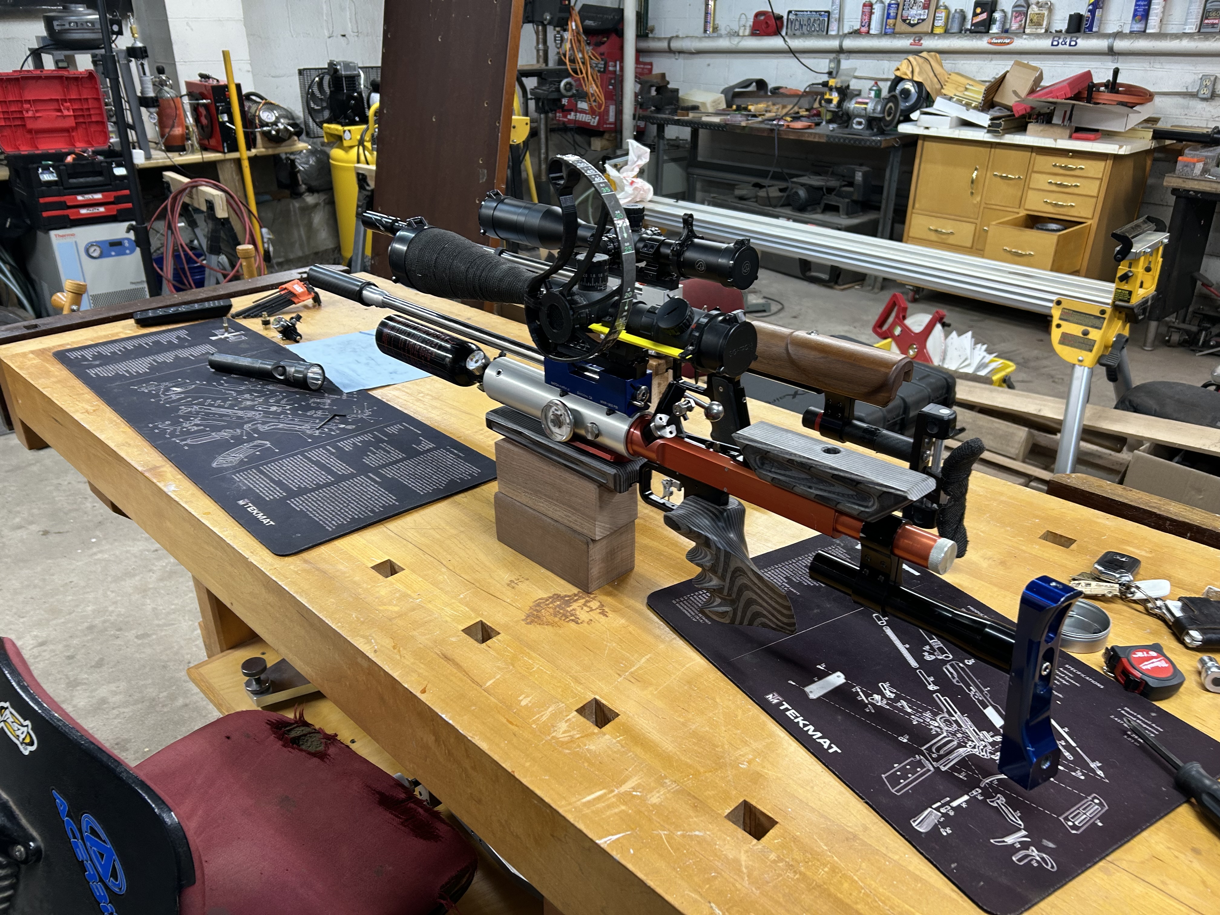

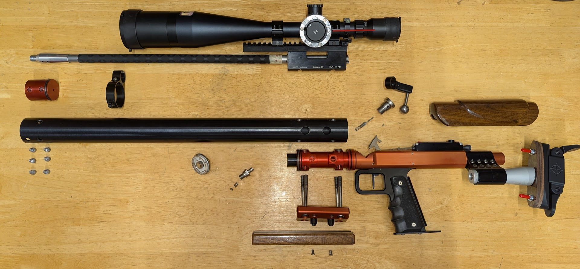

Reseal of Hunter #95
This was the first time I've disassembled a USFT, and it was pretty cool to see how it works. My take-away was that LD's naming his baby the "Simple Simon" was spot-on, cuz there's just not a whole lot complicated about them. Simply not a lot of rings, and no complicated parts. Elegant in their simplicity.
All the parts laid out...

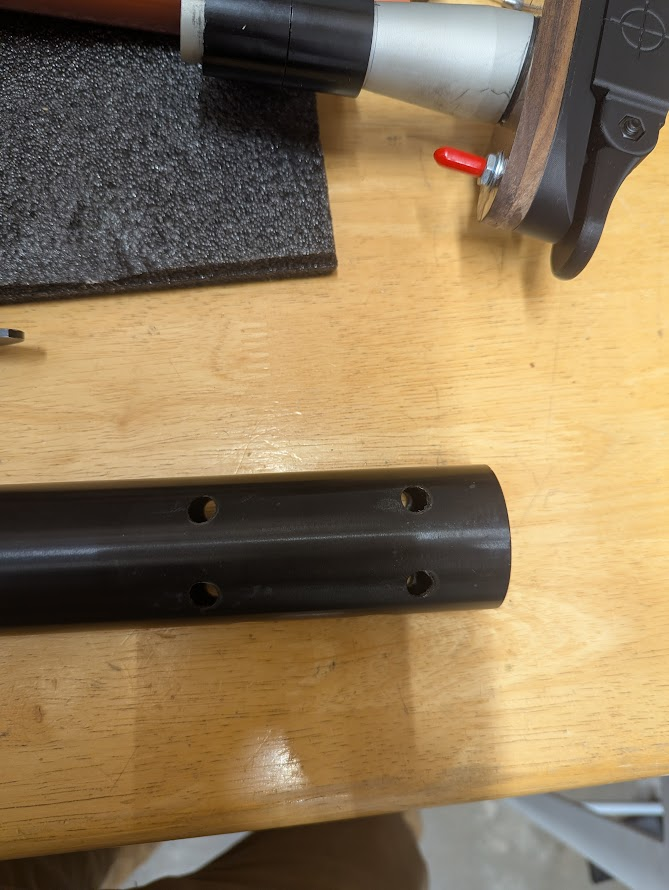

First task was to file down (yeah, I groan inside just thinking about it) the raised bumps for the holes through the tube. For whatever reason, this particular USFT had some nasty ridges of sharp aluminum at the boltholes through the tube. In texting, @Arzrover speculated that perhaps A BUNCH of barrel swaps while pressurized could lead to this. I was wondering if over-torqueing the bolts could cause it. Dunno for sure, but it needed ameliorated. So, file. This was the before and after of the filing and then some alumiblack to try to touch up the filing. Of note, the distorted metal is mostly on the side of the holes that the bolts would be pushing on from the pressure in the tube. I inspected my personal USFT, and it doesn't exhibit any of this hole distortion. Again, was # 56 over-pressurized at some point in it's life? Problem is now solved. I did verify that there were no sharp burrs at the bolts holes on the inside of the tube (potential for cutting orings on reassembly).
End plugs for air tube...

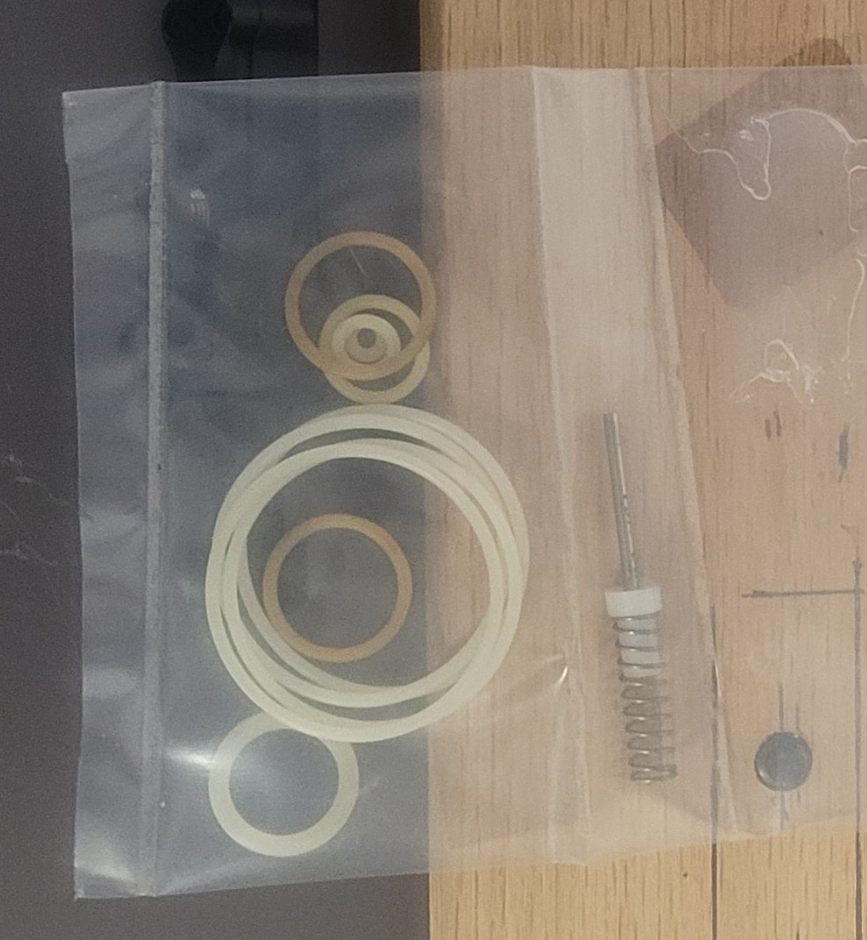

Of note here is how three of the six oring grooves are un-anodized. Tim's reseal kit only contained 3 of the urethane 028s for this groove, and one of the black (viton/buna?) 028s, yet this particular gun needs a total of six. The non-anodized grooves and not enough of them in the seal kit made me wonder if these were added by some owner some time after it left Tim's hands. Regardless, I had ordered extra 028s in case I nicked one or had trouble getting it to seal so it worked out.
Tim is huge on urethane orings, specifically 90d. His old website talked about their longevity. My personal USFT was made in 2017 and still has the original orings. If I'm remembering correctly, @Arzrover told me his from the early 2000s is still running on originals too.

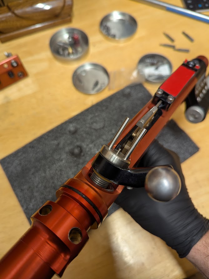

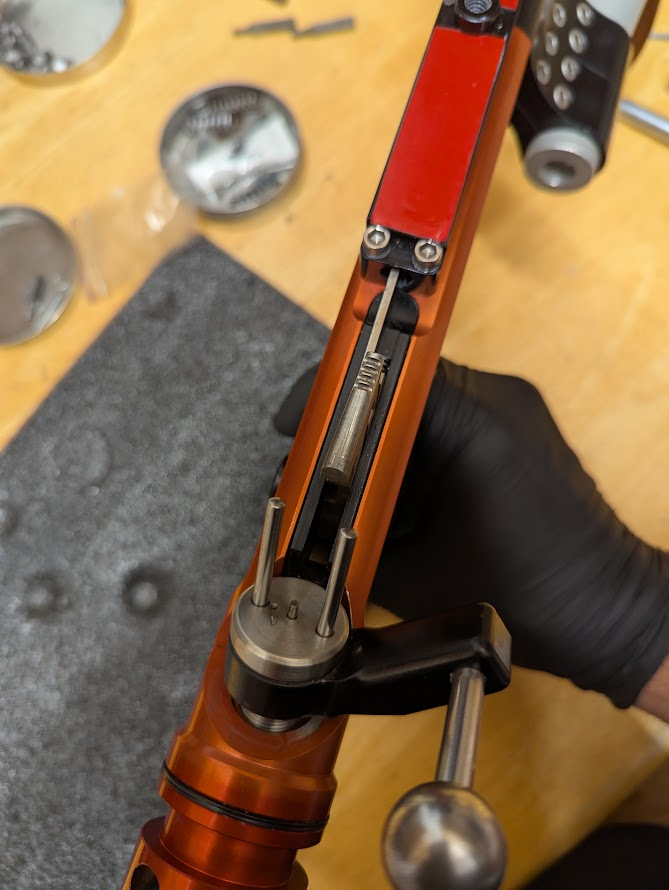

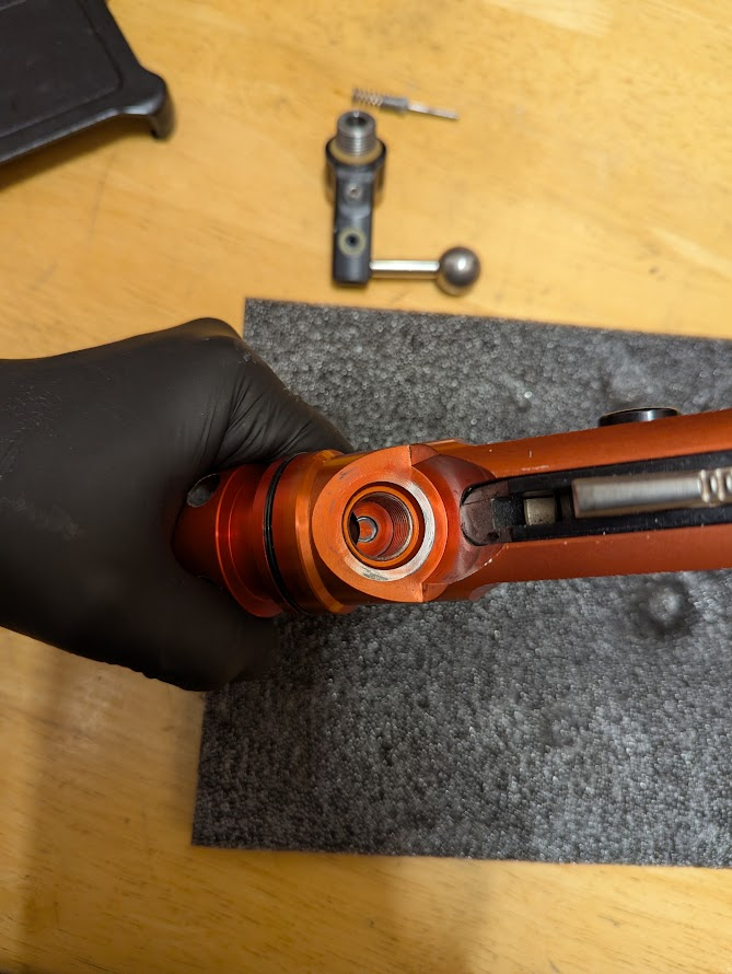

The valve is removed through simply unthreading it, using the pin holes on either side of the exposed valve stem. A tool was sold by Tim for this express purpose at one point, but I had some pins that fit perfectly and worked just fine.

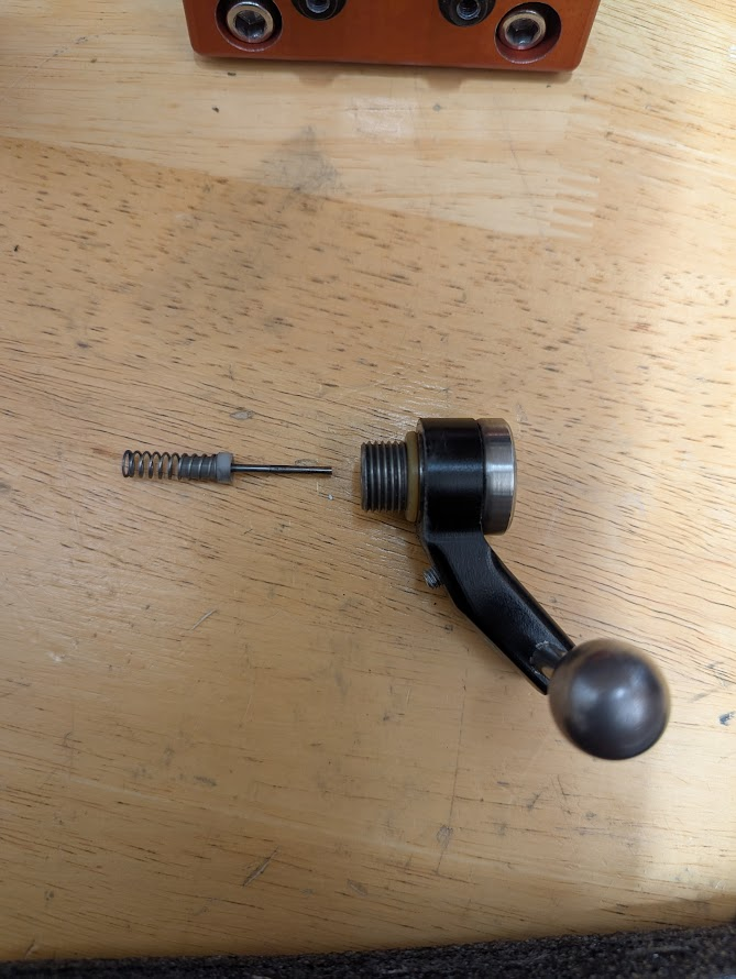

Poppet return spring sits in that small depression in the bottom of the threaded hole that the valve comes out of.
Swing breach removed from valve here. It rotates on those two parallel orings for opening and closing for loading/firing.
All said and done, I got it resealed and now holding air. But it did require a few baths and hair dryer/time on the trampoline in the sun a few times for the dry-out.

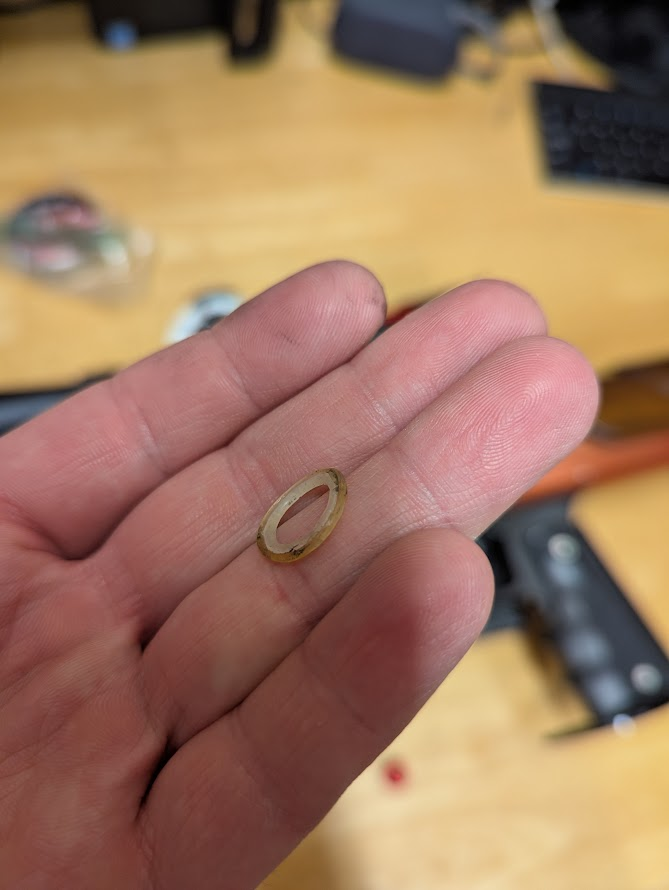

  • The tiny little oring in the check valve is a pain in the butt. Being 90d, there's just not much stretch. And being so small makes it even harder. I eventually got it, but it was a bit frustrating that such a simple little part of the process took so long. I was taking great care in not scratching or nicking the oring groove. And the check valve is just tiny to hold onto. No tips here, just be patient.

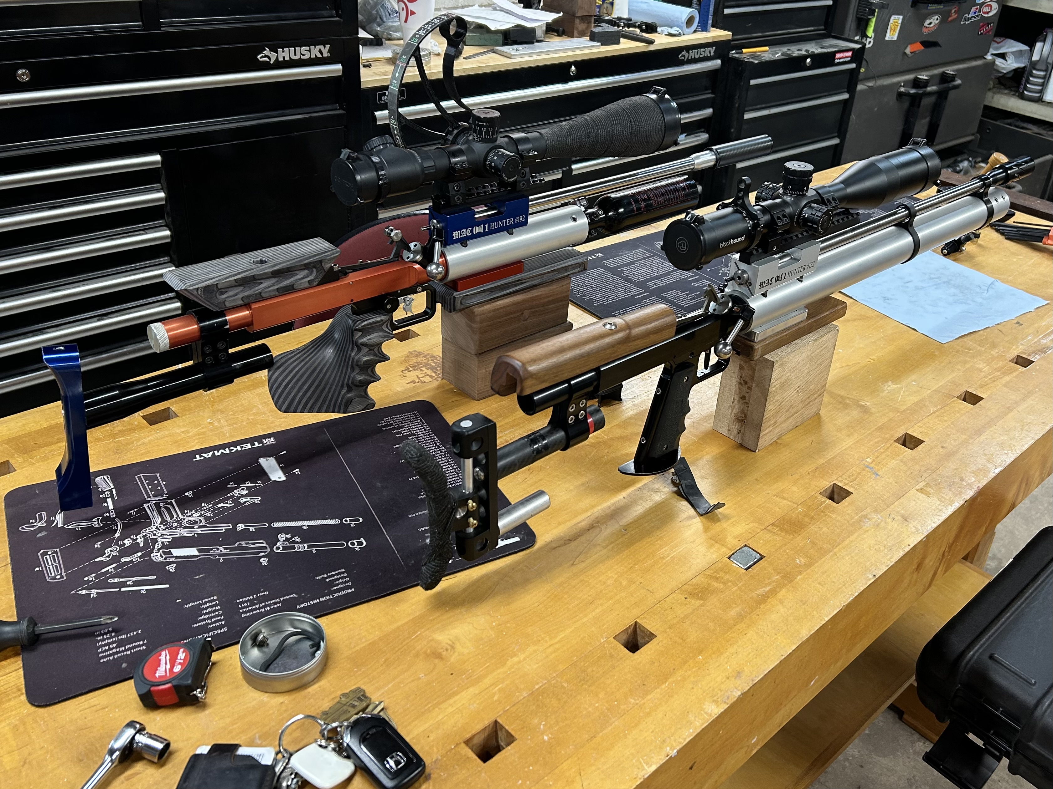

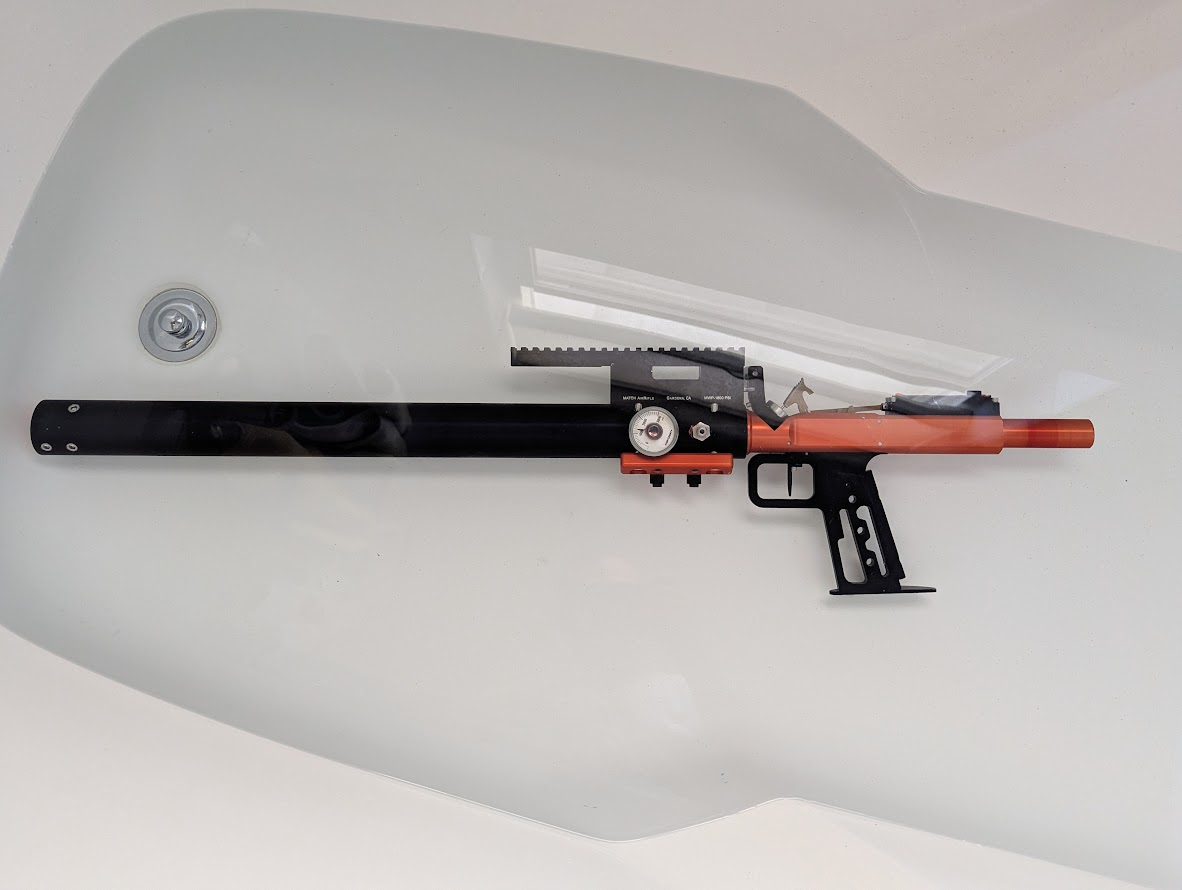

Here are red and black Hunter #95 and my personal Hunter #165.
