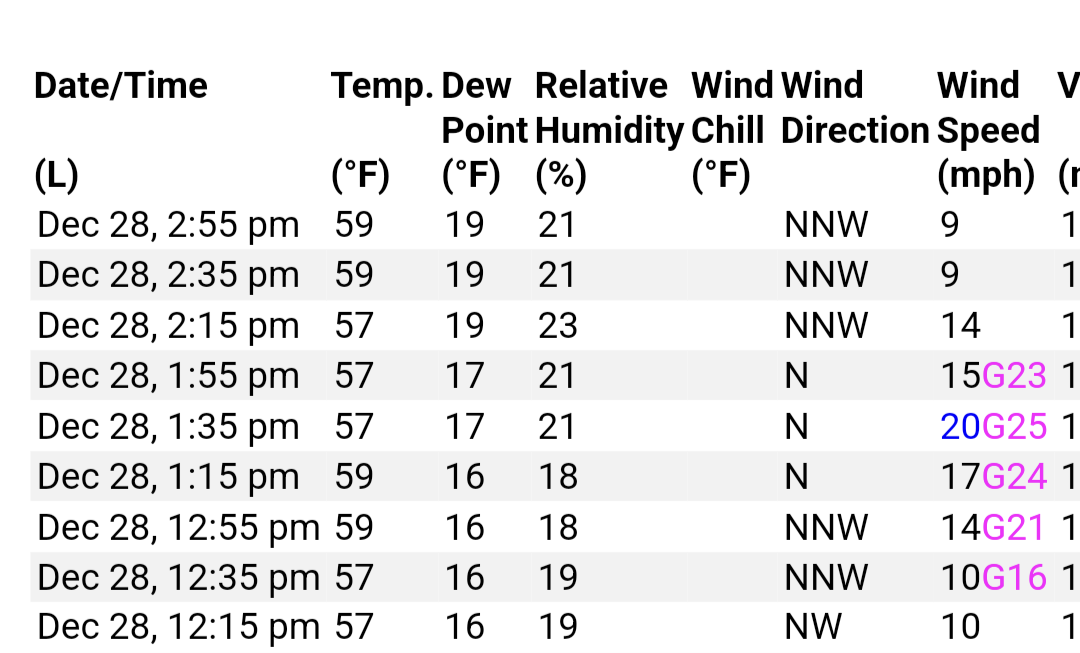

Spent many enjoyable hours shooting the .20 USFT today.
The prevalent wind at my house is usually coming from directly behind my shooting position, going "out" in the same direction as projectile travel. BUT today I had a rare NNW wind that creates an almost perfect 90 degree angle to pellet path. And so I decided to hold a "match" comparing two .20s. The purpose was to see if one is more accurate than the other, specifically in the wind. And also to see if one gets pushed further in the same wind.

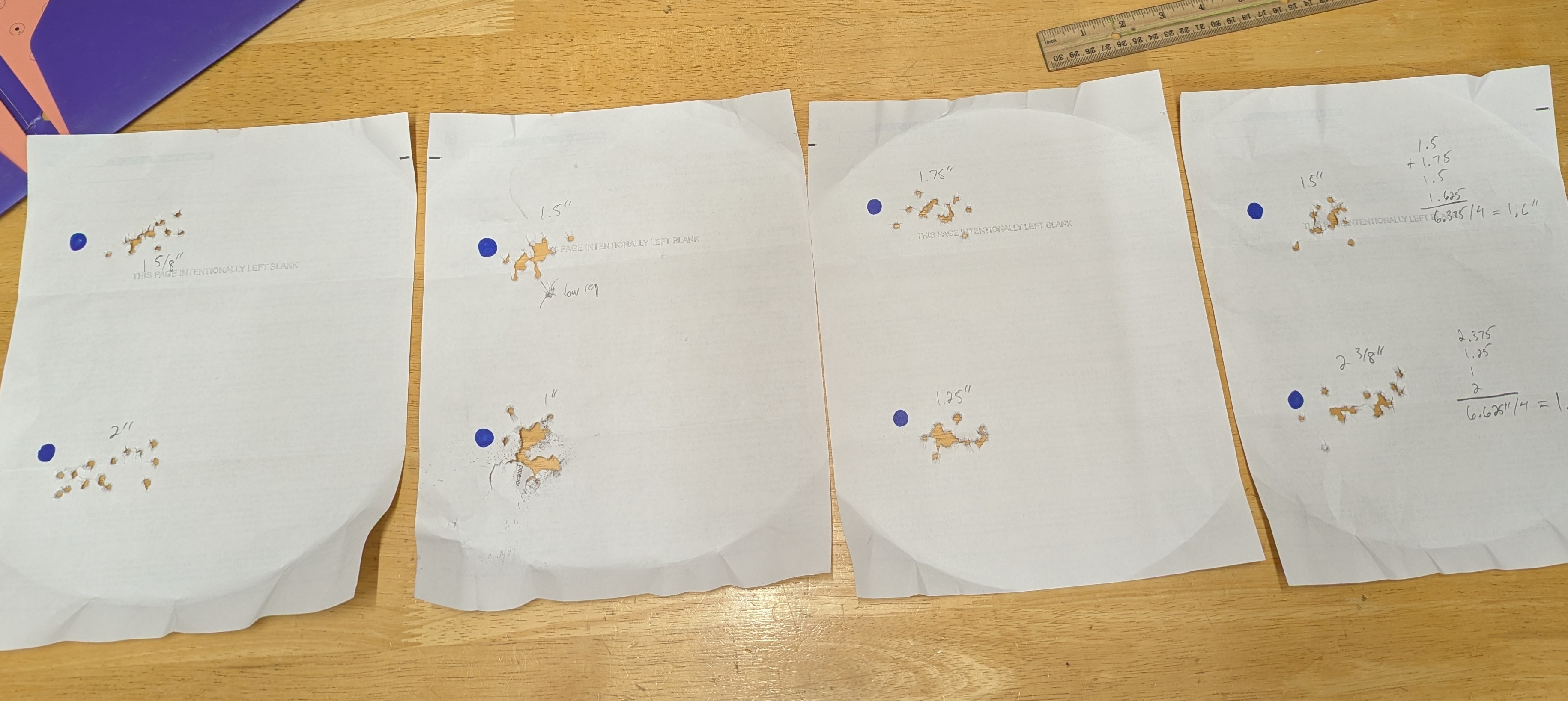

So, I shot 4, 15 shot groups from each gun. The top of all of these is the Veteran .20 and the bottom is the USFT .20. No hold offs for wind, just holding on the blue dot. Also not timing for between gusts. I WANTED to see how the guns shot without any attempts at reading the wind. The purpose behind that was to not muddy the waters about misreads and hold offs affecting group size and/or wind deflection . So, 3 shots with each gun, then switch. Five rotations of that for each 15 shot group, repeated a total of 4 times.
All shots were taken from stool and shooting sticks. Distance = 57 yards.
This series was taken from about 1 o clock to 230 ish. Off and on (lunch, kids, laundry, etc).
Wind deflection is very similar between both barrels, enough so that neither is at a clear advantage in that regard.
The average group size of one was 1.6" and the other was 1.66." So again, no clear winner. And that is actually good news, because the Vet .20 is a proven performer. Not show so much in the shared groups, but the Vet .20 is a slightly more accurate barrel, but with an OAL of 26", its a harder gun to hold steady. The USFT is longer and that length seems to reduce the reticle wobble. So the more stable USFT platform makes up for the slightly more accurate barrel in the Vet.

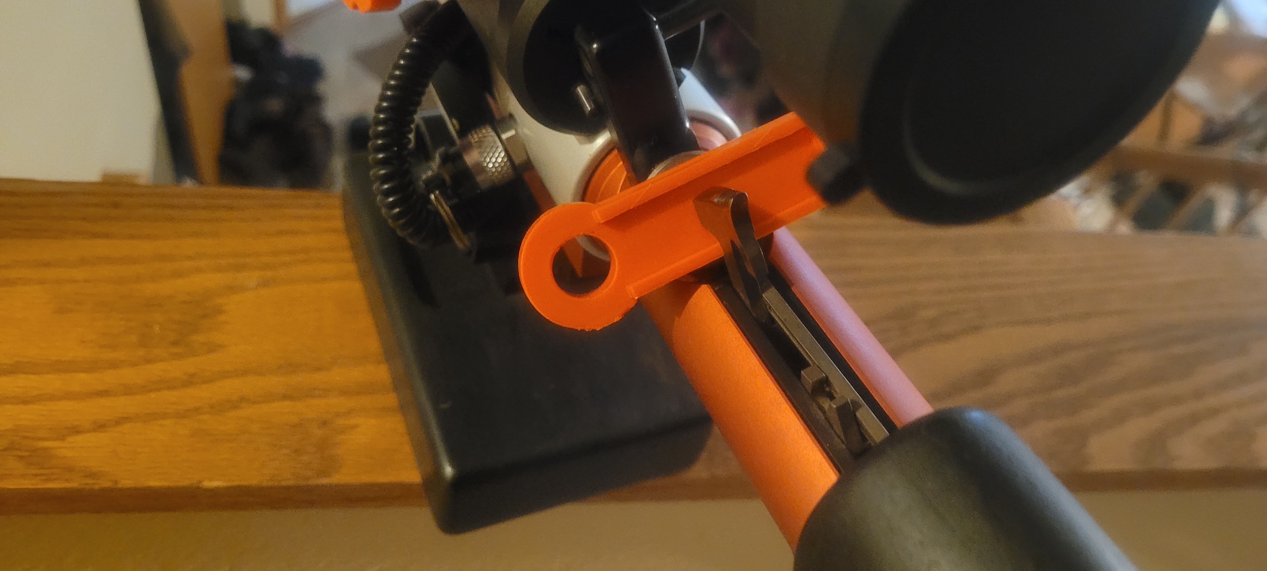

As for my offhand miss, I think I'm going to start utilizing the USFT feature LD pointed out a while back in this discussion: the ability to break the trigger without a full dry fire. Some time doing that in offhand position and I think I can cut out that offhand miss in future matches (without burning through a bunch more pellets when practicing).

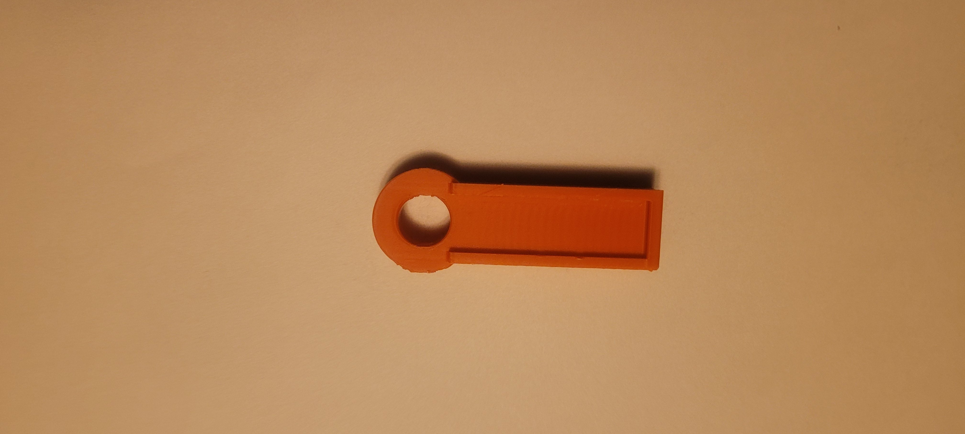

Hello Chris
just ran across your post for the USFT - usually look around and read your posts on Hard Air.
can you share your file for the trigger protector that you've designed
I have both a FT and Hunter version and while looking for a source for longer dog bones for the hamster I ran across your design.
thanks
Stephan

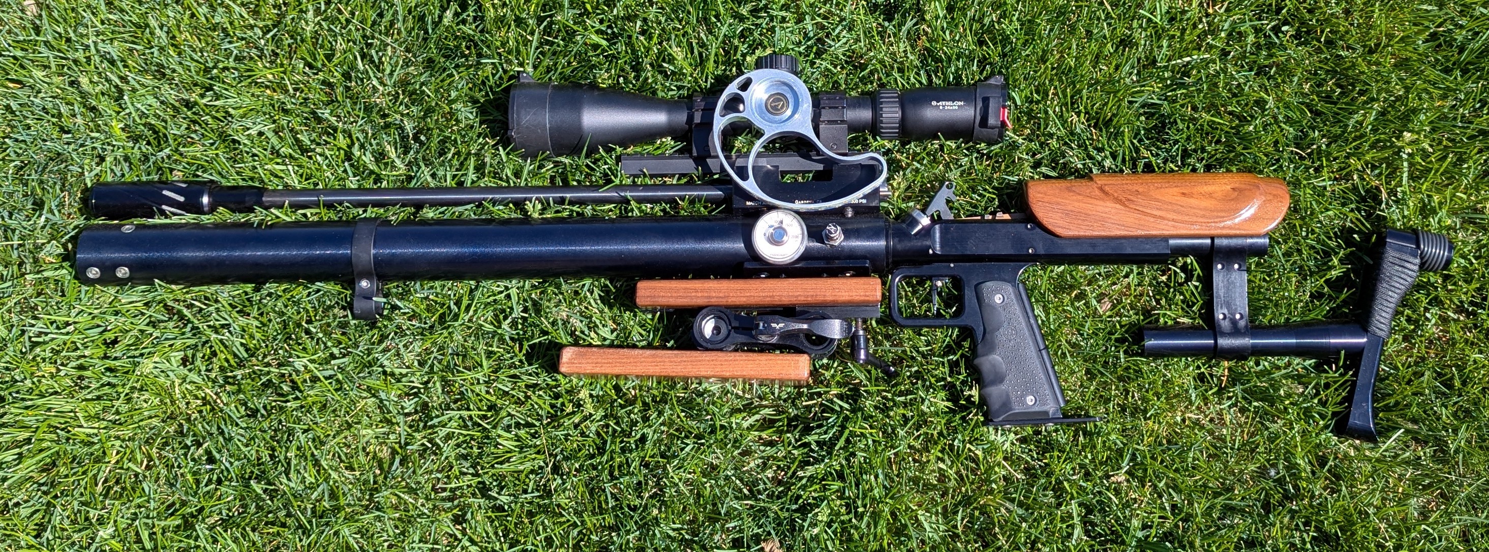

Anyone take their 22 call and make it a 177. Is there more than a barrel change required
Presume the hammer spring pressure and perhaps the air valve to be adjusted
I put a .20 barrel on mine, it was originally a .177. Only needed very slight tweaking of the hammer spring, and yes I did fiddle with the transfer port restriction, but probably didn't need to.
No probe and no oring inside the barrel greatly simplifies a caliber change, relative to more common airgun designs.
