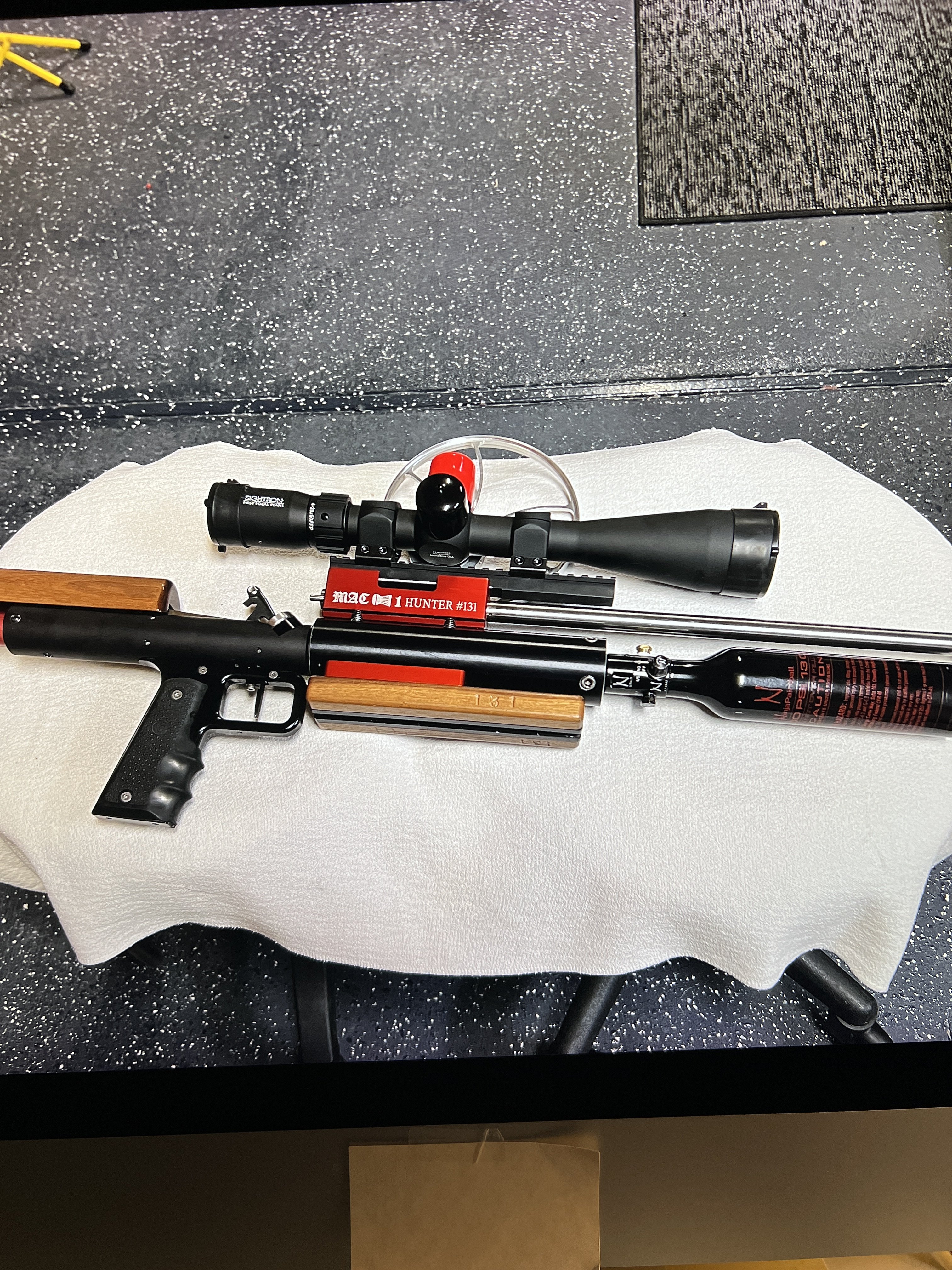

Today I did a little upgrade from the Donny FL & black mod. adapter up to a Rowan Engineering moderator adapter and a Neil Clague Titanium moderator. I figure that if I don't shoot all that well I should at least try to look good while I'm doin' it !
