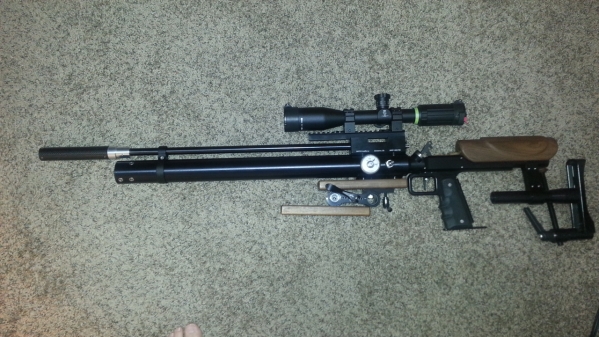

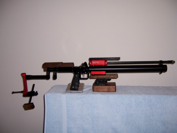

i have a cpl of USFT's and my son loves to shoot the one shown with regulated bottle and a poly barrel in benchrest
he even shot a 250 20X out doors with it in one of our matches, the other one is a low pressure long tube like yours
but is a 2 digit serial # :)

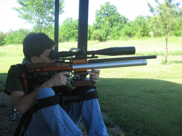

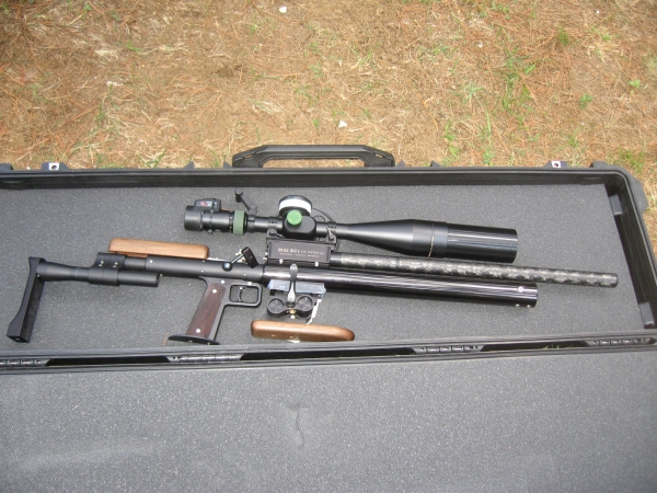

Just a couple of different USFT pics, all the low psi style as your leaning that way.
Every owner happy to let folks test drive what they have, and most did want to try my low dollar Chinese FT rig as I learned all about what they shot.

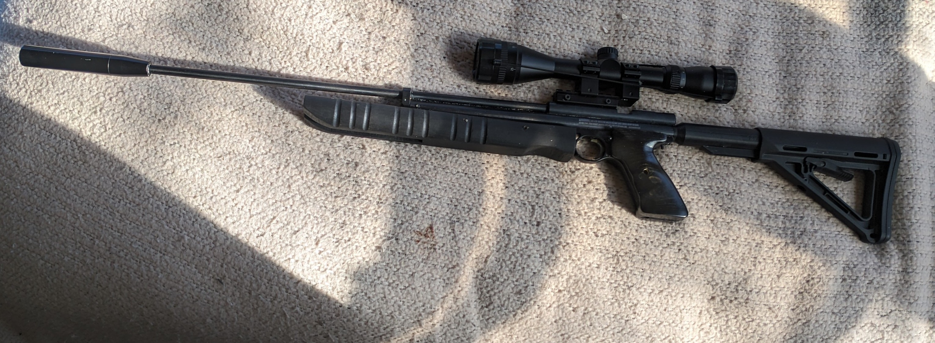

I sent Tim my Crosman Backpacker. Told him to do whatever he could to make it as powerful and accurate as possible, no matter what the price. Already had the Buck Rail stock adapter installed. Everything else was his doing. Almost %90 of the internals were reworked. A fatter set of pistols grips and a chunkier pump arm. It's slinging 14.3 gr Crosman Premiere HP's at 800+ fps and doing dime sized groups at 40 yards.
I'm not a competition shooter. I'm a hunter/pester. And I have to say, Tim is the best at what he does.
