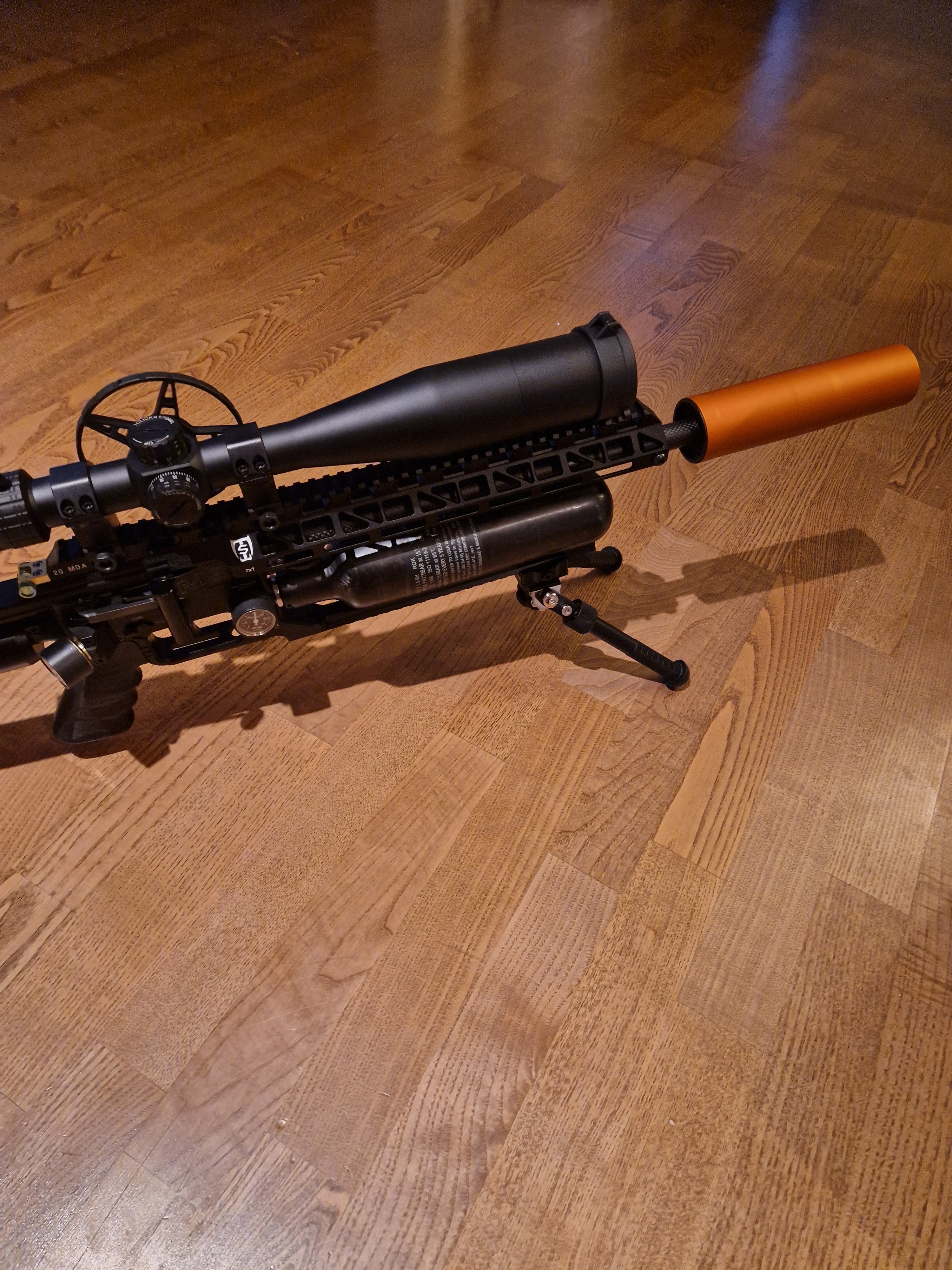

I took my m3 out to shoot a few shots Just to see if everything is ok and it seems not too, 3weeks since last time i shot it and now med 2nd reg has lost 20bar.
And now comes the question, it went down from 150 to 130 in 3 weeks, probably not a big leak, but my 1st reg still at 180, thats the thing i dont understand, if it leaks after 2nd reg shoudnt it Just keep filling up until 1st reg is down to 150 also?
So where do I start to look?

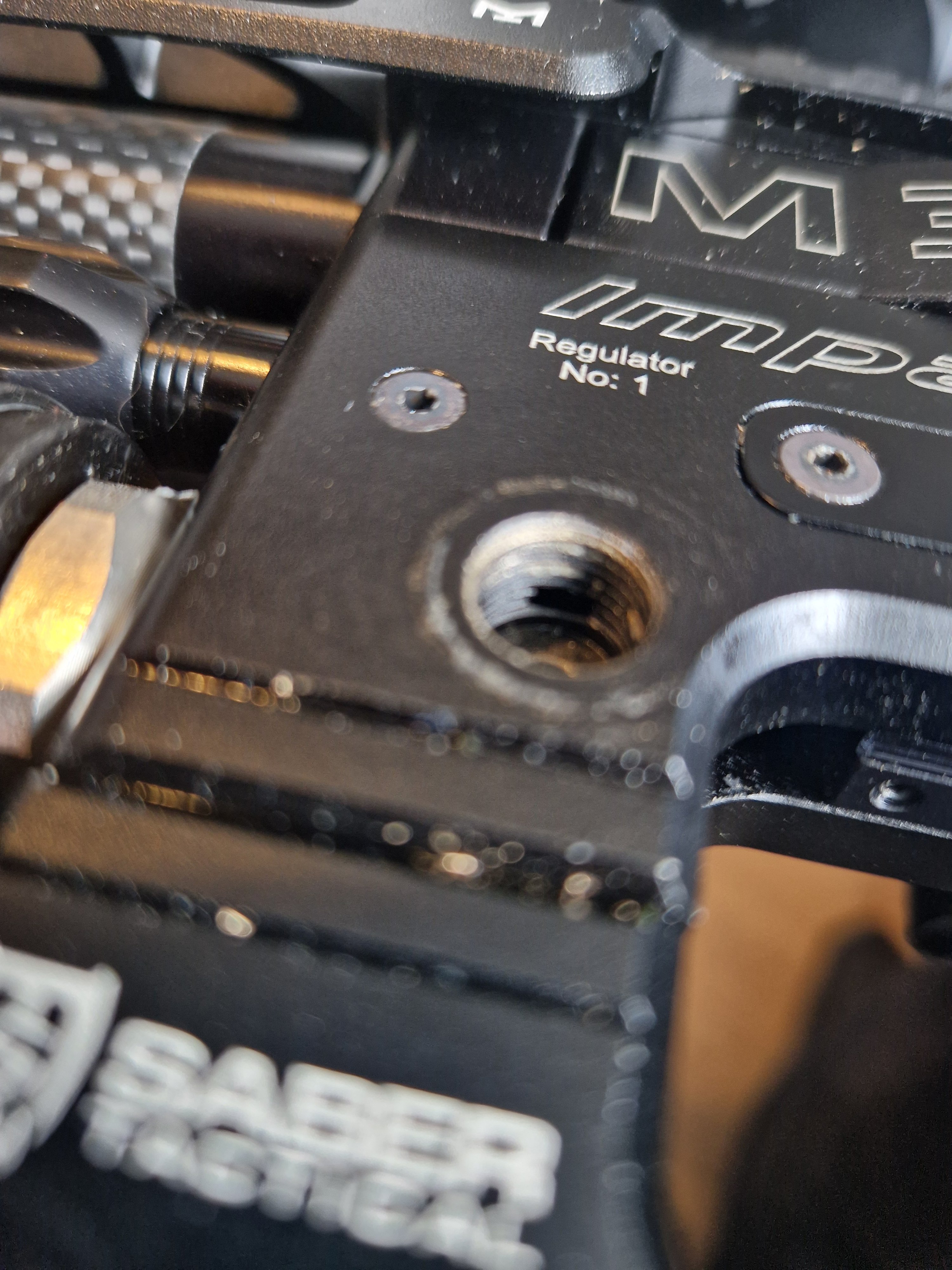

Well it was fine for a while and I suspect it was the 1st reg gauge. I took it out today after 2weeks and it was completely empty today, only bottle tho, plenum holds the air. So I took out the 1st reg gauge again and now I see i hole in the threads that goes up towards the valve Rod. Is that normal or is my Block broken? I tried to put oring under the gauge to press against the Block but cant even build up preassure with compressor cuz its leaking so bad.
