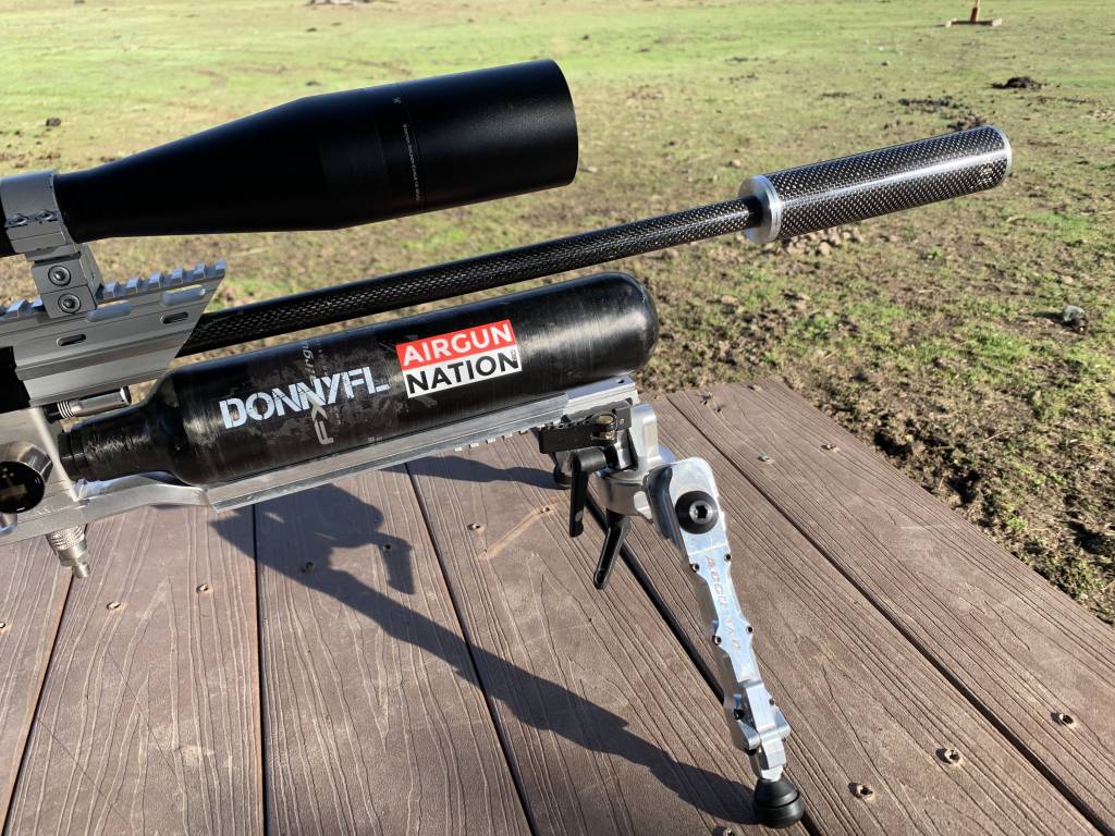

If you take the shroud off, it’s easier to use an external carbon fiber tube as a barrel stiffener or tensioner. To really get the benefits of a carbon fiber tube used this way, in place of the shroud, you also need one around the barrel itself. On my Impact,I have the barrel, a super tight fitting steel/carbon liner, the aluminum support and a carbon fiber liner over it. They are all super tightly fit together so they act as a single unit with no vibration. You can also just use the carbon fiber tube around the barrel and still use the shroud. I like to tinker and compare accuracy so I go back and forth and test them often. Without the shroud, it’s not quite as quiet though.

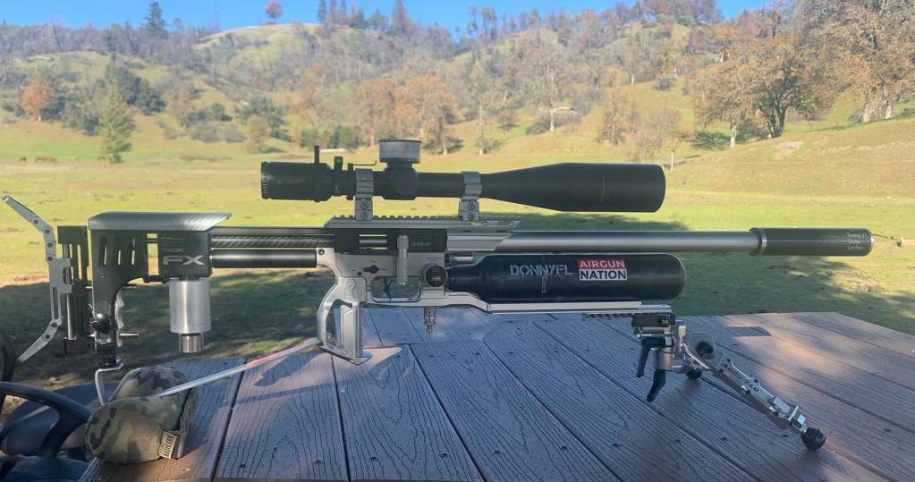

Here is my Impact with both variants.
