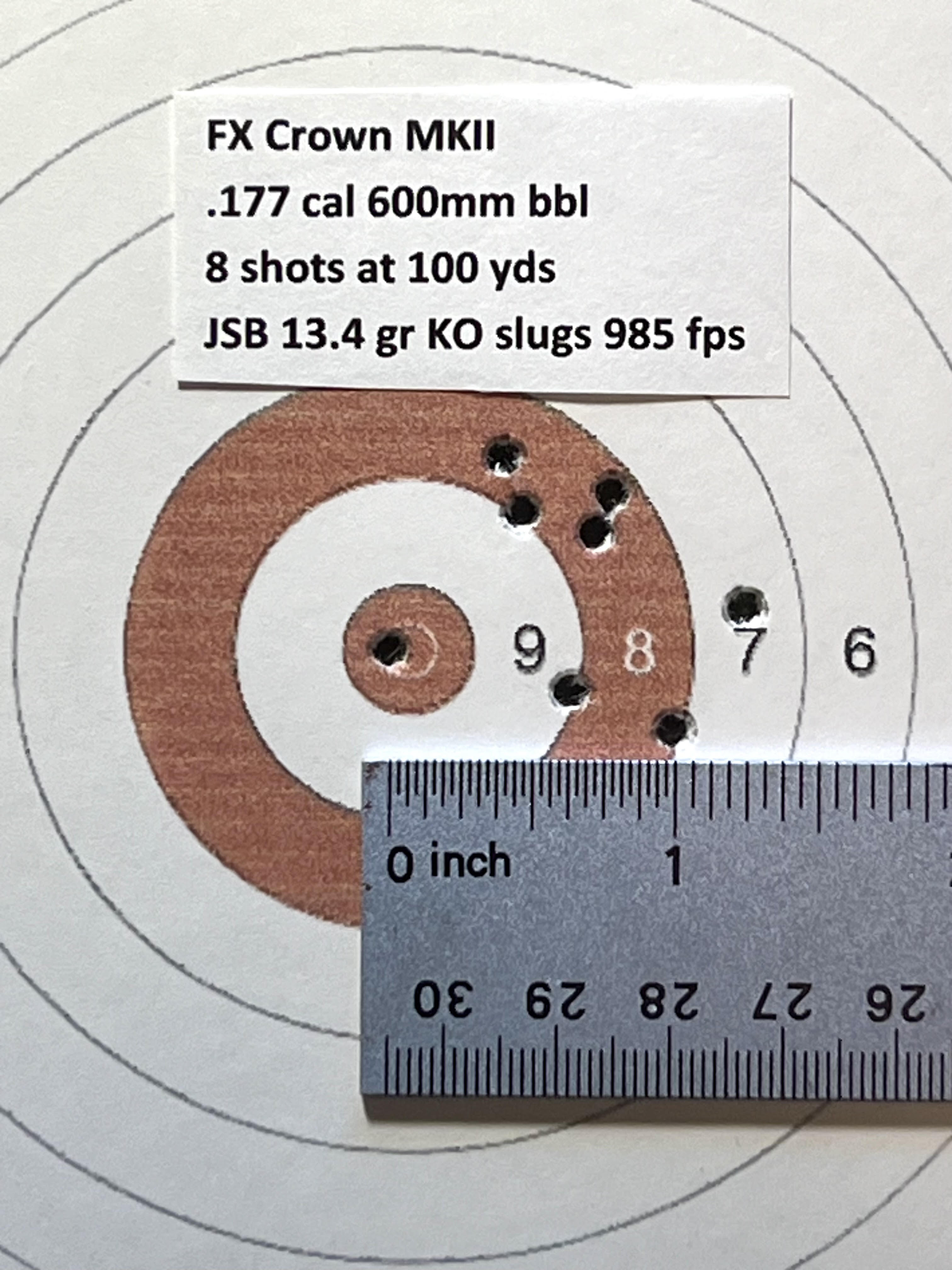

My Crown MKII with a .177 cal 600 mm standard STX barrel, Huma dual T/P and standard probe shoots JSP 13.4 KO at up to 1020 fps. I backed it down to 985. I've been getting some nice groups at 100 yards. I want to experiment with varying velocity to find the sweet spot.
It is interesting that people seem to have much better results in the 600 standard while the 500 seems hopeless in my experience at least.
