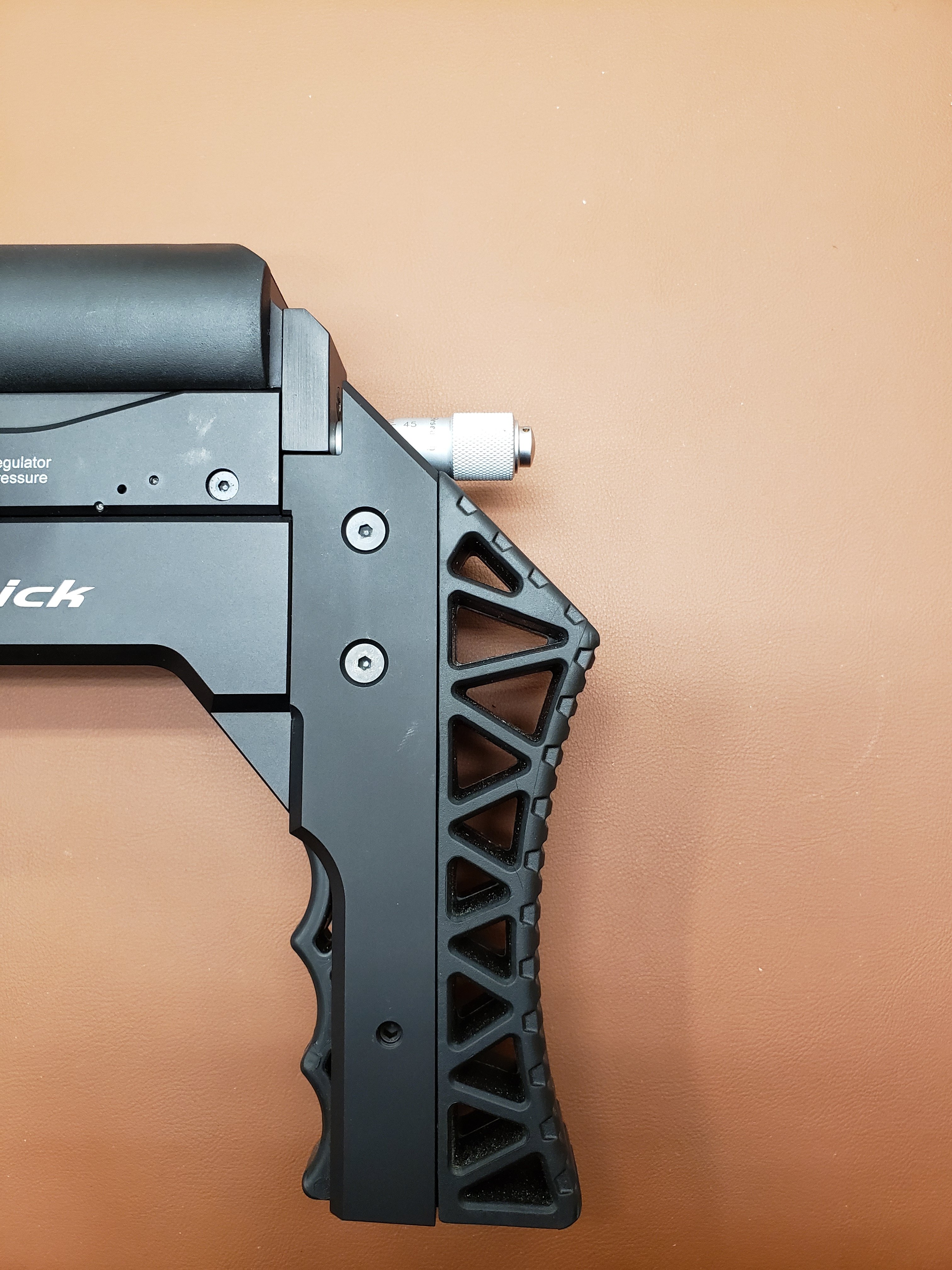

I have also just replaced the power wheel and small fine adjust screw, with a micrometer
