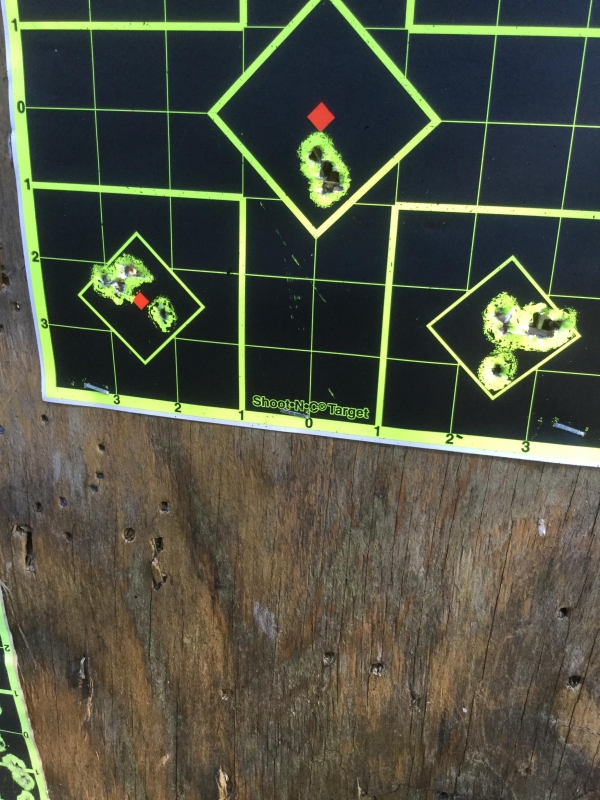

1538604378_16317818195bb53d5a46ead7.66369329_3844952C-C1E6-49C4-BC4B-9097C9C4E30D.jpeg
Left- CP 14.3
Middle - JSB Exact 18.1
Right- JSB 15.9
From 50 yards
5 Shot groups
