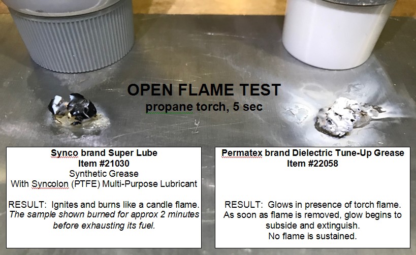

SuperLube synthetic grease is not a silicone-based lubricant and it is extremely flammable. It is good for metal on metal.

"SuperLube synthetic grease is not a silicone-based lubricant and it is extremely flammable. It is good for metal on metal."
I'm a little confused on this. It sounds like a lot of air gunners use it for o-ring lube unless I'm mis-understanding some the replies. I thought that's what it was for as well. Just want to make sure everyone is using the safe lubes. I use Danco silicone grease from HD for all my o-ring work and a couple of other lubes for metal-to-metal applications.
Well, Super Lube is an advertising term encompassing a range of different lubricants, some of which are silicone but the #21030 linked on Amazon is not.
Warning: if doing any of your own testing, do not breathe the fumes from anything containing PTFE as it is toxic.
