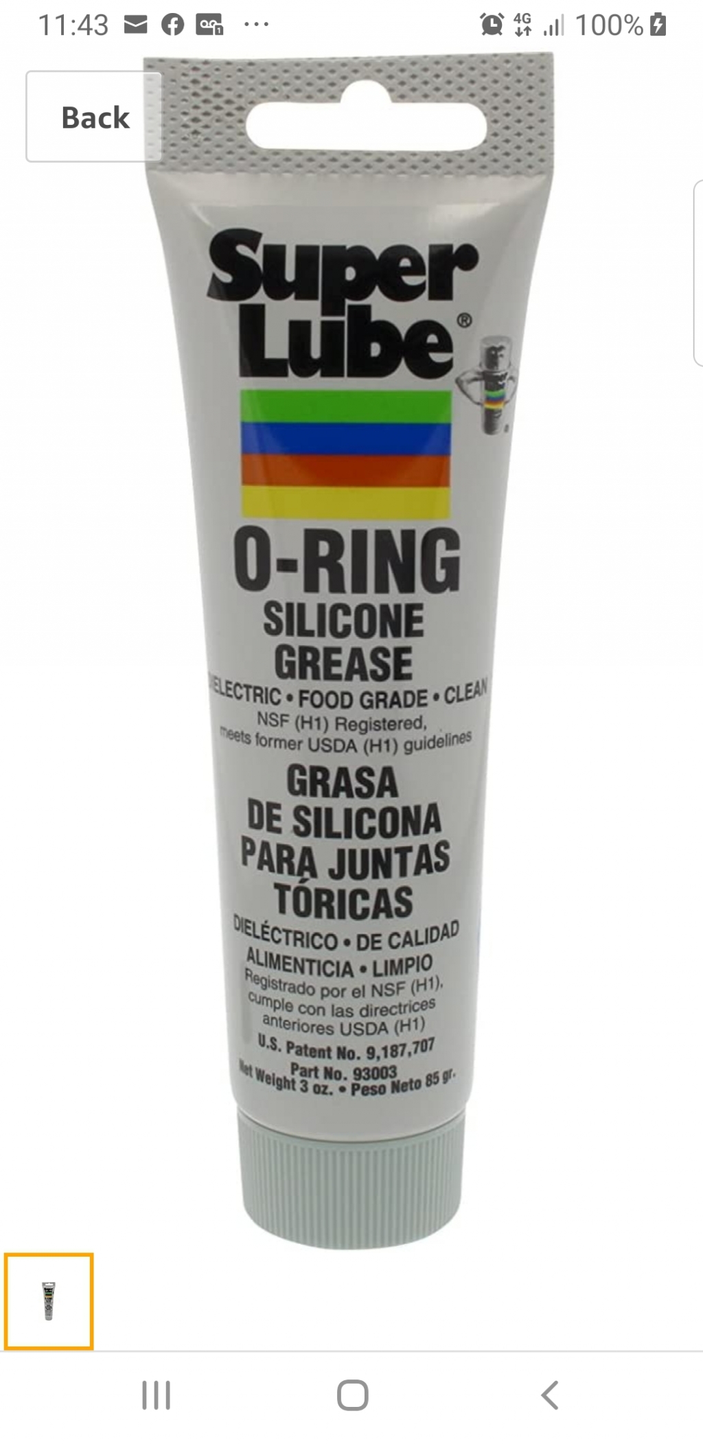

I've used diver's grease, Hill pump grease and recently just purchased some SuperLube silicone o-ring grease from Amazon but haven't tried it out yet.
My impression is that many of us use too much lubricant on O rings. Regarding lube in high pressure areas, silicone should not be used in any amount that could migrate to metal-on-metal threaded parts, as it can cause seizing. If you just touch your finger to silicone grease, and then massage an O ring, leaving it essentially dry, you probably have enough on it.
