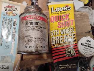

HW/Weihrauch Lube for the spring.
Copper anti seize /beeman lazer lube spring and seal .
5th wheel grease hing pin bolt and shims
The white grease a dab on the detant locking chisel.
Sillycone grease a light film on the breech seal .

Well I am learning. I already have the Ace grease did not know they were nation wide. I buy my gas seals there.
I realize I could go gas piston but I heard sad stories where they failed.
I personally was thinking about some motorcycle chain lube spray silicone grease I used it on my bike chains , and it sticks like hell in fact pretty hard to get off.

Ive use it sll i guess .. like you you read and learn and see what you find best for you .
I say in other threads on this i plan to try my own " moly " paste using. Nonmetallic neverseize snd super fine powder moly and mix small batch as needed like a 70/30 .
For example sake
So many to choose from
Then theres this stuff that looks interesting .
For me i just got tired of that " air gun". Pushed stuff at 25$ for .,05 oz ..lol
I used krytrox. As well .. that was making the guns some smooth dudes , but ... Seems i also had short spring life and seemed i had to go back and spruce it up after lots of shots . So it was good while it lasted but not going back to it .
Now not tried it yet , but i could yry that 5th wheel grease like spring tar is used if somthing was too noisy or harsh .. dont hurt my feelings none...lol

When I replace a spring I use a modest amount of what Vortex ships with the kit. No complaints. But my go to grease for everything else in life is Mobil One Bearing Grease. Why? It works and is good to -65.Anyone personally try it on their airgun spring?
If its in the kit why not use it .. i would no prob..
This guy uses copper anti seize as well in stuff he posts
https://anotherairgunblog.blogspot.com/2010/01/nos-weihrauch-35-e-gets-overhaul-part-4.html?m=1
Back when you had no Internet or forums and lucky to have a napa parts store in town you used what you could get. And guns shot and lasted just as good as today with this " air gun speciality stuff at 25$ for .05 oz". 😜
Best policy is read around and pick something you my like to try. Use it and see. You ether stick with it or try somthing else .. everyone got there ways and things . Just matter of personal preference.

Yeah I don't think I'll have to worry about -65 here in Tucson more like it's so frickin hot all the lube on my spring melted , and dripped out of rifle.Lol.

I don't think the krytox is affected buy heat and cold untill its extreme. Not normal local temperature anyway . Its viscosity remains the same 0° or 129° . If you need reading on it. In a springer. Nced at gateway to airgun posts alot on using it . The cost benefit just was not there for me . You know im not a " upscale " type shooter anyways.. lol
