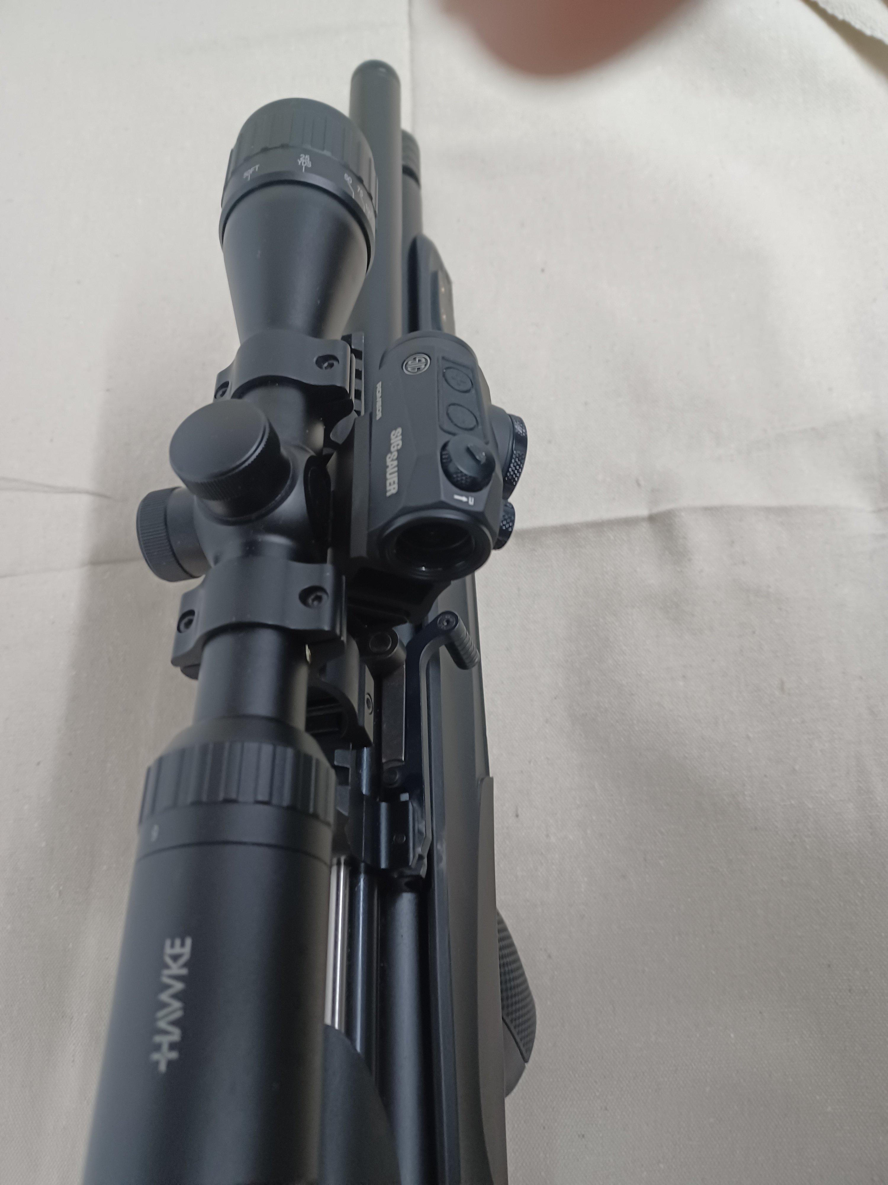

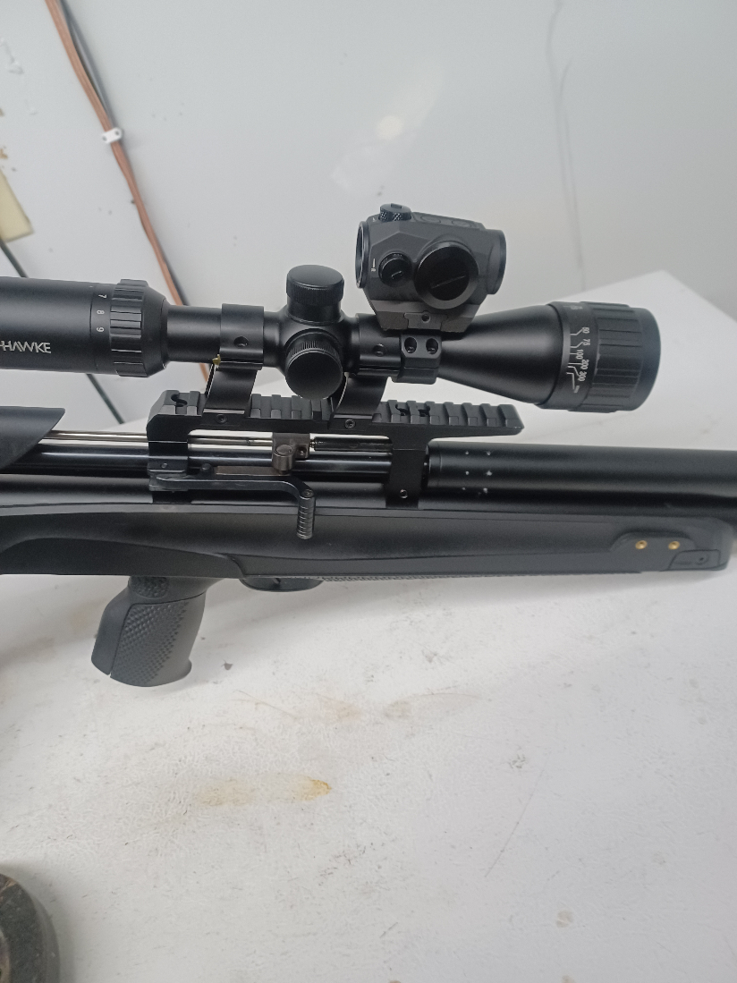

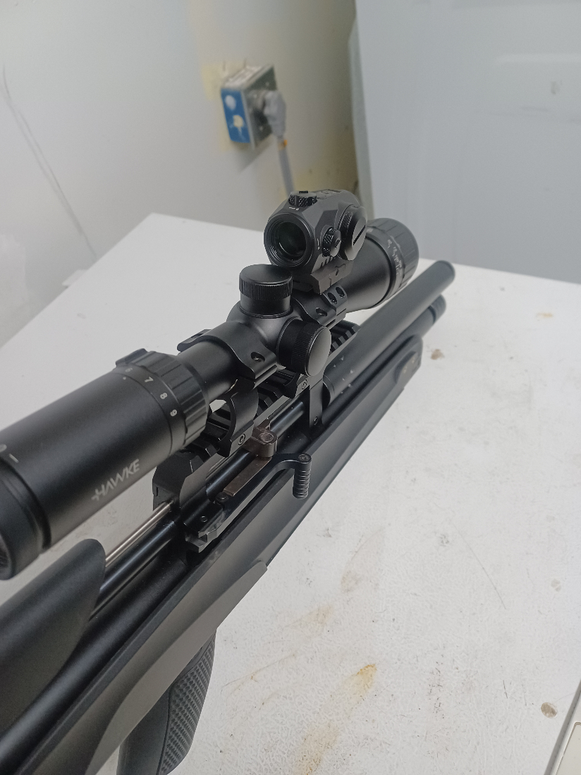

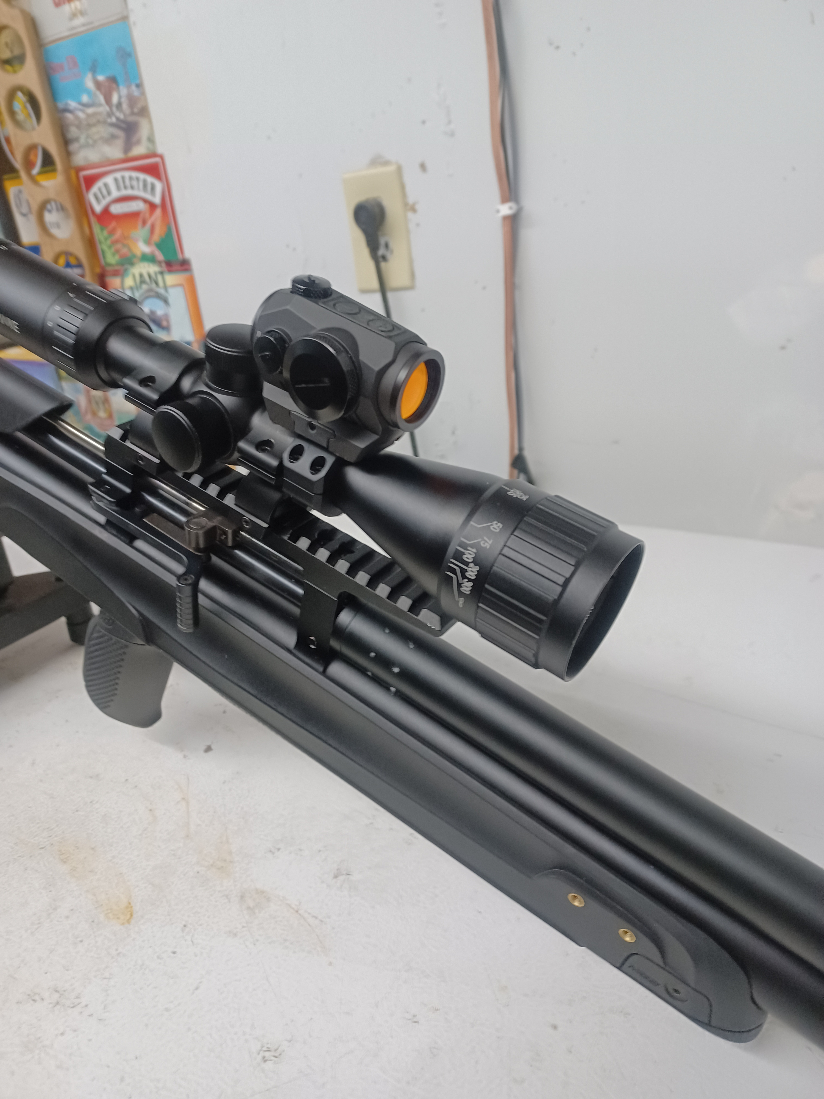

Have you thought about buying a standard scope with good eye relief and parallax adjustment and just slapping a Burris fast fire micro red dot on it for true parallax free close range and ideal long range? Not many lpvo scopes with adjustable parallax out there. You might find a good 2x7 with all the things you want. I don't think you can find a 1x with all those requirements. If you do please let us know I would love to have one!
A scope plus red dot or RMR is definitely something to consider.
There are mounts that allow you to have your RMR or RDS mounted closer to the bore and just rotate the stock slightly. Some prefer this to top mounted for close distance stuff.

Even with LPVOs many shooters still use the offset RMR due to their better performance at 1x.
I first had it mounted with side mount where I had to tilt the gun toward me but now I prefer this setup.
