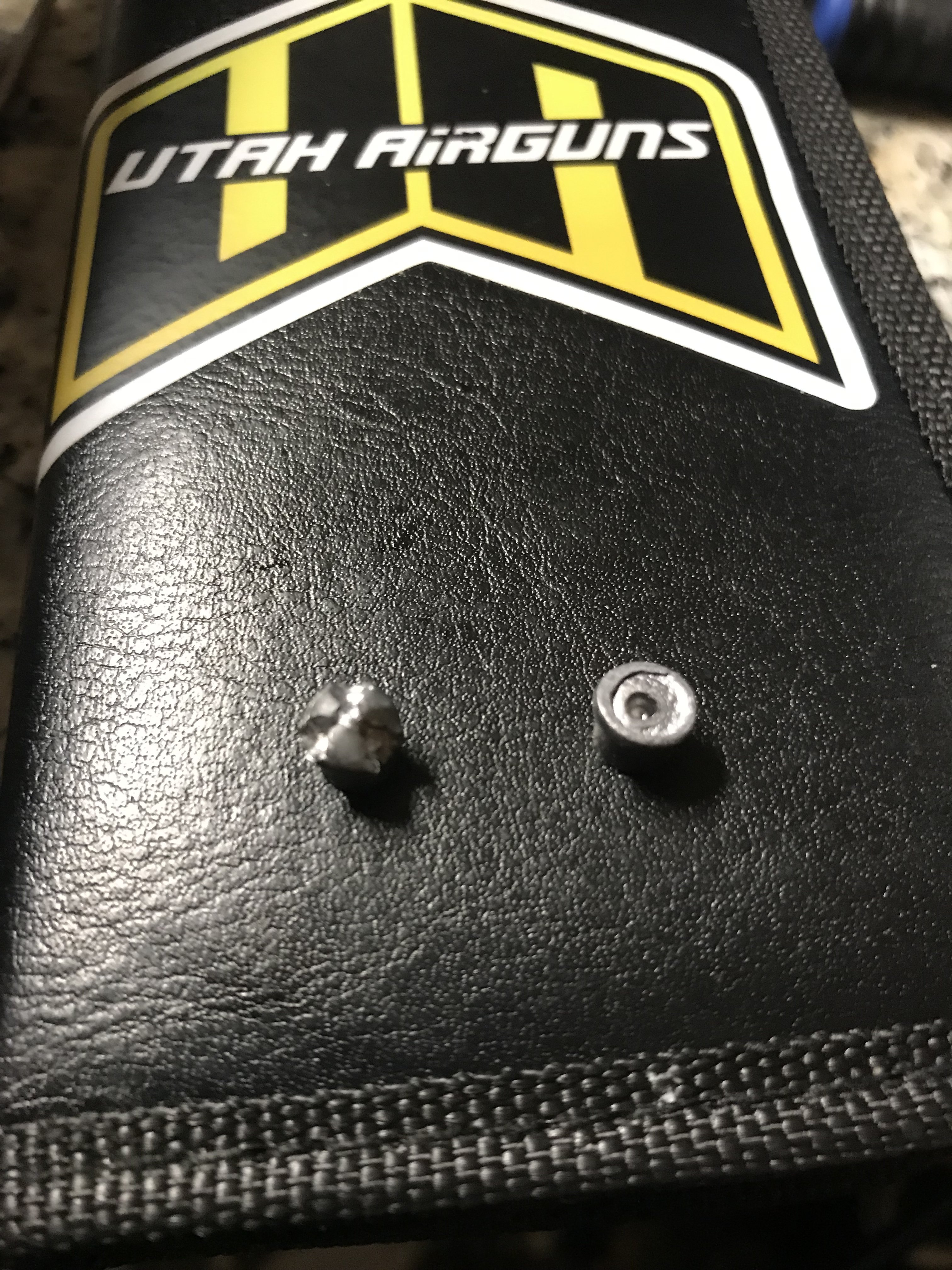

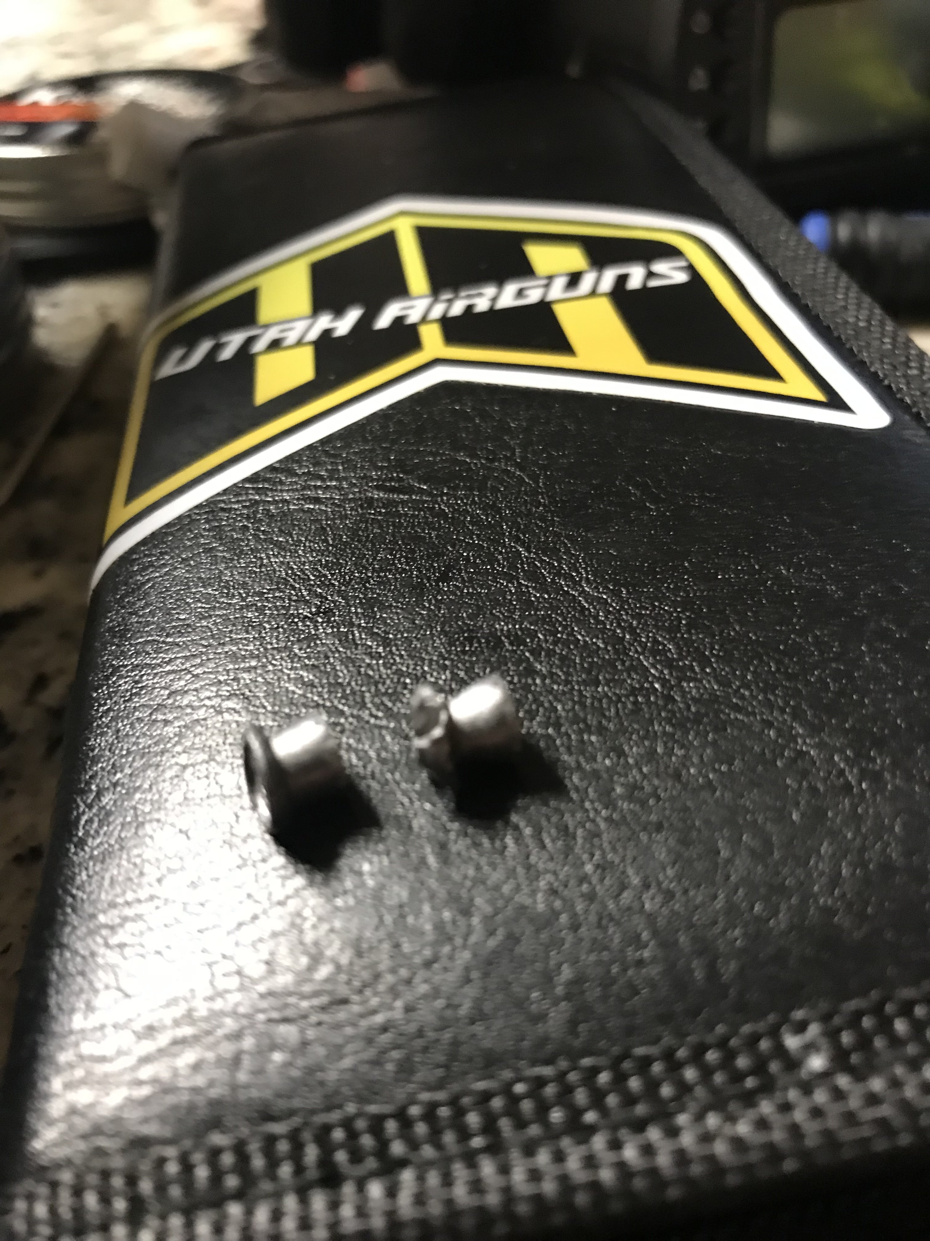

First two pellets tested. Shooting .22 15.89
Predator poly mag shorts and 15.89 hades at 664.4 and 666.1 fps
The polymags really opened up. Was shot into nothing but a 2” thick puck of shortening/beeswax. Got both into their liquid form, mixed and poured into a Crème Brûlée dish. Now, the kicker:
The hades I shot into just the crème de fat and bee hurl puck looks almost unshot, if it weren’t for the rifling cuts and the slightly engorged skirt. Had to place the puck on top of a large Utz pretzel stick tub filled with water to get those trocars to open. The predator didn’t require this treatment. Was backed by the late Paul Harrell’s patented “high-tech fleece bullet stop” and was stopped by the first layer.
