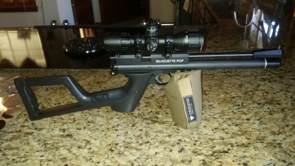

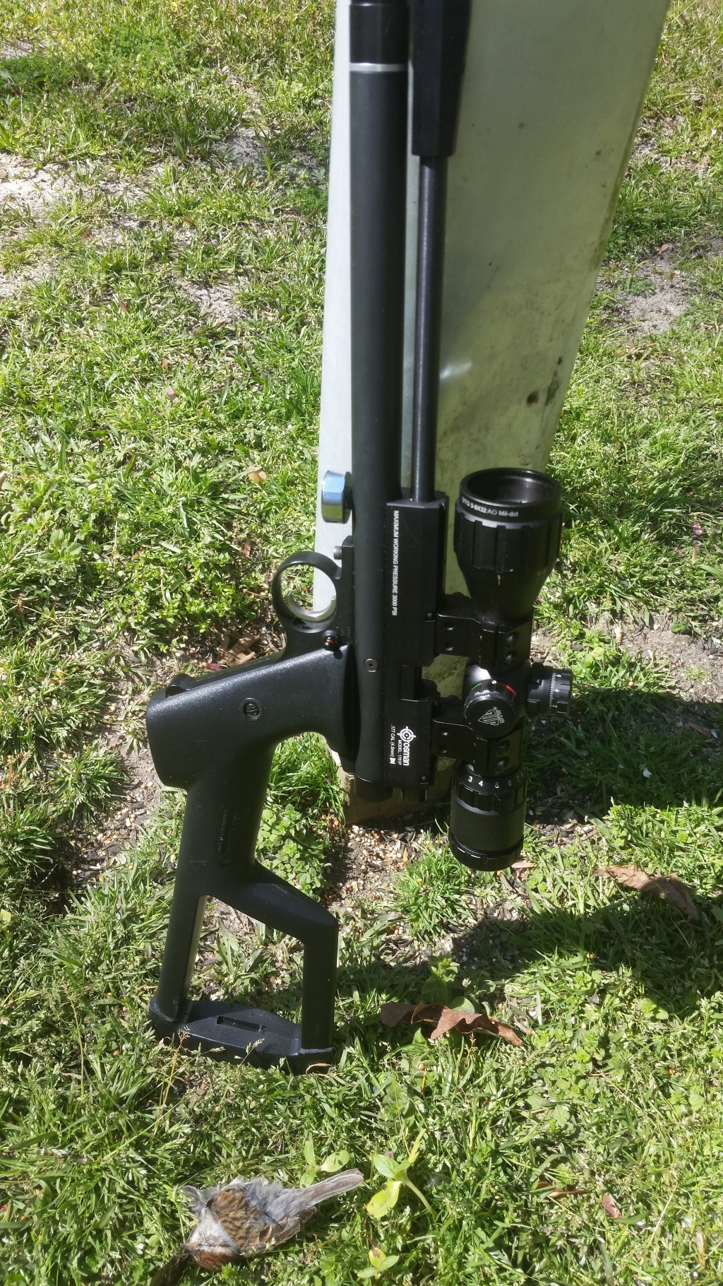

This sparrow special would work. Crosman 1701p with 1720 tp (.067), bstaley mod, tweek adjustments . jsb 8.4 @ 690 for 30 shots. Will stack em @ 35 yds calm wind. 8.5 fpe. Can go +/- on power. Sparrow @ 35 yds.chopped crosman 1399 stock.

I will say that I have a 1701P, the Crosman Silhouette as well. I get 60 or so shots from a fill, but it only puts out 6 foot pounds the way I have it tuned. Plenty to take small stuff like rats, mice, birds. and yes, it stacks pellets with the factory tune. Range is limited, maybe 20 yards, but that is plenty for a gun designed for 10 meters.
Be aware if you buy a 1701P, you'll need rear sights that add to the cost.
