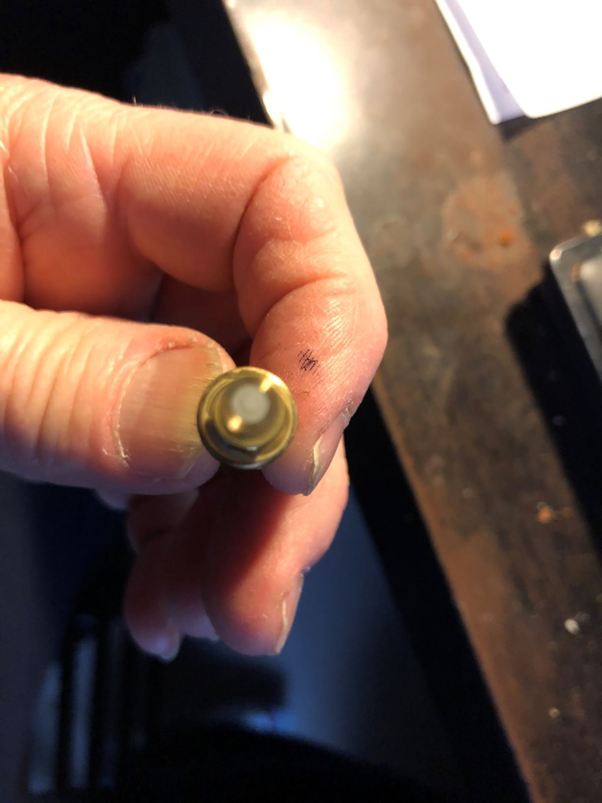

My two RAW's took 1 shot for the regulator to recover after sitting overnight. Changed the regulator's seat to peek and now every shot consistent no matter how long they sit.View attachment 271939

Very first time - about a year ago - I did some machining on the Rear Block also Valve House and Peek puppet.
Ones there I did polish the tungsten Valve Rod to mirror finish. If you have a closer look the rod is not grind but coming from a lathe.
The original PUR90 is still there since I got the Impact in Feb.2020 and over 16K shots on the .25 Impact (I stop counting).
I don't have the phenomena you describing but I am playing my game with a powercurve between 100-120 Joules (74-93 FPE).
Did some tests on the old valve rod, after I polished it mirror finish, the old pur90 ring does not stick but the brand new one does. Maybe it needs to be used for a while to break in? Talked to fx about it and they said I had regcreep, but I said that the o-ring stuck to the valve stem, they advised to polish it and oil it. Would then make sure I did not have regcreep.They did not recommend a nbr90 o-ring, told them that it works without problems with that o-ring but not with a pur90. Im gonna leave the gun as it for no and see how long it works.
Yes it was tested it still sticks you can adjust the hammer just a tad to help over come it on first shot which seems to be the worst unless your shooting 100 yards or more a 20 fps you won't really notice a unregulated gun tune within 20 fps curve is actually pretty good tune I dry fire my first shot before I go out hunting on my mk2 impact I'm waiting for the larger plenum 720 for my mk2 to show up and am doing a peek washer with a viton o-ring
