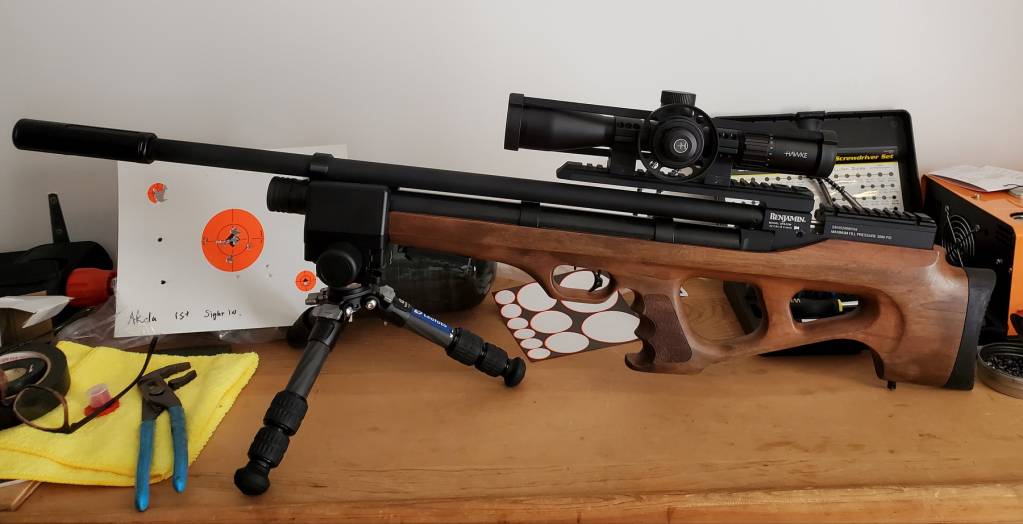

Back to the Akela, I had a Cabellas Covenant 4 set aside for the Akela, but low and behold, here I am with the short spacing between the "cheek piece" (really it doesn't have one) and the rail, I am having to do the exact opposite I did with the R9 and Hawke, ie: pushing it so far forward it's ludicrous! Plus the scope just seemed HUGE on the little Akela.

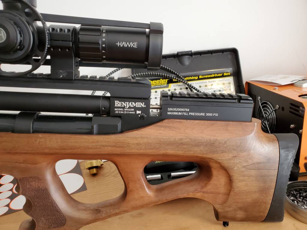

Well I gave up and grabbed the Hawke off the R9, and this has proven to be an EXCELLENT combo. The 1" eye relief works perfectly, and I get a pretty serious magnification on the Akela while keeping a compact sized scope. It's working very well.
You can see just how close the scopes occular is mounted to where one's eye would be, and yet even with this short eye relief the mounts are quite forward on the rail, and the scope itself within the mounts is as far forward as it will go. (With the Covenant 4, the scope was so far forward it was just silly and ungainly.)

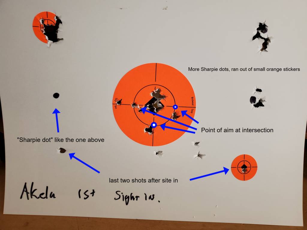

Sighting in took a few shots before I was just making big one hole bigger. As always, it seems these Benjy rifles really like the Crosman Premier domes In the upper left minitarget you can see the eventual drop in point of aim. This was the 3rd and 4th magazine. After 4 magazines she still has 2,000 psi almost exactly on the manometer. So 1,000psi got me 48 shots! Not bad
