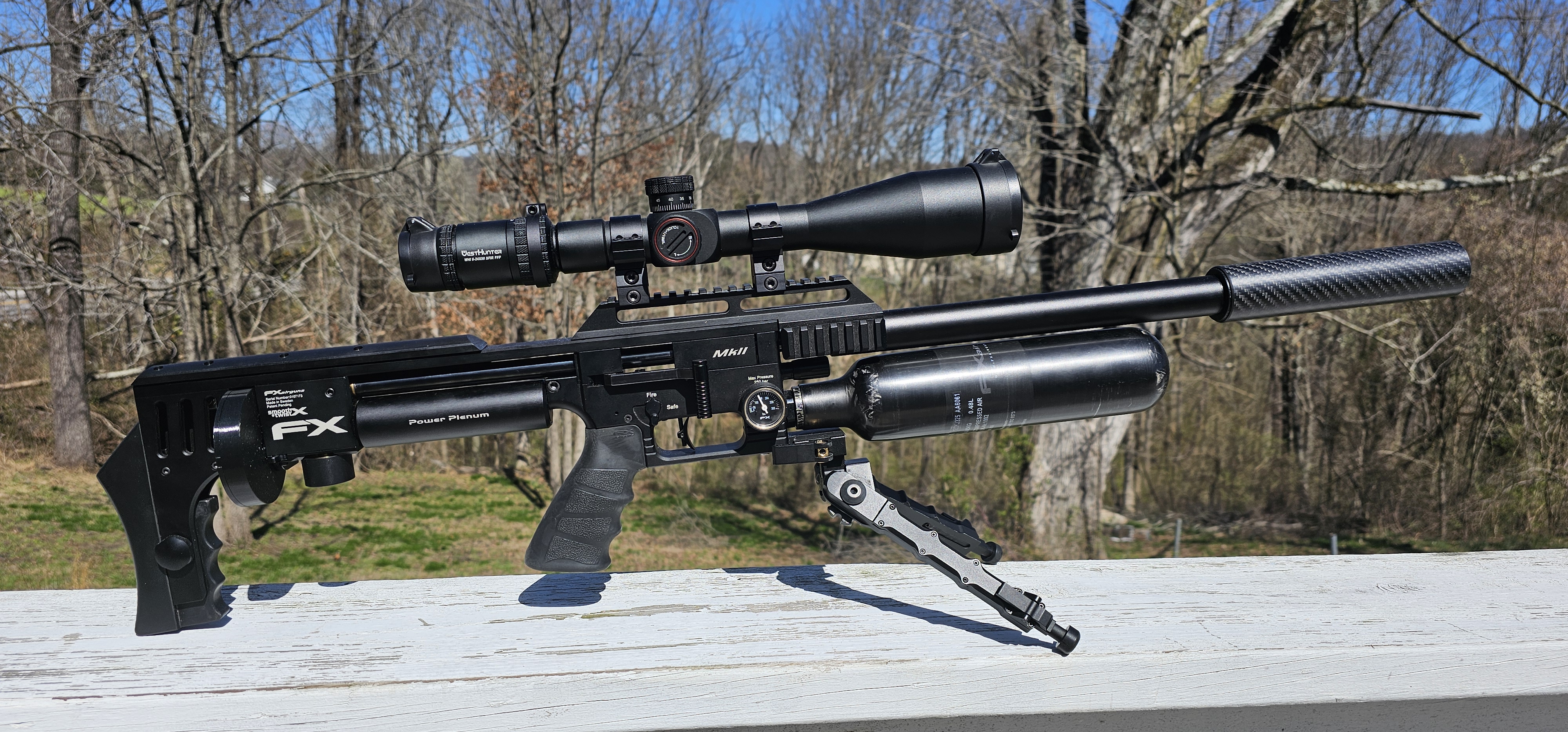

FX Love my M3
The day FX announced the M3 I pre ordered it.
I have never been disappointed with it !
I have added the power block and tungsten hammer weight and a few bolt on accessories to make it a long range prairie dog shooting rifle.
End of the day, the main thing is that if you are happy with your gun, it's the best thing. 👌

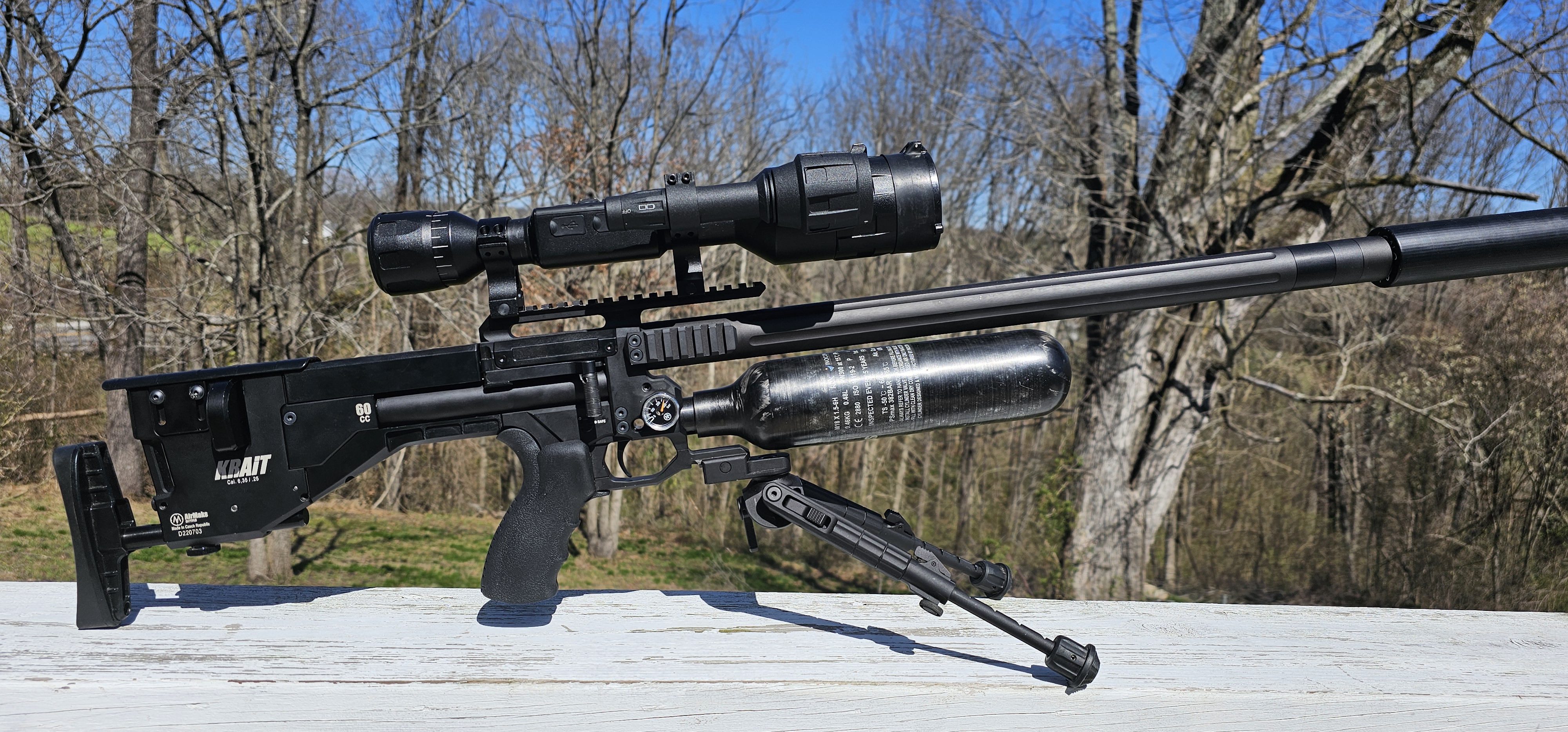

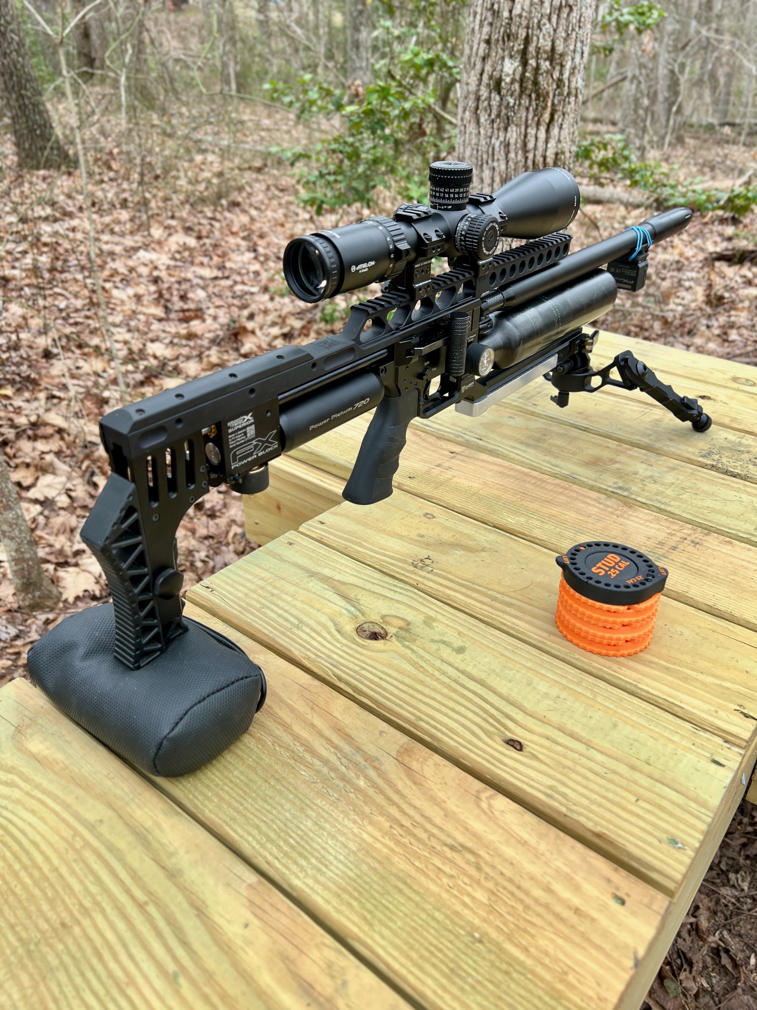

The question I have, if the three guns pictured above were so good why have they all been fitted with aftermarket stiffening rails, barrel stiffeners and shroud supports? That’s not “tuning” they were fitted correct a flaw in the design.

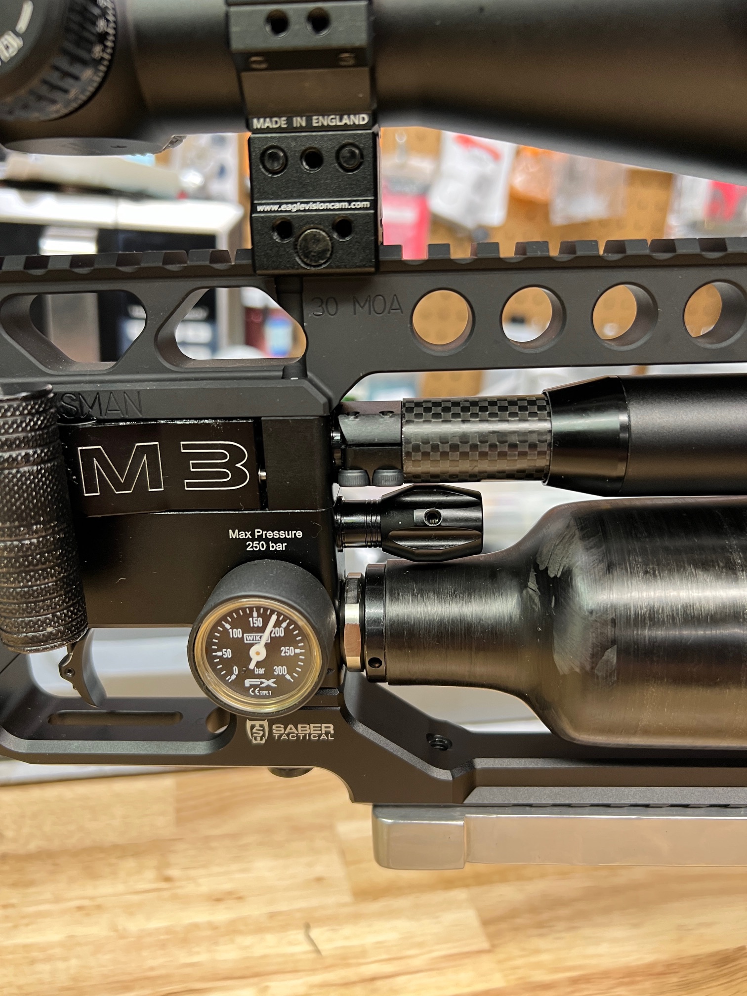

I did delete the first reg. as I was having a problem with the POI shift when I first got mine. I used the delete fitting from Saber Tactical, I think it was like 35.00, the first reg. is inside the fitting that the bottle screws on to, I just removed that fitting and installed the one from Saber Tactical. I also bought the carbon fiber stiffening sleeve for the liner that fits over the liner and then fits inside the liner housing, I JB welded it to the liner and then re-installed it into the barrel housing. I then installed the carbon fiber barrel tensioner that goes over the barrel housing. I removed the rear cone from the barrel shroud, and I machined the cone on one of my lathes to fit over the carbon fiber tensioner sleeve so I could still use the factory shroud. After doing that I started from step one re-tuning the rifle....I set the second reg. to 90 bar and started working up to get the 33.95 pellets shooting around 900fps....I ended up with the second reg. set at 115 bar and the rifle was shooting full mag groups the size of a nickel at 50 yards. I actually did a sort of experiment over a several week period just to confirm that I was not having any more POI shift on the first shot. I would let the rifle sit for a week at a time and then take it on my backyard range and shoot a clip full, over several weeks of doing this...every time the first shot was dead center in the bull and I have never had any more POI problems....I also have never changed any of the settings on it since. I had read about the stiction problems some were having but I have not had any more problems with mine. I think that deleting that first reg. and stiffening the barrel and using a modest 115 bar on the second reg. to get the 900 fps solved my POI problems. In my opinion I think too many people are hung up trying to get the most power and fps that they can from these rifles and that may be causing a lot of the problems.... I've got some pics of the barrel shroud etc. that I did somewhere, if I can find them I'll post them on here. Here's the only pic I could find of that cone on the shroud, I had to heat it up with a heat gun to remove it from the shroud.
I will order one from saber tactical. The M3 is sweet looking. I will be in touch when everything is said and done with. Thank you DBlue.
