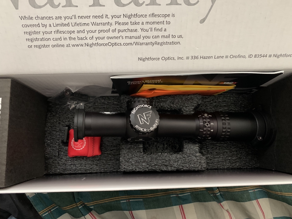

RE: scopes - I got the ATACR 1-8 earlier this morning. Parallax does NOT seem to be an issue! I'll play around with it more later today, but I was even able to magnify objects as close as 10 meters away with zero blurriness.
Pretty stoked - this will be an awesome upgrade to my 1-6 for hunting 😎

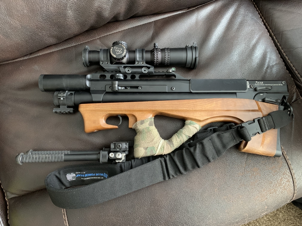

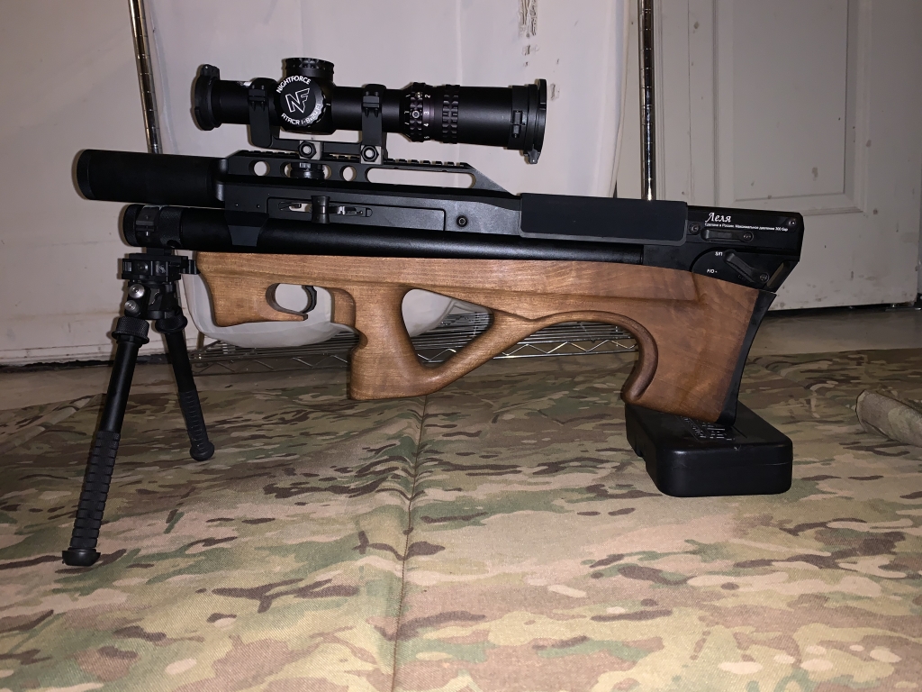

Finally got my mounting ring delivered today for the bipod attachment. Hit it a little on the bench grinder and got it to fit under the shroud with plenty of room to spare. Wrapped the tube with some adhesive-backed nylon, and it's on there nice and snug. I'm swapping the Pic rail out for a magnetic mount to run a Javelin bipod soon. Very happy with it.
@Peskadot671 - that Razor is well regarded for sure. I originally planned to run that NXS, but I wanted the bigger tube and ED glass to give me the best low-light performance for the dark mountain / forest conditions here in the PNW during hunting season. My eyesight can't work with certain scopes in these conditions very well. I think the extra 4oz with the ATACR will be worth it for me. You can get them new shipped from authorized dealers for less than MSRP btw. If you're in the market, don't let any haters steer you away from one - this is one bad ass optic.

This scope - I love it. The 8x feels like much more than 8. I thought the center circle might get in the way, but it doesn't and helps for calculated holdovers extremely well. The glass is perfect and I have no issues seeing in dim / dark conditions like I had with some 30mm scopes.

It always confused me why folks would buy a compact like the Lelya or Leshiy, only to throw some monstrous heavy scope on it... I find the 6x Dedal to really be a perfect match for any of these Edguns.. and it holds a zero perfectly when taken on or off. I dunno how I lived with a non lit reticle before.

For this Lelya build, I needed a bit more magnification (and FOV) capabilities than the Dedal for hunting grouse / turkey / small game in low-light. The scope on that Scalarworks mount is 26oz and change in all .. I could have saved ~4oz with lesser optics, but it is balanced perfectly as is and I wouldn't change it for anything else. The only tricky part of this setup is this Pard NV007 that I got recently. I can get the adapter to mount to the eyepiece, but the eyepiece rotates on the ATACRs with magnification, which sucks for NV units that attach to them there 👎 Oh well, life is a series if tradeoffs!
