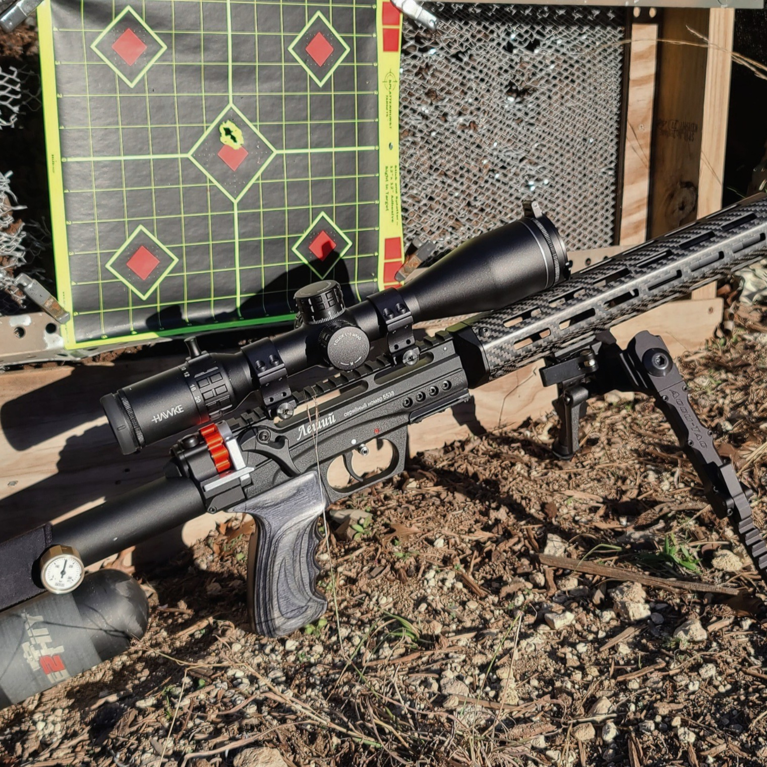

My new 350mm .22 Alpha Precision barrel is shooting pellets really good so far. 8 on 8 @50y

I am going to recommend you get the .22 Alpha barrel. I have one in 250mm and one in 600mm. Both are super accurate barrels with pellets and slugs. They are good with JSB and Crossman pellets and with the 600mm I am shooting Apex Airgun Ammo 36gr boat tail in .219 - 0.5" @ 50 yards @ 900 fps. Also shoots the 25gr JSB RDW amazingly anywhere from 900 - 1000+ fps.
