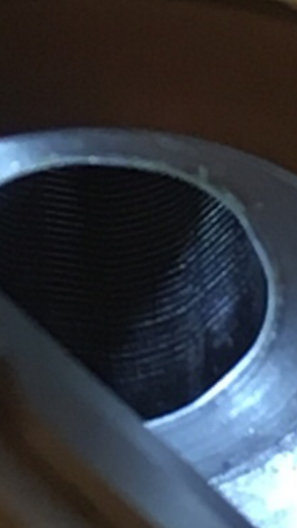

When I got home I pulled the barrel, gave it a good clean and tried to figure out what was going on. After some time of trying to get a decent look down with a phone flashlight I managed to snap this picture: https://imgur.com/wwqwMol
The breech end has similar marks just much more subtle so I can't take a decent picture.
Do you guys think this is normal? Do these barrel blanks have to be lapped beforehand?

It can be hard to tell much from pictures however the chatter marks (?) yours shows do look a bit extreme.

I’m on mobile so I don’t know how well it can be seen but here is a closeup of what I’m trying to show. There are these thread like marks inside. This is the best I could see and I don’t know if they go all the way through. Later tonight I’ll try to get a better picture and lighting.
The barrel is choked and has the crown on the correct side.
Photo is clear enough :)
Definitely not normal, and this is the first time I see a LW blank with a bore like this. (And I have seen/machined a lot of them)
They should have a mirror like finish, I once have sawn a leftover piece of barrel in half, and it looks like a miror polished finish. No scratches or tool marks visible.
If I were you, I'd contact the seller of the blank about what to do with it, or ask for a replacement blank. It seems like LW is hard to contact, that's why you'd better contact the seller of the blank.

Thank you for the information. I remember when I was choosing my first PCP and looking to buy a HW100 I saw some pictures of a barrel with much more subtle scratches in the same area and people were saying its a defect.
I posted this to see if this is something that I was expected to deal with when fitting a blank or if this is something out of the ordinary.
I sent an e-mail to the vendor. I'll keep you guys posted.
