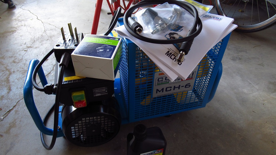

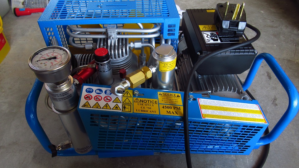

I had ordered my Coltri MCH6 from Nuvair in Oxnard, California on Tuesday (07/07/2020) and it arrived this morning (07/10/2020).

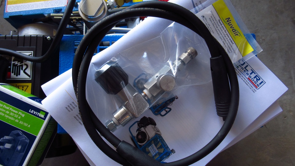

Delivered by Fed-Ex. Well packed. I opened the box and everything looked good so I signed off for it. Nice manuals, airgun fill hose/valve, extra quart of Coltri CE750 oil. It's heavy but manageable for one person. I carried it into the garage by myself.

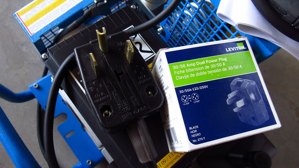

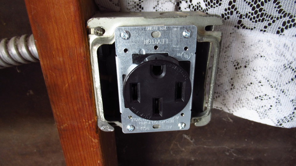

I had ordered the paintball/airgun configuration so it came with the correct fill valve/foster fitting and 330bar safety valve. It has a 60hz single phase 220v motor, but does not come with a plug. I have a 50amp, 4 wire outlet box in the garage, so I bought a configurable NEMA 14-30P/14-50P plug at the local Ace hardware store. The only difference between the 14-30P and 14-50P configuration is which neutral pin is installed. Since the Coltri compressor has a 3 wire cable, I did not install the unused neutral pin. The plug housing is designed for a fairly large diameter cable, so I slipped a rubber spark plug boot over the Coltri cable to make a tighter fit in the plug housing.

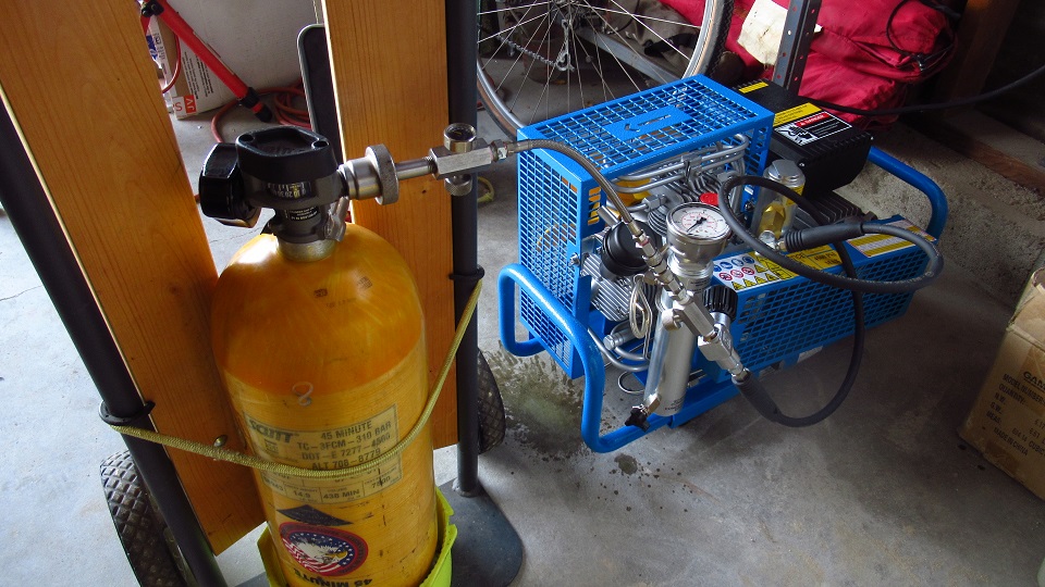

Nuvair tests the compressor, so it ships with correct oil already filled to the correct level. I read through the manual and then went to the QUICK GUIDE page for the initial startup. I filled my 45 min SCBA tank from 3200psi to 4500psi in 6 minutes. It's early, but I'm very pleased so far with the compressor, and Nuvair has been great to deal with. All the concerns that people raised in this thread about ordering from Spain were not an issue when ordering from Nuvair. You'll pay a little less from the Spanish supplier, but Nuvair provides great service and a properly configured compressor setup.
