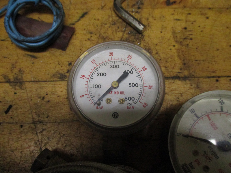

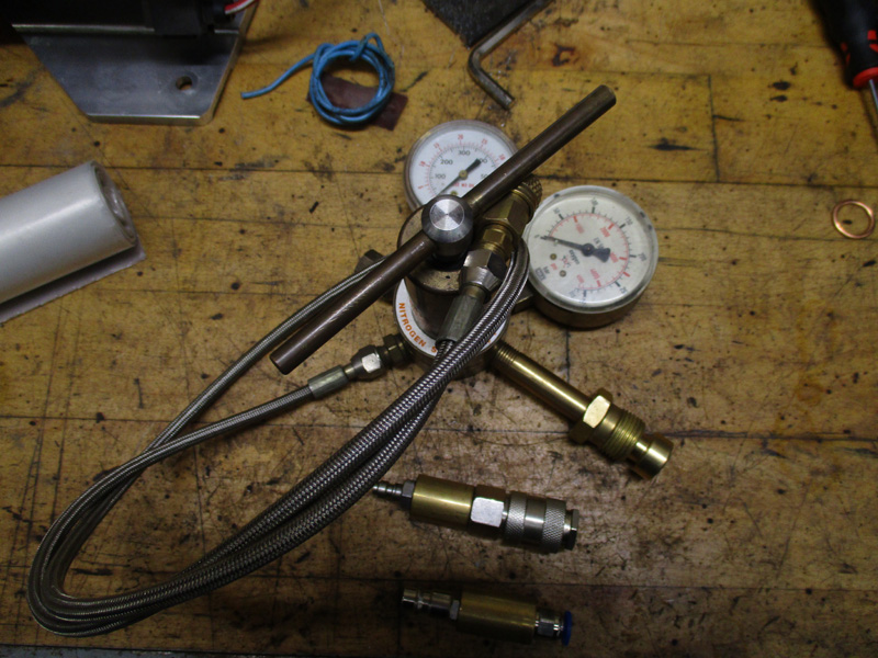

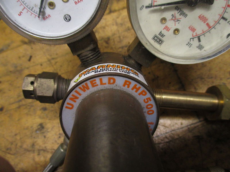

I repurposed an old Argon/Nitrogen regulator and put on a fitting for SCUBA DIN300
We use it in the shop mainly to fill up Porsche air suspension systems, needs 17,5bar~250psi clean air, no probem.
In a pinch we also use it to fill tires on stranded cars that needs to get moving asap.
The key is to have a regulator with a set pressure or else you risk blowing up (MTB) tires fast. For that you need volumes of air not 200bar~3000psi unregulated and a WAG regarding pressure.
If theres interest i'll snap some pics monday.

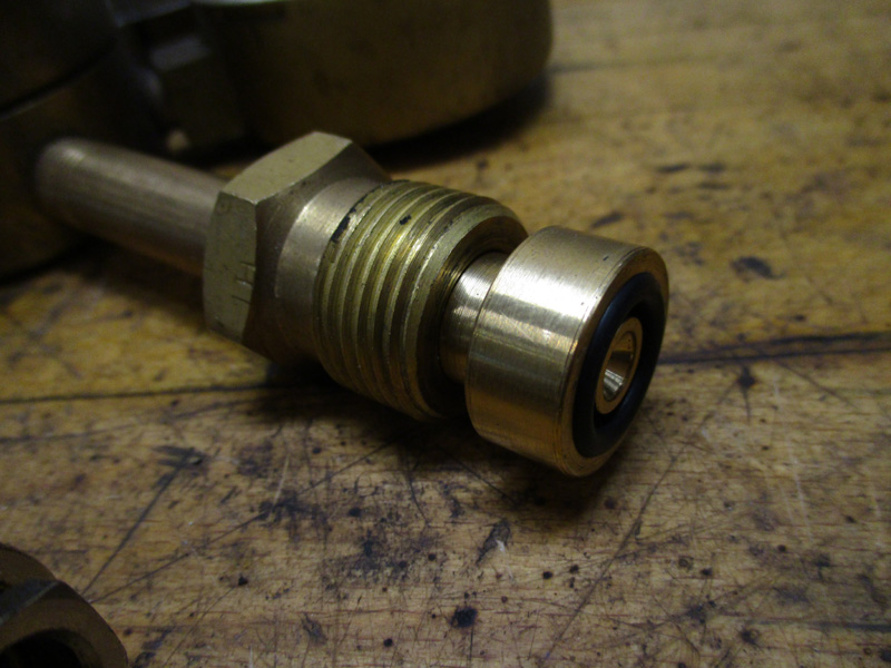

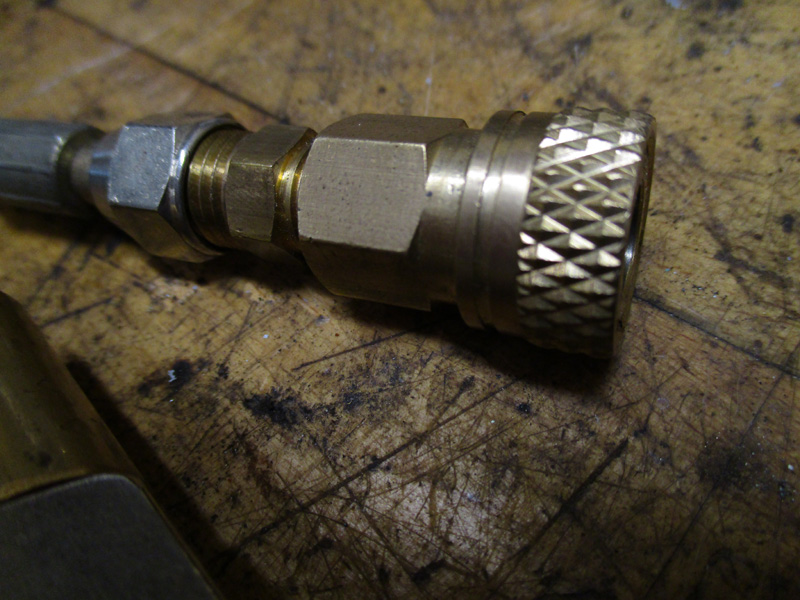

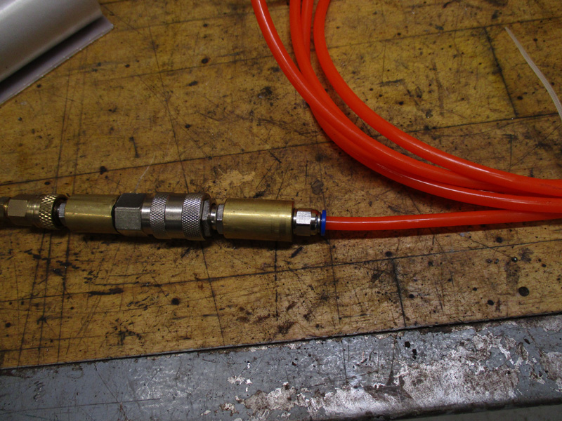

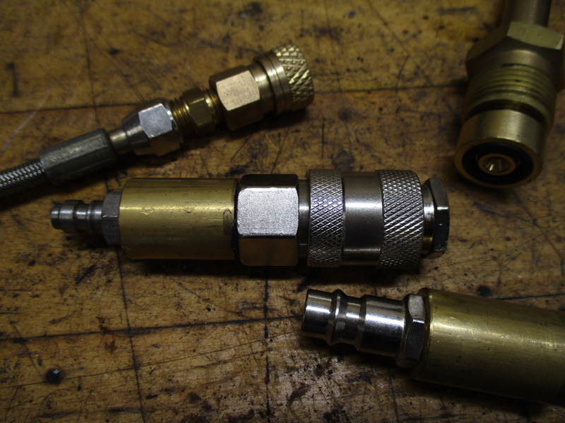

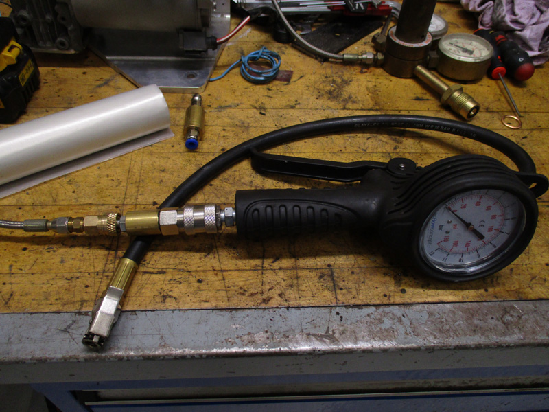

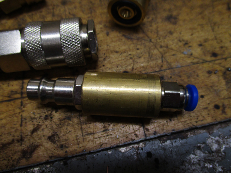

It was put together with stuff from the shop and a couple of lathe turned bits. Thats why there is so many adapters ;-) So cost was nill.
It will let me adjust output pressure, inflate tires + and most importantly fill Porsche airsuspension systems. It will hook up to both DIN 200 and 300 bottles.
