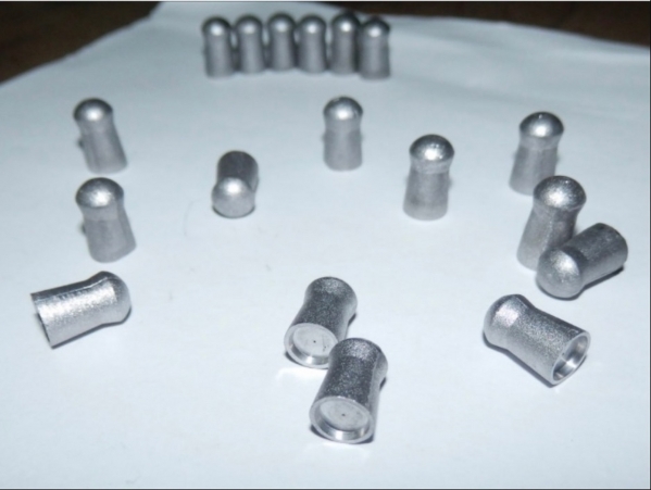

LOOKING for testers for a 45 grains .25 pellet design
I am looking for 80FPE guns and above to drive my 45 grains 25 cal pellets above 900fps for some accuracy data. if you have such guns, i would like to send you a few pellets to test out at 50 yards or 100 yards. Please let me know via pm by providing an address, your gun model, barrel twist rate and FPE setting (minimum 80FPE). I am also looking for FX Impact or Crown owners with higher output settings to test these pellets out.

these pellets will fit a marauder magazine, length=0.425"
Hi I have been making pellets and slugs for 10 yrs , in 22 , to .30 cal not .308 , I have used a corbin swag machine and dies , and custom molds , ect , I have had some great performance with slugs , I have a few molds for .25 caliber pellets maybe 4 or 5 molds, and mine are fair not as good as JSB ,but hit much harder . Im a hunter . however My slugs rock , I have went threw many designs to get what works for me , I have a shooting range from 20 to 200 yards where I do all my testing , I would be glad to try them and or send you some of mine if you want , can I have some specifics ? such as well BHN of lead , BC or any data you have , your skirt look like about .025 with doesn't matter due to a filled cup , so this strengthens the skirt like a slug , The solid ones I had tested I had .00156 difference between head and skirt , with a BC of .069 using 6BHN @670f quenched undersized naturally , head .300 \, I see a line you casting these correct ?

I have experimented with similar filled pellets however you shape appears a bit different then mine .
