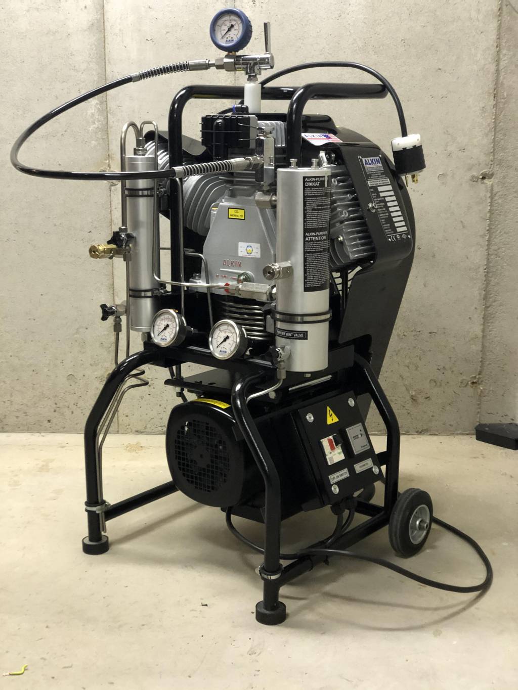

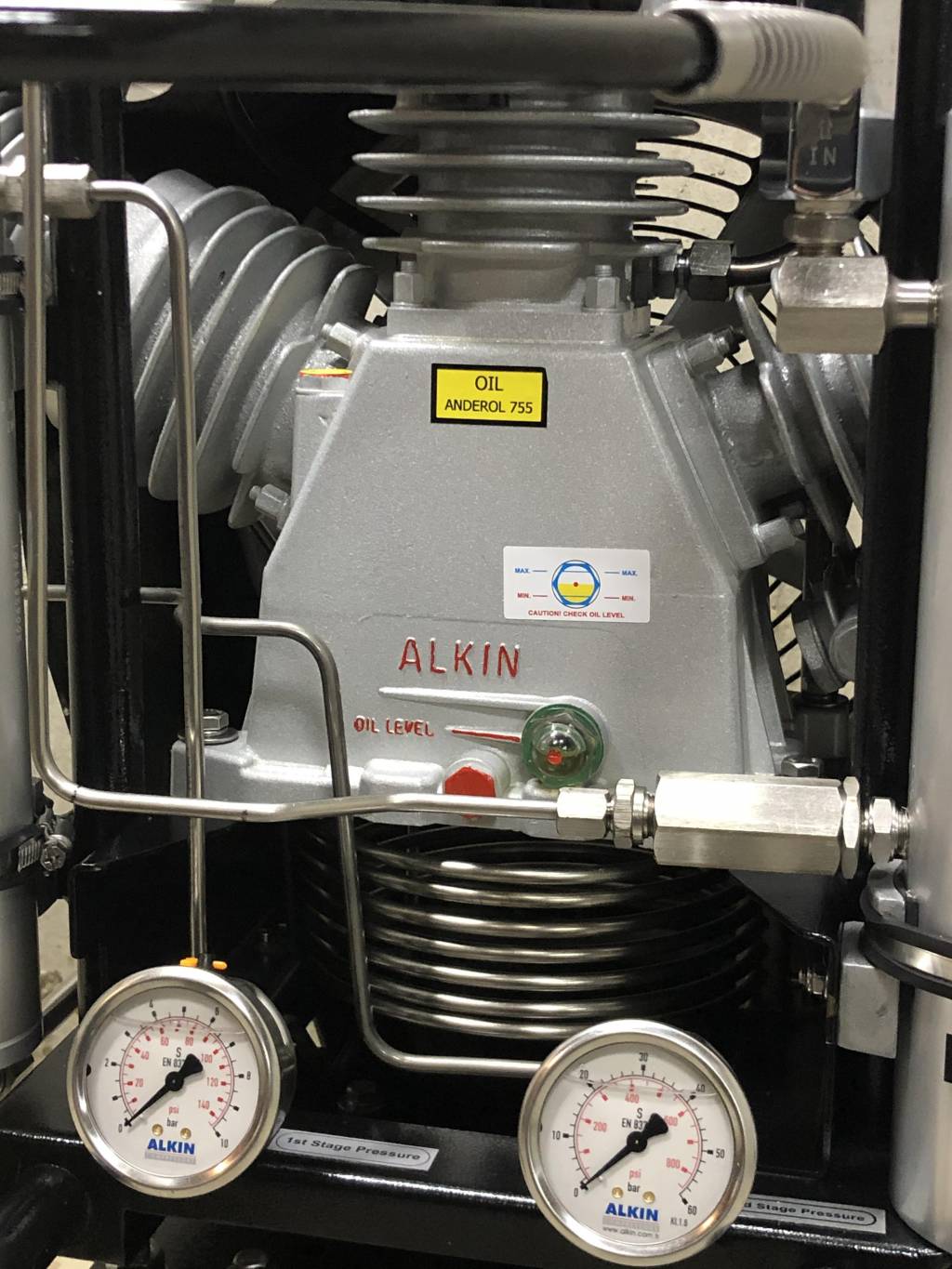

Now that I got mine home, and the plug installed, I thought I would post a few pictures. Let me say: the vertical configuration is REALLY nice with the roller feet-super easy to move around for one person!

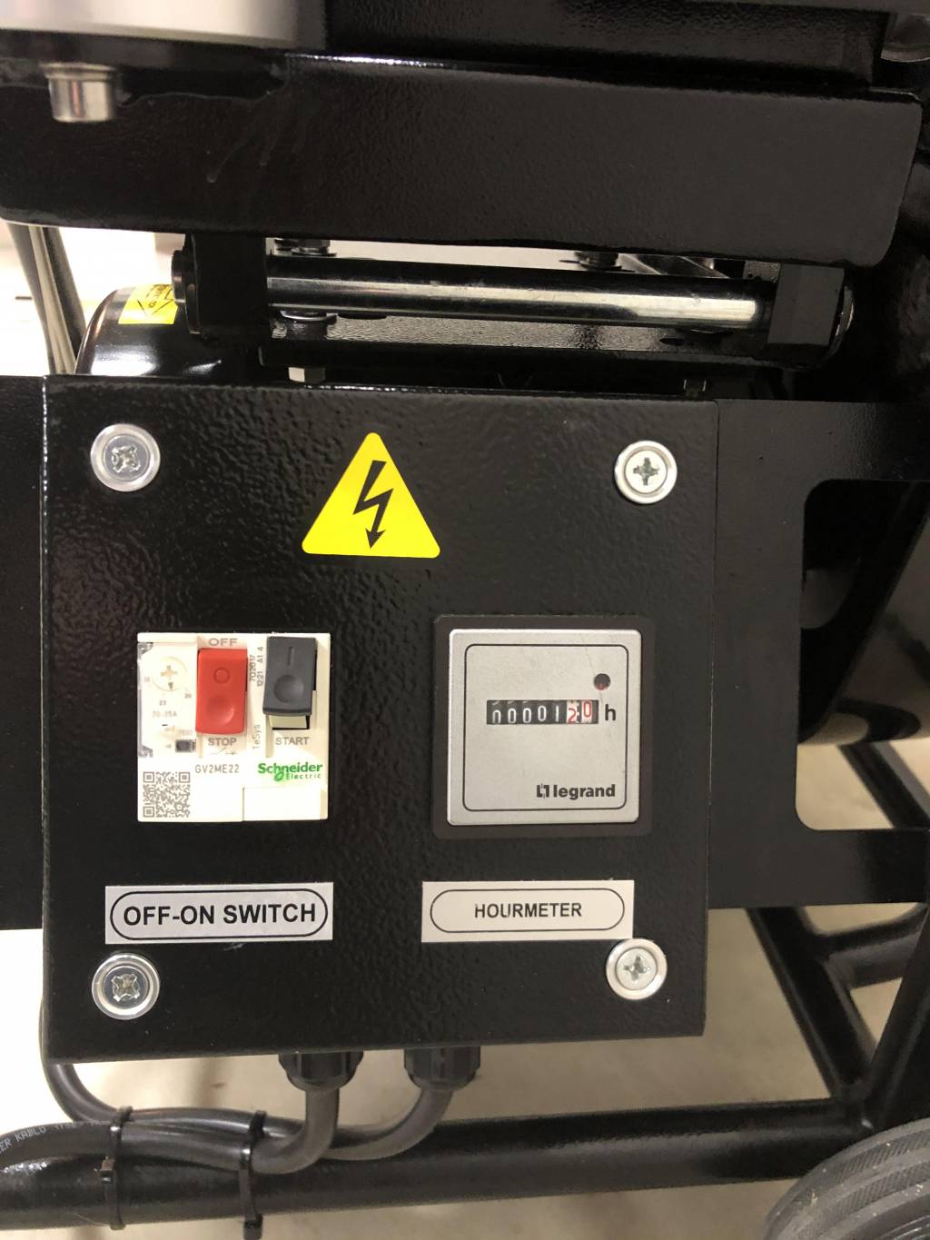

I like having the hour counter on the unit as well. You can tell this unit was designed right. Talking to David, he made it clear the the parts sourced in the unit were German or other high quality parts-and it shows in person. Definitely happy with my purchase!
I just need to wait for my male-to-male foster fitting to arrive now (included by Alkin).

I should also add: David (user: AlkinCompr) has been super helpful to me (as has Steve, aka Humdinger, here on the forum). David reached out to me to ask if I had any questions, based on my post here at AGN. Since then, he has emailed me, texted me, called me live on the phone, and PM’d me to answer all my questions. That includes texting me back within minutes, after hours, for simple questions I had. This kind of support definitely makes spending a little more money well worth the expense.
Additionally, the unit came with a 44 page parts book that has exploded views of exactly how the unit is constructed, with part numbers for everything, and wiring diagram for the whole unit! The only thing it doesn’t have is torque specs-but I’m certain David will provide them if I ever needed them.
The parts book is separate from the 55 page manual of operation...
