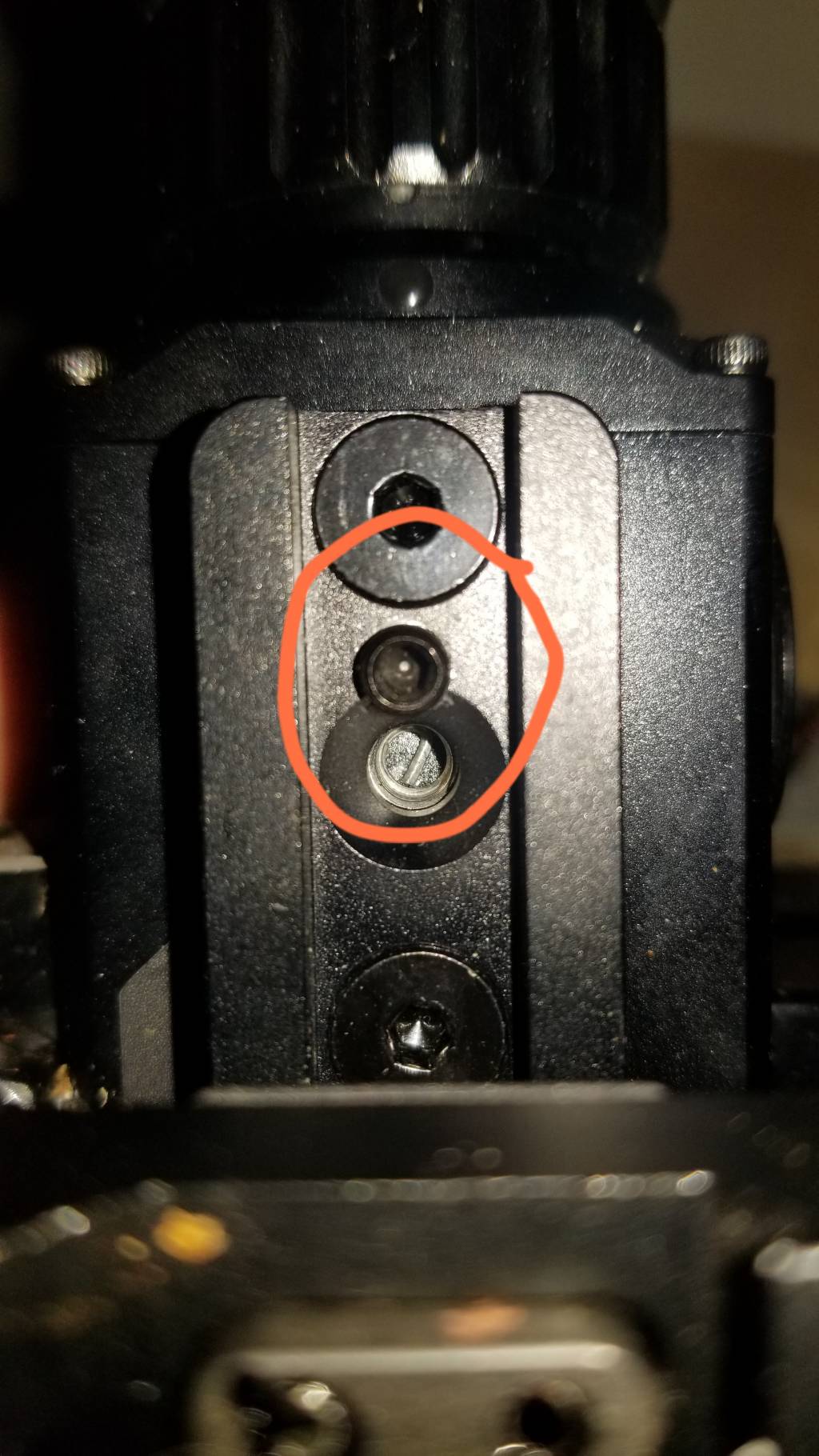

Heres the ticket for elevation, drilled and tapped for a set screw just loosen the screws add some elevation and snug it down again. Not perfect as you cant adjust it on the gun but once is good for each caliber at minimum. I dont adjust it much.

Thanks for the elevation tip.
