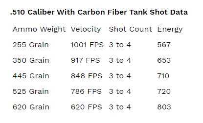

Kevin, Have you looked at this mold? At 310gr it would probably give FPS in the high 900's and give some adjustment downward.
http://arsenalmolds.com/bullet-molds?product_id=68&limit=100
Did you see this on AF website?

I bought the above mold. We were thinking the same thing on weight, Loren. Your thoughts and opinions are based more on data and science, and mine is based more what I saw from the thousands of shots I put through the .308 Texan. I know I've posted it before, but I found that the best bullets were on the small side (110 to 115 gr.), had flat nose, and had lube rings. Since the .50 and the .308 share a lot of the same stuff since they're both Texan Standards why not start with something in the style/range that worked best for me?
The Arsenal links you shared showed bullets that are more conical. Those definitely did not shoot as well FOR ME in the .308, but they're the hot ticket in .257. Go figure.
We'll see. The proof is on the paper, not the computer monitor or the chalk board. Hopefully I find a good one that shoots well.
