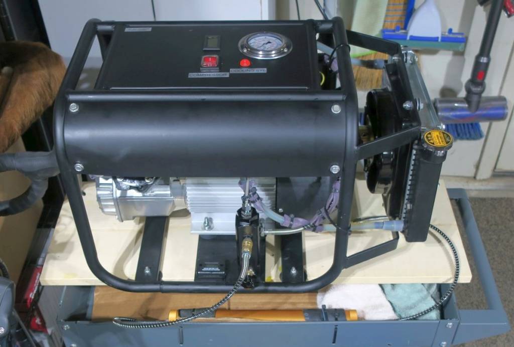

I have had experience with similar compressors. I believe the compressor, motor and frame assembly are all 'generic' in China, and various manufacturers sell them at different price points depending on level of installed control system (whether it auto-drains/auto-stops, etc.), equipped with cooling system or not, etc. Here is one of my generics marketed as a 'Zip-Air 1000' with inbuilt cooling system:
You can see the similarities with your Tuxing. I have even purchased re-build parts through Tuxing and they fit and work properly.

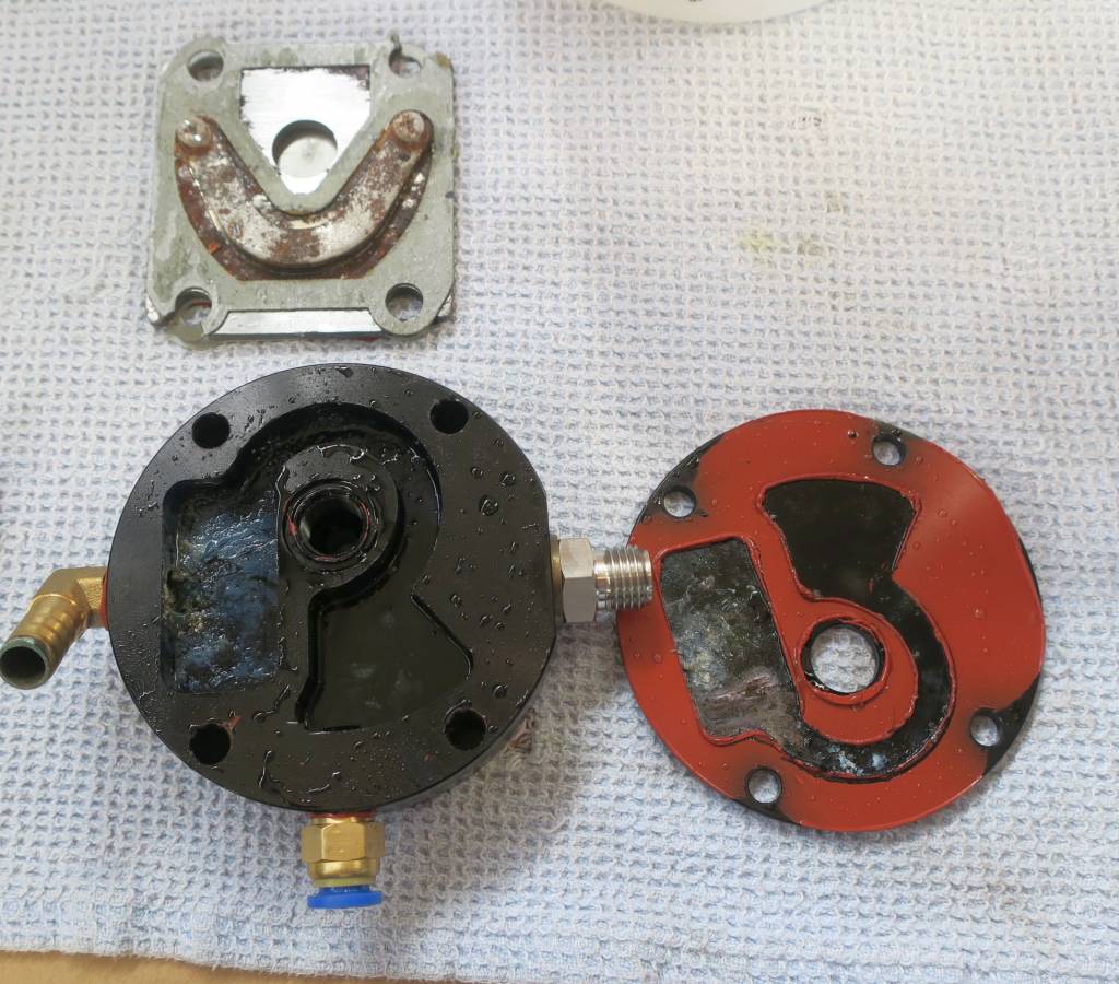

You can definitely leave it hooked up to your cooling water supply source for an indefinite period - just make sure that you have anti-corrosion additives in your cooling fluid. A little automotive anti-freeze (just a couple of ounces) or something like Water Wetter. I have heard on this forum to use one or the other, that using both is not as effective as using either alone. You need corrosion protection in your cooling system so your compressor's innards don't start to look like this over time:
