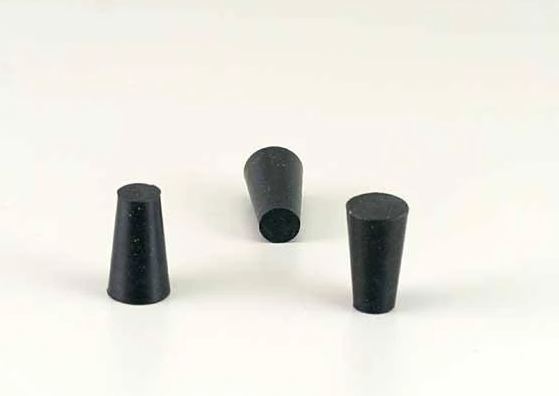

I found the right size of rubber stopper at ACE hardware for .80 cents and it worked perfectly on my Marauders
