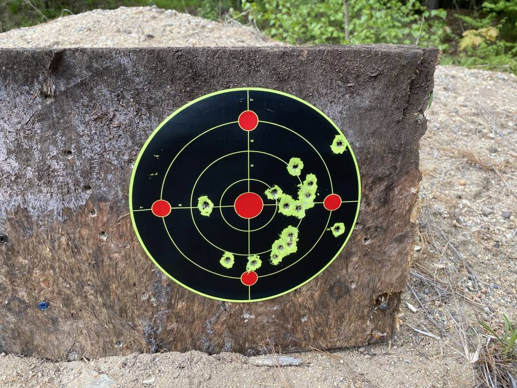

Wow... amazed no one has mentioned the .30 Uragan.
I took mine out to 200 several times and played with different slugs.
So far, the best is the NSA 49gr. It gave me this group at 200 : 13 just under 4 inches, with 2 flyers to the right. Was a touch windy but I'll bet that was on me.
I have yet to test many other weights and slugs. I'm sure I can tighten these up.
I dunno, just FYI
