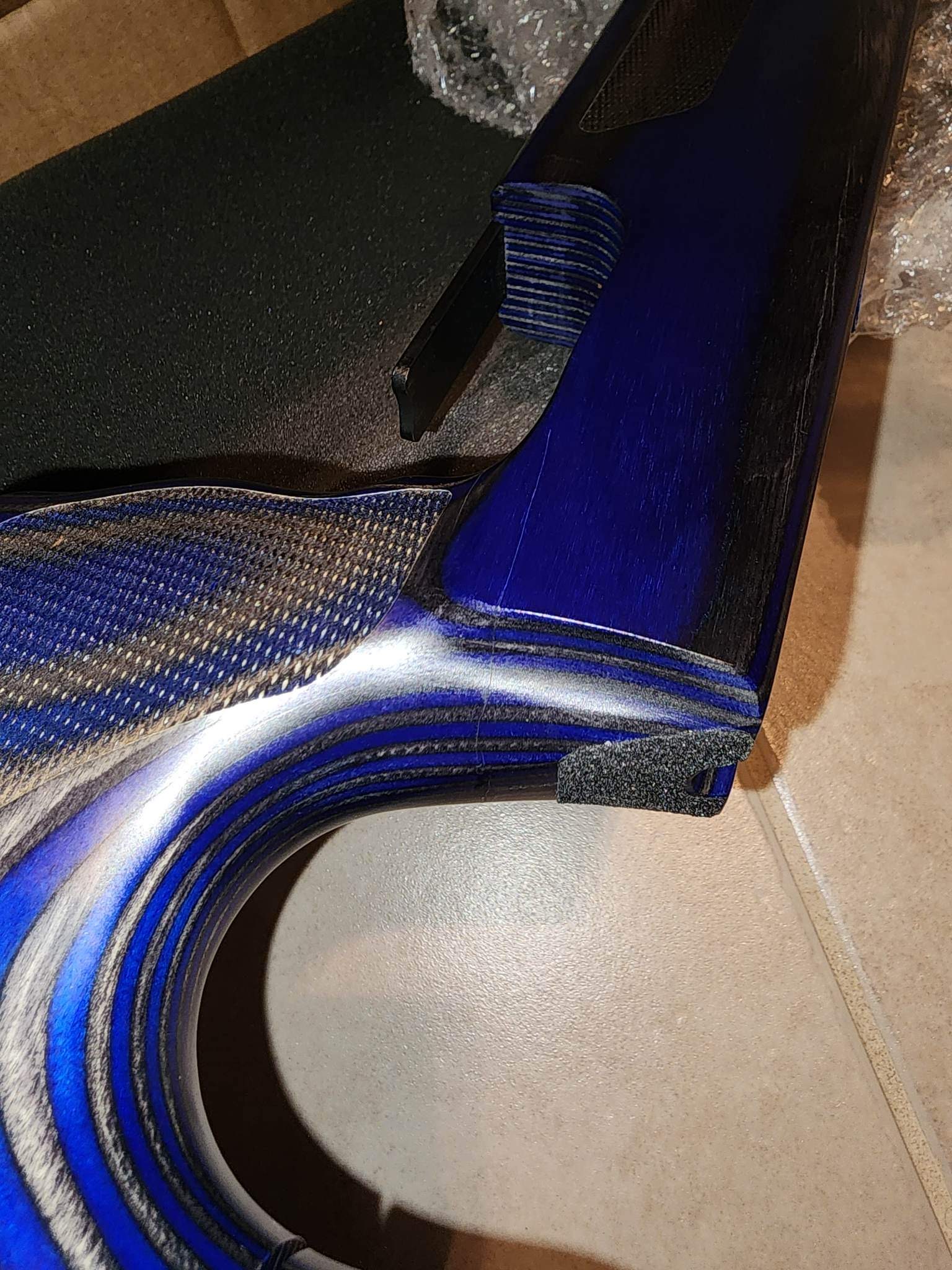

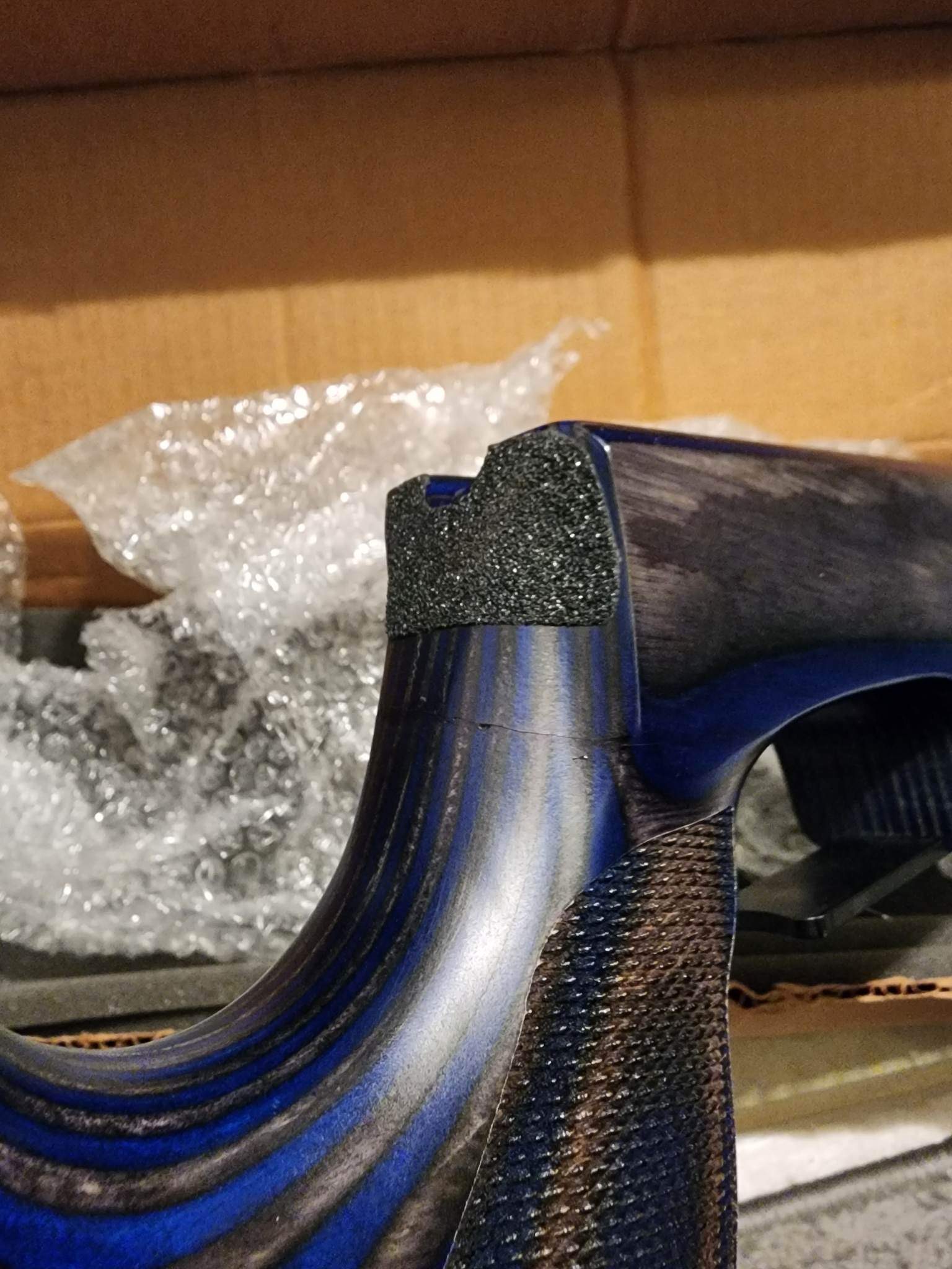

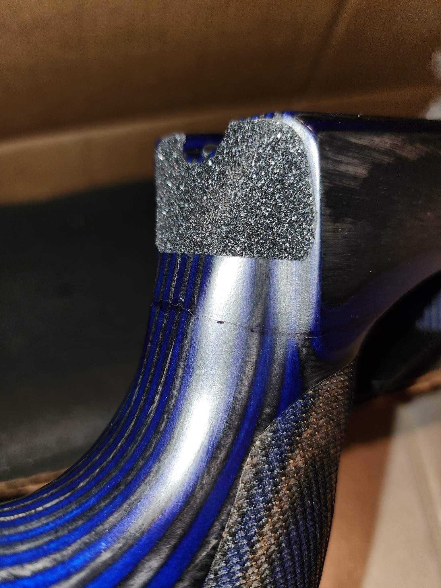

Crack encompasses the entire hand-rest. There is also a crack where the main action sits. Needs to be done perfectly. Money is NOT an issue. Even if it costs as much as a new stock to fix. Give me an estimate in DMs and link your website.

Fix is using FINISH GRADE epoxy that when mixed up is warm honey or thinner in texture, slow curing and penetrates very well. Some heat on opposing side to where epoxy is placed will draw the epoxy in towards the heat source. Over and over you do the same untill the joint threw entire fracture is wet.
Clamp down on the crack, wipe off excess and set aside for 36-48 hours.
Have repaired quite a few stocks threw the years with similar fractures. It will never be cosmetically back 100%, but the structural integrity can be saved.

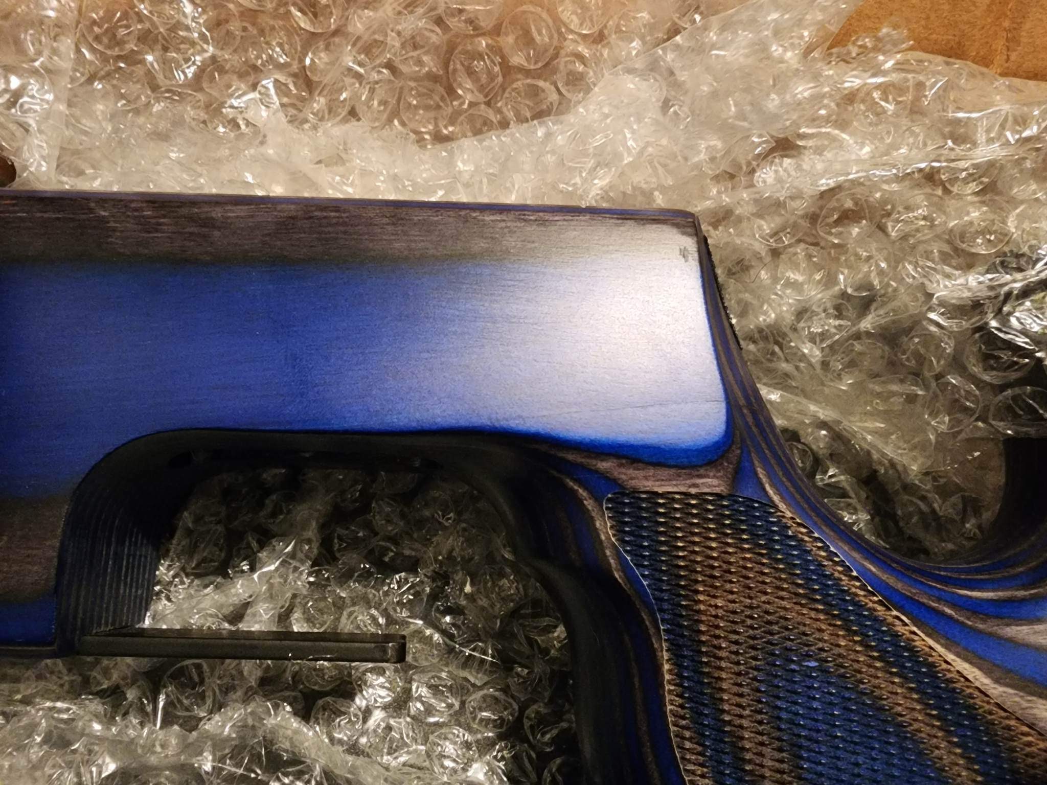

NOW all that said ... I see something that is NOT supposed to be there ... That BLACK plug / filler just behind the receiver pocket LOOKS LIKE a PREVIOUS REPAIR was made from the stock having a broken wrist area previous ? Common to drill and place a vertical dowel or wood screw in that area that travels into the grip drawing them together or if minor aligning ?
Just observations ... Been there & done that :oops:

Good eye. I didn’t notice that sticker.

I assume all of the current RAW stocks have the wrist of the stock reinforced with what looks like a carbon fiber rod. I know mine does. It appears to be drilled through the from the black spot in the above picture and the is a similar black spot on the bottom of the pistol grip.

This makes so much more sense now. Thank you. It explains a lot.
