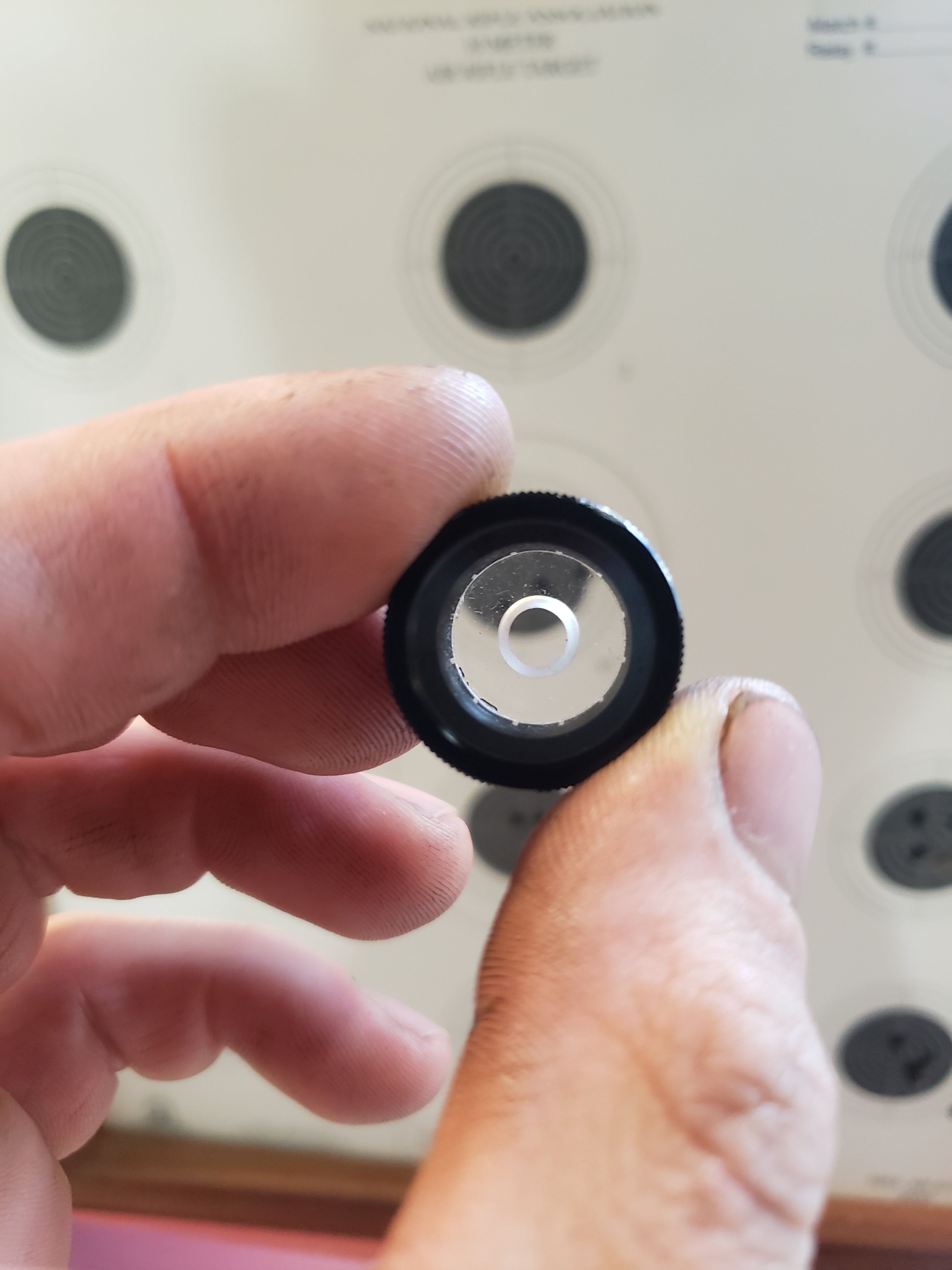

I picked up an FWB300 for a friend so I did the usual teardown and inspection and gave it a quick test run before handing it over to him. This gun came with a clear 10m insert which I am really starting to like. Does anyone make this style insert that will fit an HW front globe or a 124 globe?

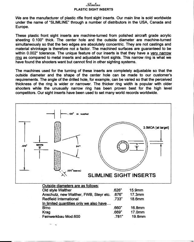

when Slimline sight insert were sold the model 300 -150-124 would have taken 15.9mm clear or tinted inserts, those also used in Old Walther, Diana and Kimber 82
the 15.9 can be found on Ebay
https://www.ebay.com/itm/332403540723?hash=item4d64cb82f3:g:6JMAAOSwDYBio3Si
now i don't think Slimline made HW inserts and at .575 or about 14.6mm the 15.9 inserts could cut down with a clever jig
the insert you show looks like it could have come from and early Diana 75 but now sure

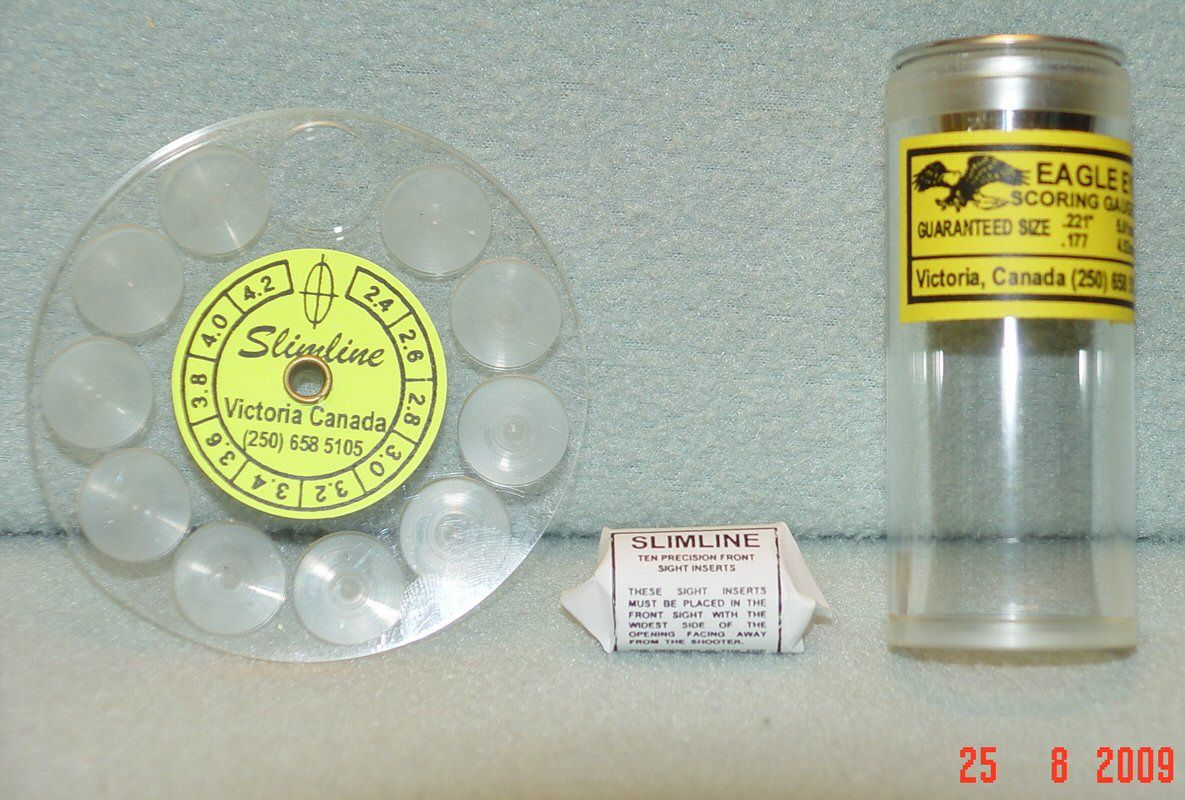

just a side note he would sell these inserts in clear round storage units and if a company want a large ordr the slimline name was replaced with the sellers name
he was originally out of BC Canada and then he disappeared

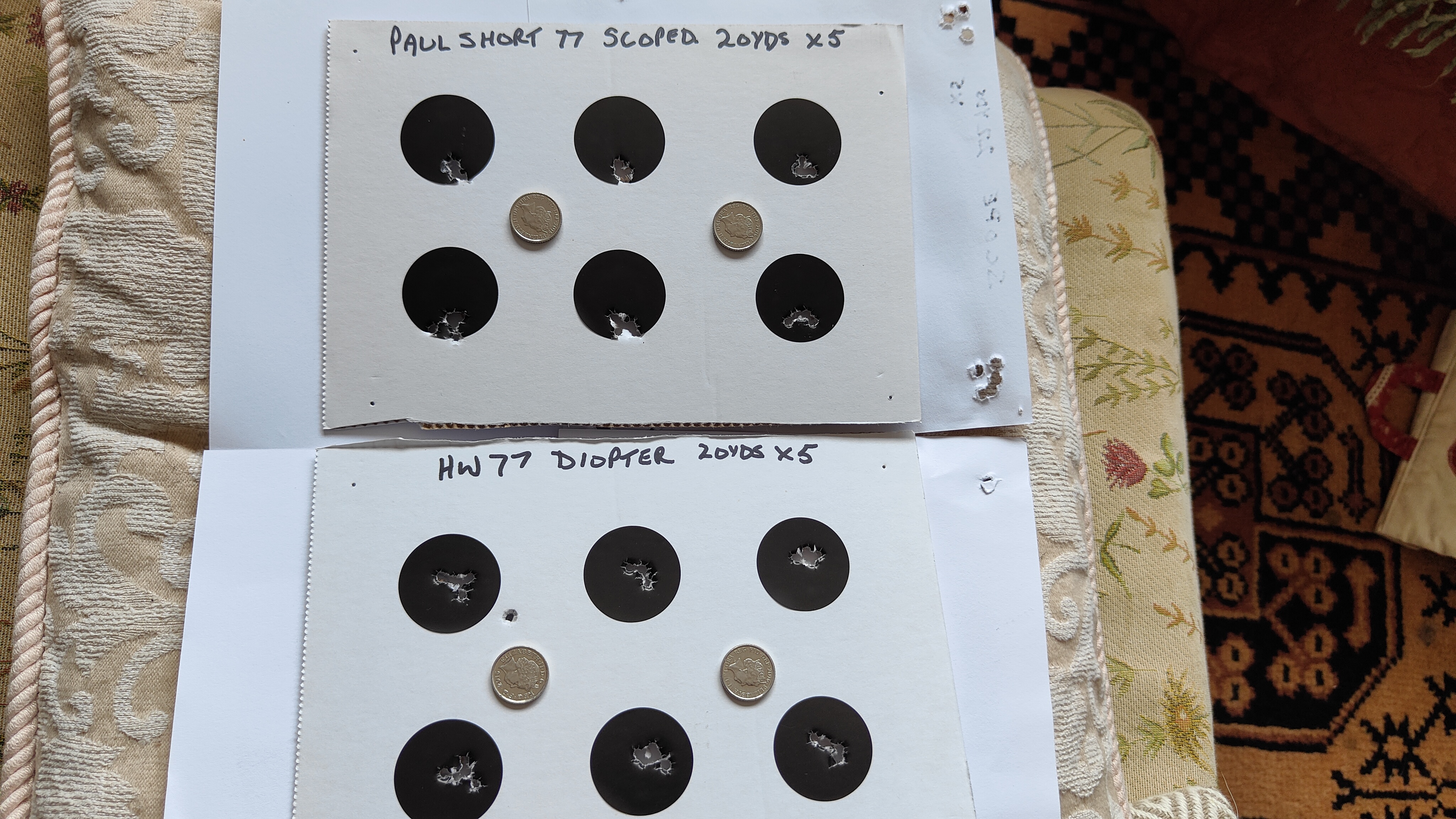

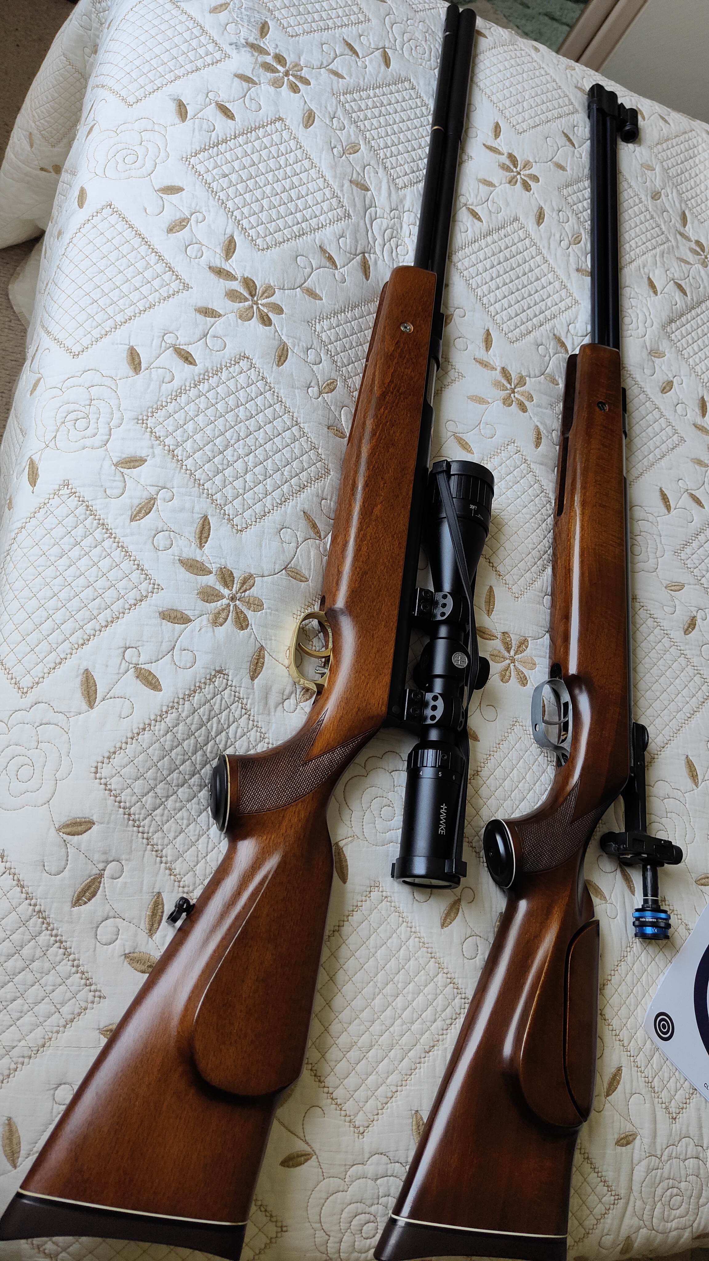

I shot these yesterday in a gusty wind see one pellet trying to shoot between gusts. I was using these forsight perspex front sights from the AGF. Shot these rested at 20yds. The top card was shot against my highly tuned scoped HW77. The bottom card was as you see shot using my 3 year old hw77 with the diopter.

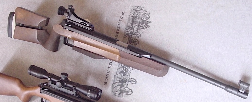

I have a Diana 75 T01 with the diopter rear and clear plastic insert in the front globe. Works really well.
A Diana 75 is exactly what I'm looking to use one in 😄

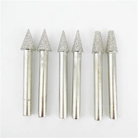

So a guy could not get some plexiglass or lexan and cut and drill one ?
Seems a steady hand and a Dremel could do..
Lexan tends to be cloudy, and is awfully hard to work with. I'd go with plexiglass or clear ABS as they are very clear, easy to cut and drill, and easily polished. You could probably re-create the angled part of the hole that catches the light with a starter drill.
Theres bits for that hole metal or stone . The stone you can pre shape to suit the need

the idea of making the clear insert is very interesting and i think those that do are in for a very big surprise
first solve all the problem you are going to have, all the tools you could need
the tooling to make the inserts is far more money than the 3 bucks you could buy one for
a set of these was 20 bucks back in the day and they came in the holding tray

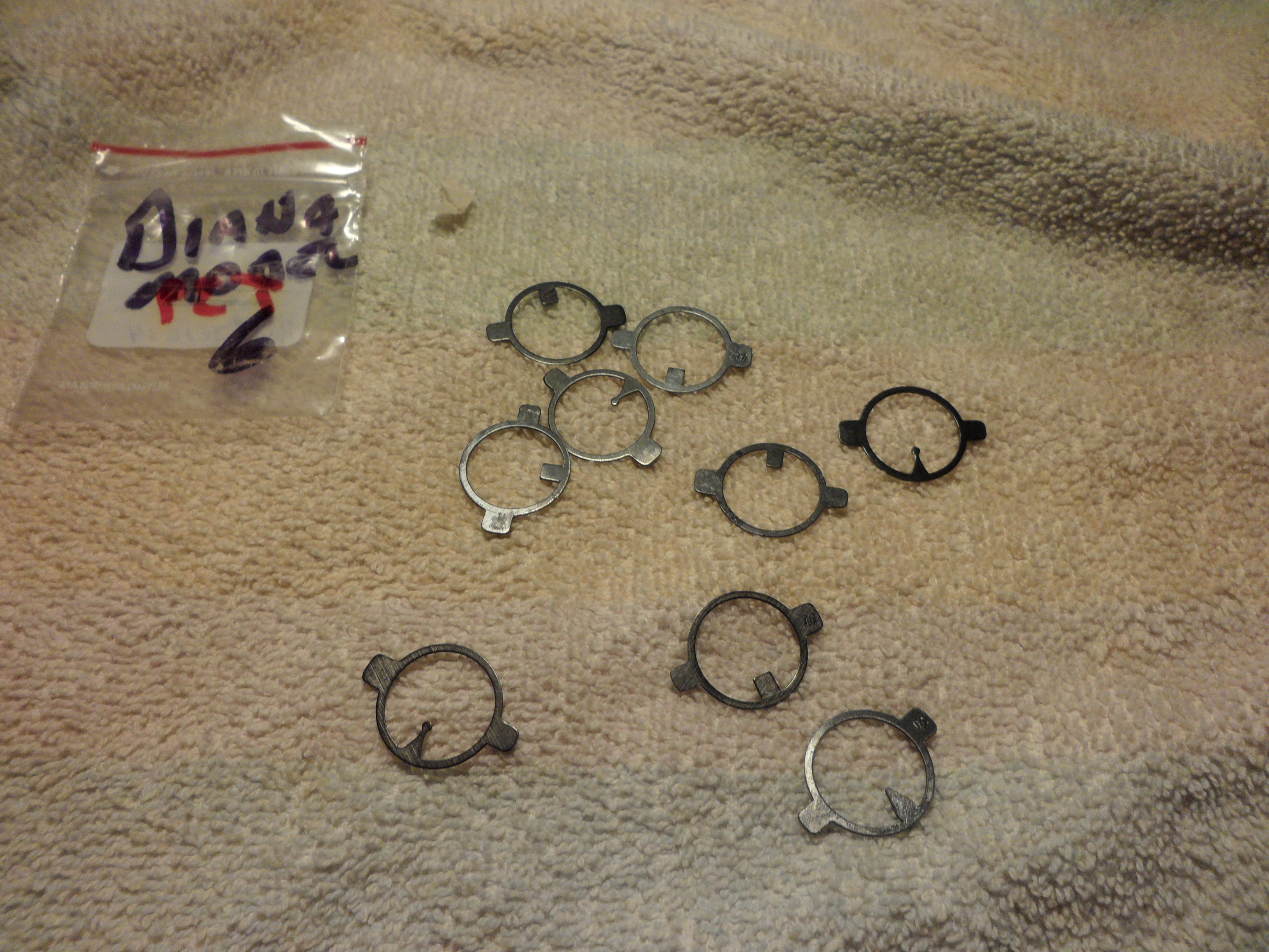

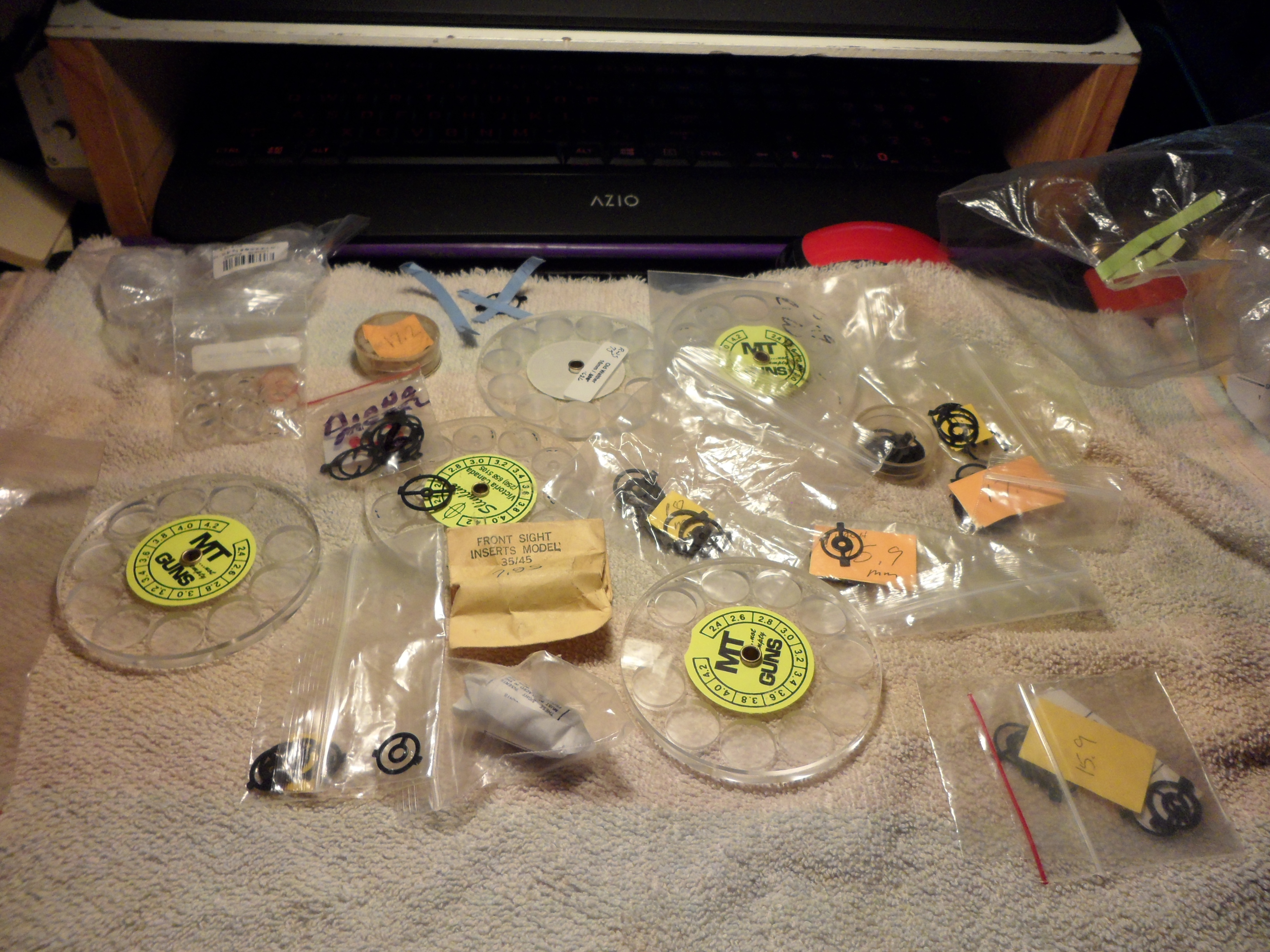

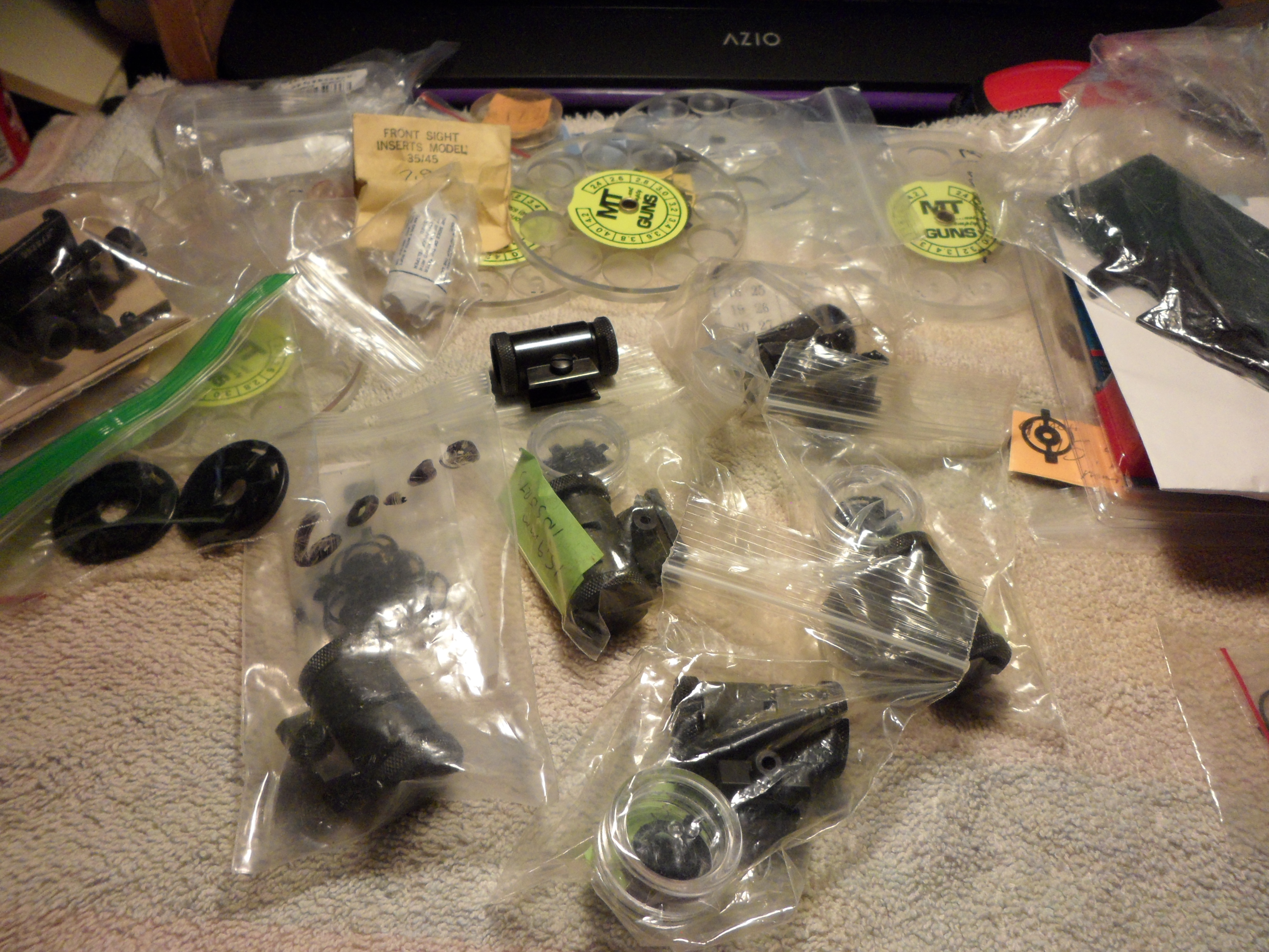

so, i am a hoarder, inserts, front sight, diopters and here is what some of it looks like
but when i need something i just go to that box
nothing for sale and yes this has taken many, many, years of collecting and yes i am nuts but it all has value
Reactions: Sqwirl57
View attachment 380696View attachment 380697View attachment 380698
Nothing nuts about that. I'd say you have things pretty well figured out
