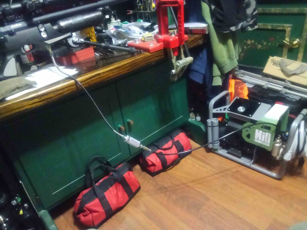

I attach the one that came with my Nomad II to my short Hill hose and it works great. Allows me to place the airgun above the compressor for better moisture control. Also get the benefit of the Nomad II's filter, which by the way never has any signs of moisture in it.
