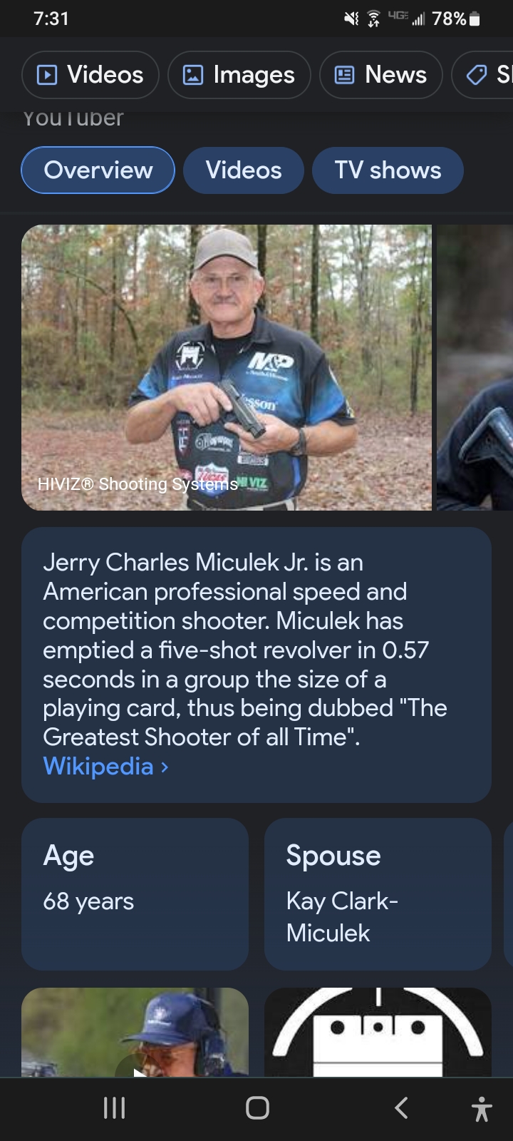

For a long time I've said a good Barrel is an accurate barrel. Length does play a role but only in adequate spin and projectile to rifling engagement. But this can be optimized at almost any barrel length. You can find videos of one old time gun pro making crack shots at 200+ yards with a snub nose revolver. Guy was no fake or joke either, wish I coukd recall his name. He was also the fastest shooter alive at one point in time, maybe still is.
