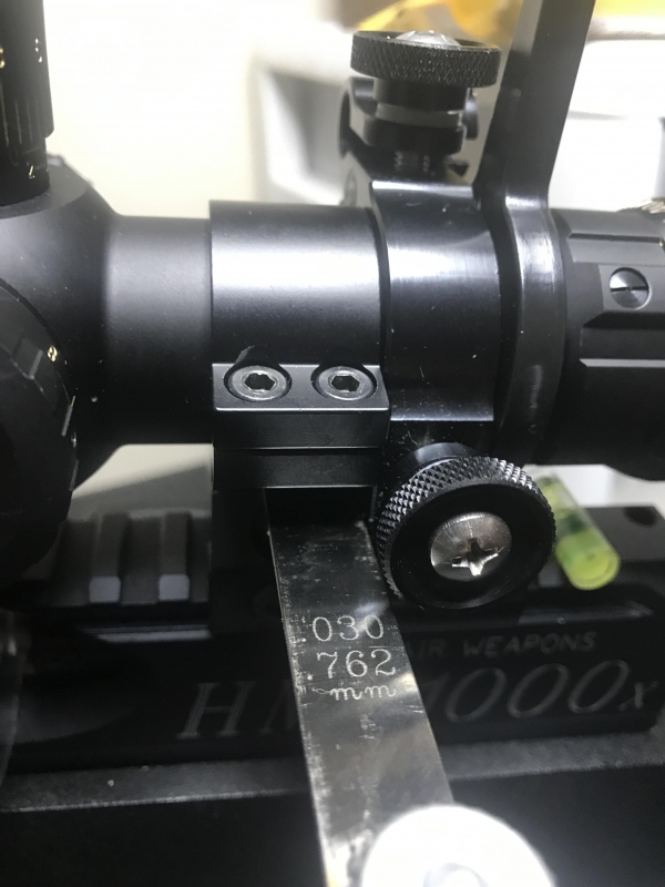

I'm using Burris Tactical Signature rings. On my RAW 30, I have used 0.015 shims to add an additional 15 MOA to the built in 22 MOA in order to keep the scopes elevation in the middle of the adjustment range at 100 yards. I can put a total of 40 MOA in these rings if need be. These are easy to set up as long as you know more or less, what you need. I don't like screwing around with feeler stock and trial and error tightening grub screws. The Sportsmatch rings look kinda easy to use but they are $140. The Burris are around $75.
http://www.burrisoptics.com/mounting-systems/rings/xtreme-tactical-rings
BTW, you can also adjust for cant with this system. The plastic inserts won't damage or scratch your scope tubes either.
