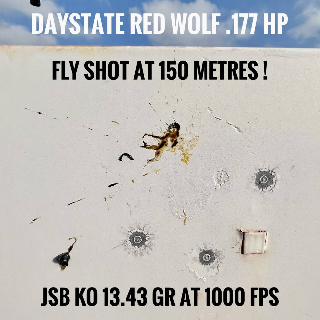

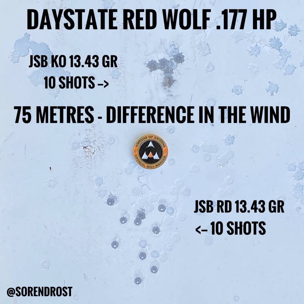

Been shooting long range for quite some time now using my Daystate Red Wolf .177 HP and various slugs 👍🎯
Started out shooting my own swaged slugs in 13 gr and 16 gr and they worked pretty well.
These days with NSA and JSB slugs available, I am also getting great results with these.
This was from yesterday - A friend of mine shooting and hitting a fly at 150 metres or 164 yards 👍 I was watching in my scope alongside him 😊
Hey Soren, tell your buddy he was lucky to have a good spotter next to him lol.. I also tried getting a similar fly shot at the range, but now after you shared this, its definitely on top of my "to do" list haha..
Btw, I read that the KnockOut Slugs .177 Cal, 13.43gr. yield somewhat similar results to the .177 JSB Redesigned Monster 13.43gr. ? Did you happen to compare these 2 down range ? I do need to renew my 13gr-15gr supply so I'm curious if you any inputs to share? Thanks! 👍

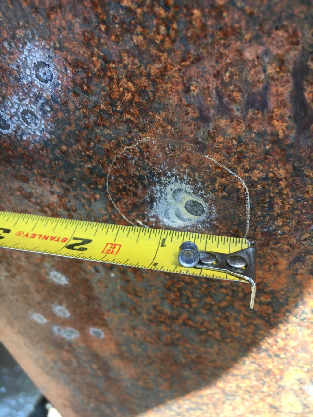

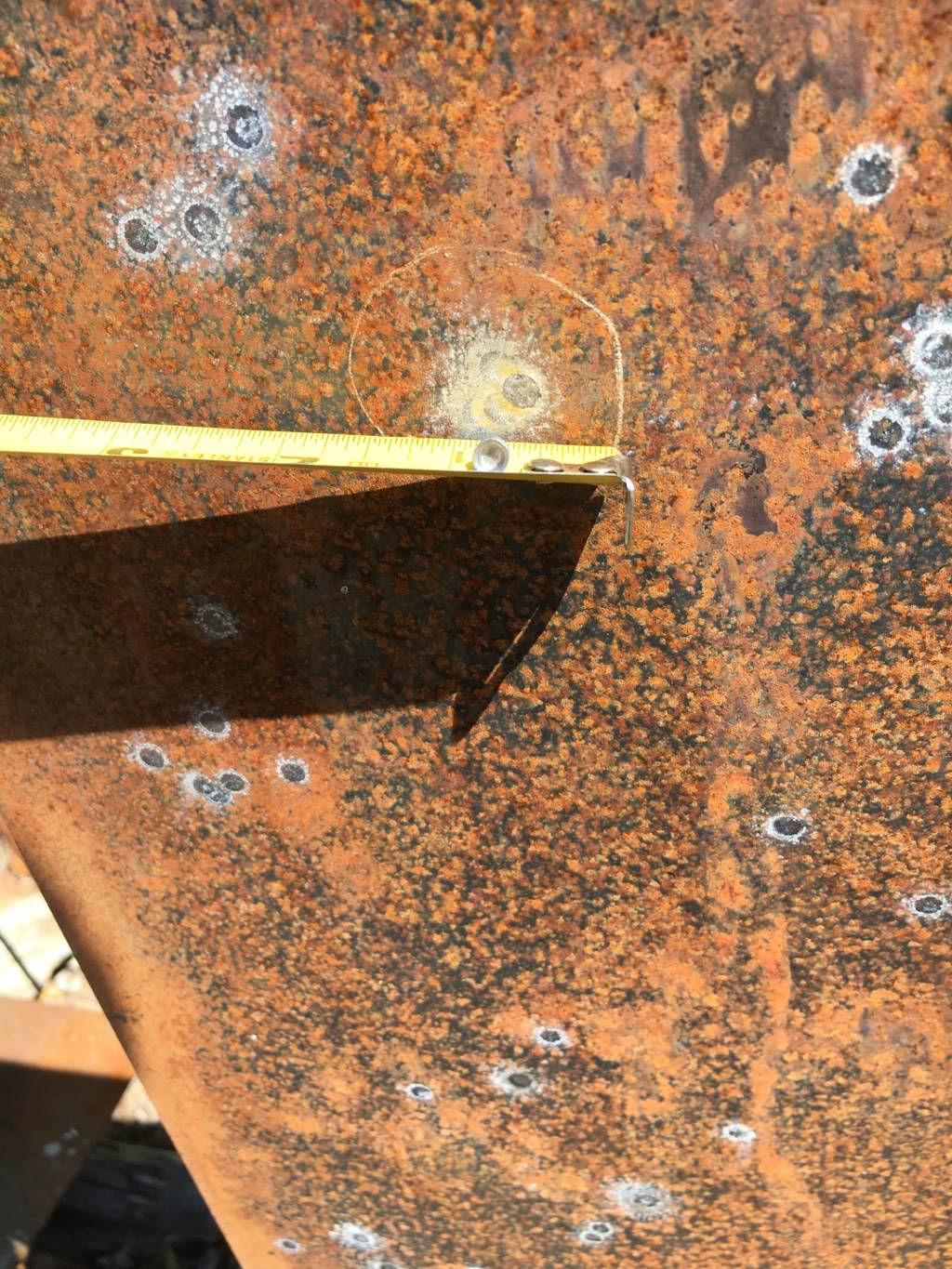

Though I've only taken them out to 150, the 20.2 NSA's shot a 25 cal hole for 5 at 100. Nothing else is close that I've shot. I have a 96v Heliboard on it and pl 12 is just 895. It's all it can do and feels like it, so I've not shot them much yet. I have an unchoked poly waiting to be fitted but EBR has occupied most of my time lately. Hopefully get time to fit the barrel and open up the port to see how it does. I Do enjoy the 16.1 Beasts at 980, though. Pleasant to shoot and incredibly accurate below 100. I have all the calibers for it but the little 177 w 16.1s by far easiest to shoot and most accurate at 50.

I would love to see a little picture of that five shot group. It gives me something to strive for. I’m not getting it near your velocity. I of course have a standard board, but it’s my magic rifle…I’ll be candid, I’m so afraid I’ll mess something up, accidentally zapp the board, change the settings I don’t know. I’ve changed the boards in my other rifles a dozen times.

I will see what I can do, now that EBR is done. I wouldn't mess with it, either. I really only mess with mine if something seems off or to prep for a big event to keep things from failing. These are wonderfully simple mechanisms with nice controls in the board. Relatively painless to re-seal. The Heliboard is AWESOME .... in that I can make it a 177, 22, 25, or 30 by changing barrels (2 screws) and probes (2 screws), then set to the power level already set up for that pellet.... good to go and very repeatable and dependable. Hell... the zero between barrels is rarely 0.5 mil different.

Intersting that the difference isn't just windage but general dispersion.
