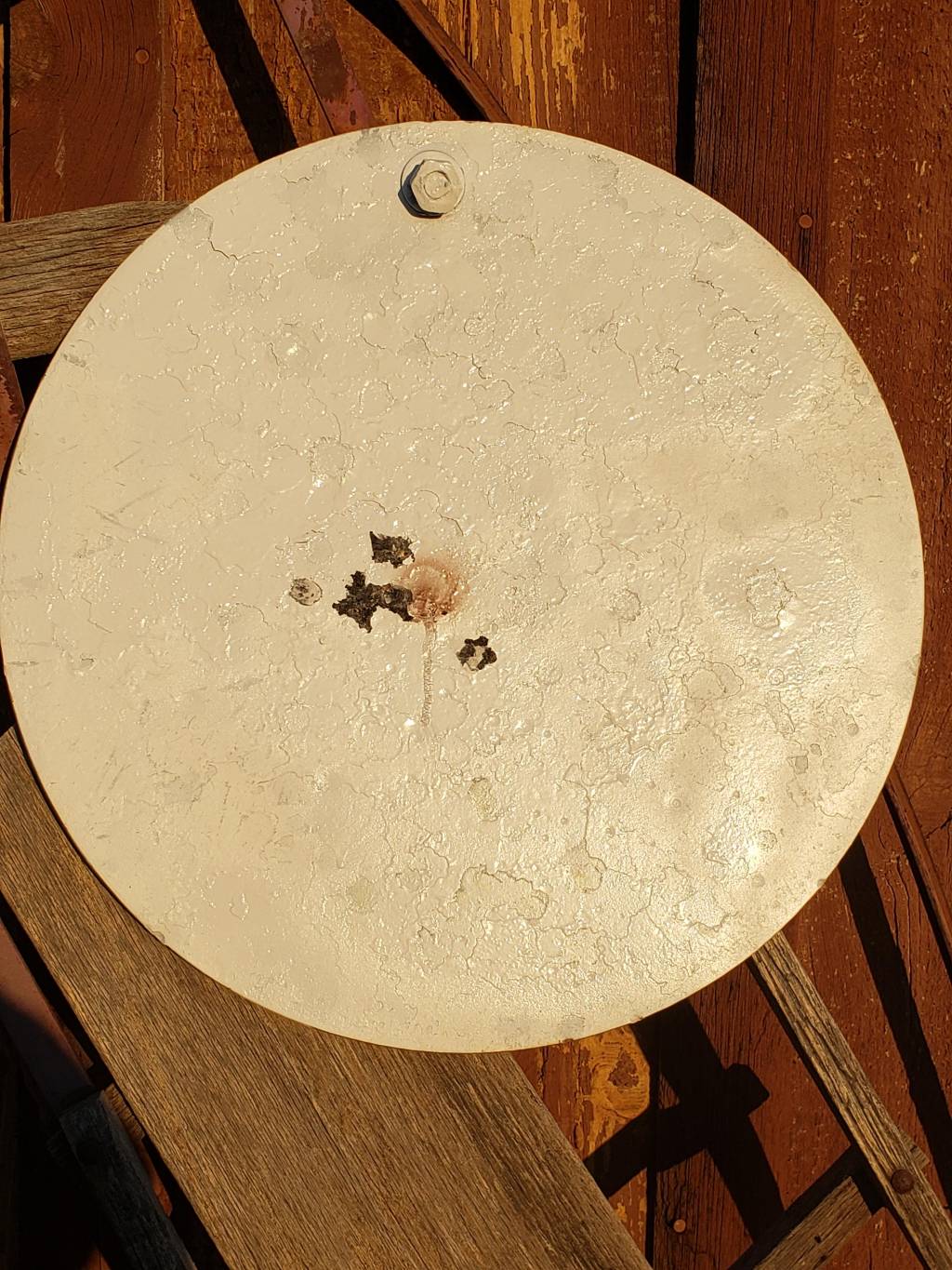

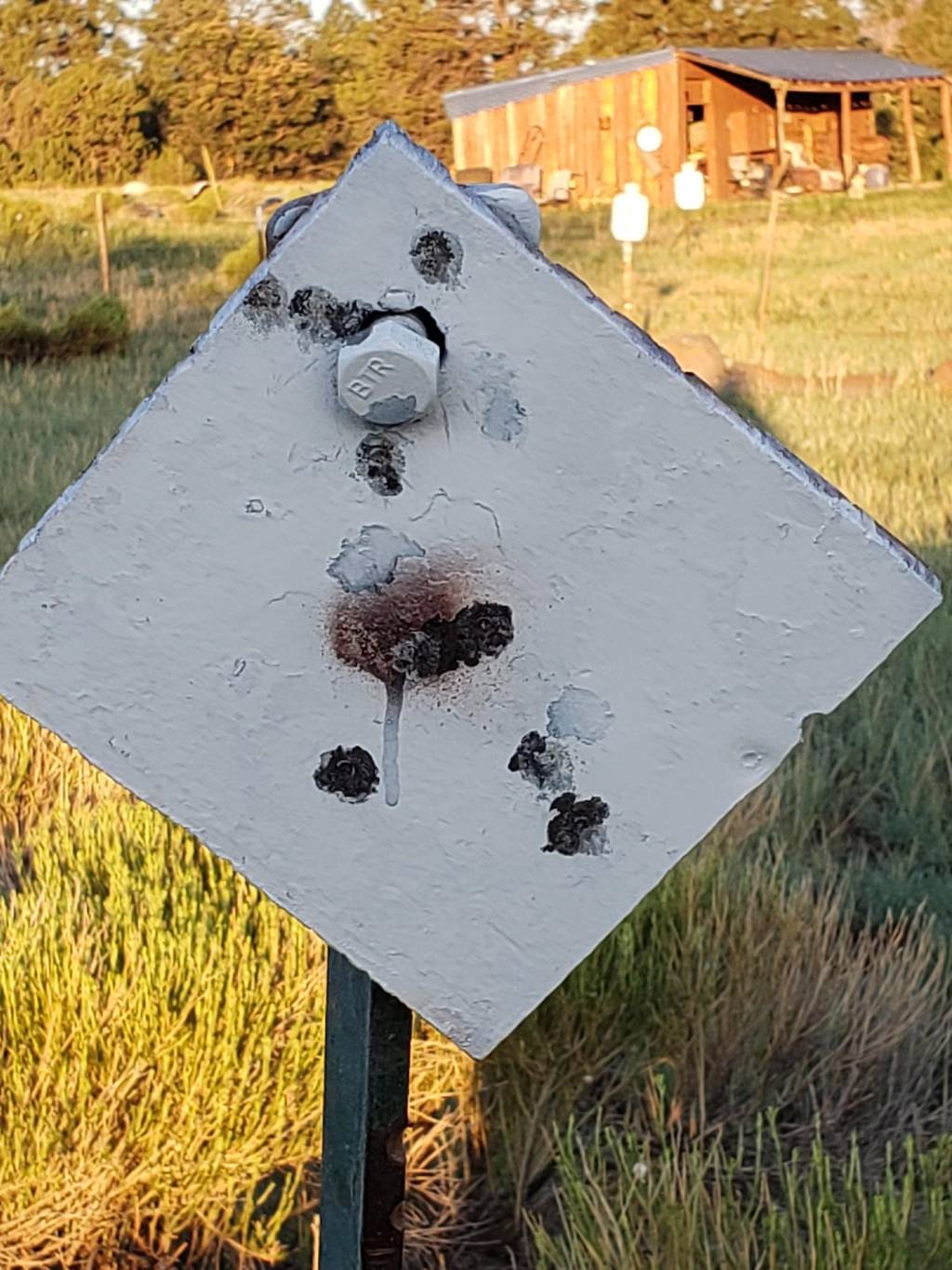

So last night I set up the steel in the pics with the intent of starting before sunrise when it got light enough out to see, which I did, and there was VERY little wind. I didn't confirm my zero because I didn't have a target set up at 50Y and I wanted to get going before the wind kicked up. Next time I will check my zero but I should have been within .2 mil of zero today and I'm guessing it was low??

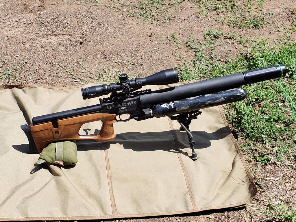

My King sends 29gr NSA's at 922 fps. The shooting was done laying down with a Harris bipod and rear tactical squeeze bag.

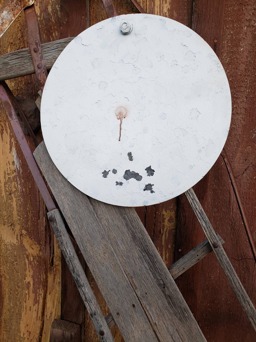

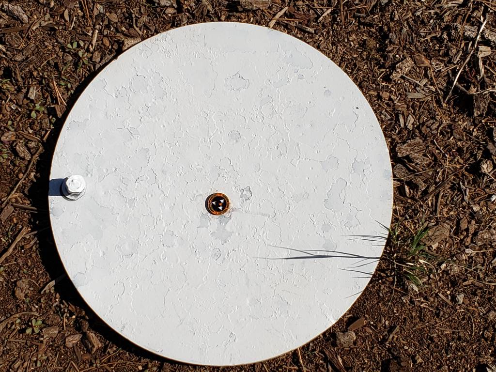

The AOA coin is 1" on the big round steel which is 15.5" wide. After I was done shooting, and after I repainted the steel, I put it on the ground and placed the coin over the brown spot that I had spray painted to have an aim point so at least you have some idea of the precision that's happening. Pics are of one 5 shot group and one 10 shot group at 200Y. The 10 shot group was my first attempt at 200Y and as you can see I was hitting low.

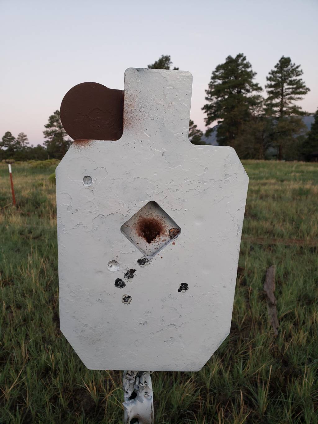

This one was at 175Y and this 2/3 IPSC is 1 foot wide. 6 in the head and 5 in the chest. The highest and lowest marks are actual holes in the steel that happened many years ago by a AR-15 (they look like hits from this morning but are not).

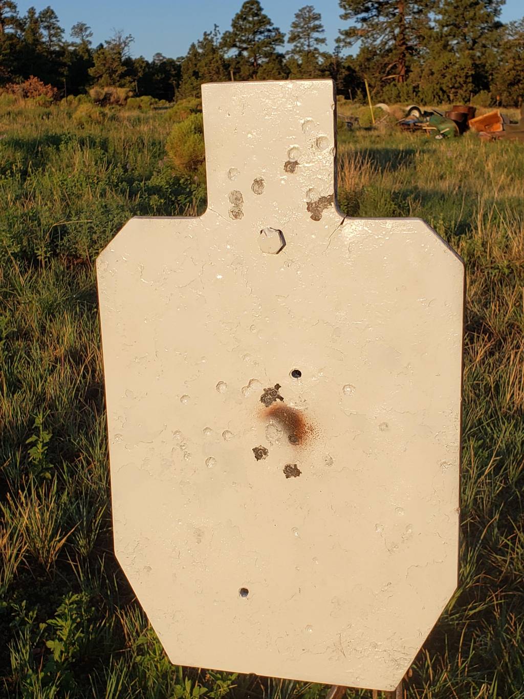

Next is 150Y. I hit the middle pattle on the 1st shot which made it swing out of the way so I had to aim lower then put 5 just below it.
Two 5 shot groups at 125Y. The bolt is about 3/4" wide.
I'm pretty happy with the outcome. This rifle and slug combo isn't super precise but there aren't big flyers either.
Nice shooting. It seems that barrel harmonics make the difference. Very slight changes in even how you hold the rifle can make a difference. Real careful with trigger release and follow thru. Minor changes in hammer spring ( if adjustable) and of course testing in calm conditions. I think you have about 90% of it solved. The last 10 is tricky to get but you are showing some real world groups that look well what? REAL

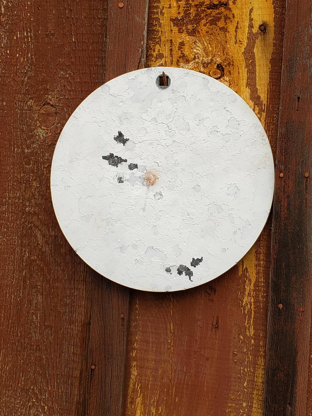

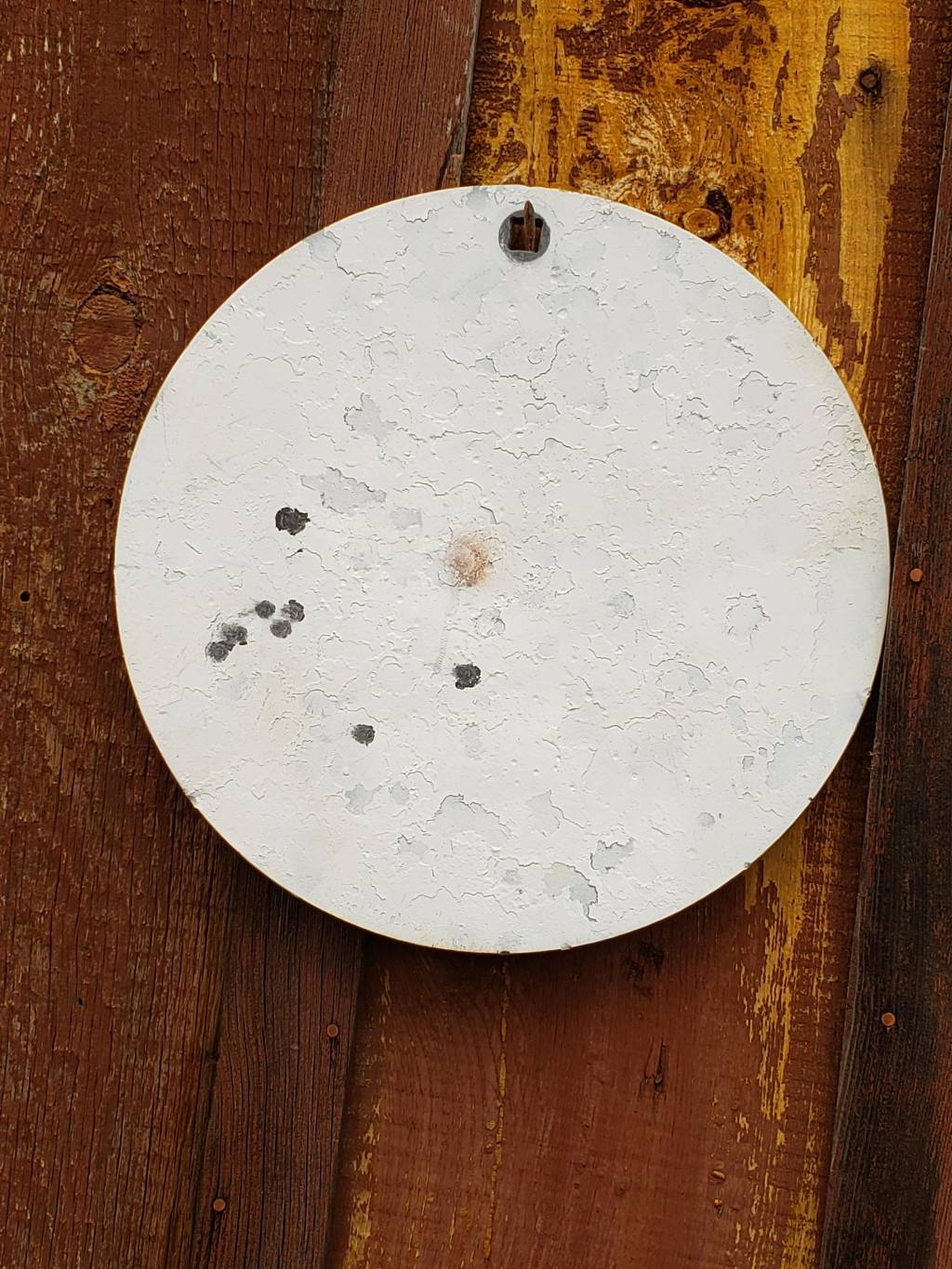

BB, this morning I played with holding the rifle normal and lightly against the shoulder, lighter seemed to help. Here's a couple 5er's from this morning at 200Y. Yep I'm trying to pull the trigger straight back and also following through. For an airgun this is a pretty heavy gun but compared to my centerfire long range rifles which are 16lb and 23lb it is lightweight and I can see the difference in how much extra weight helps holding the rifle steadier.

Wind had switched which I didn't notice so the 2nd shot missed left off the steel. so 9 shots from 225Y but the grass was obscuring the steel and I could only see the top third of it as well as not having an exact aim point. Fun times!

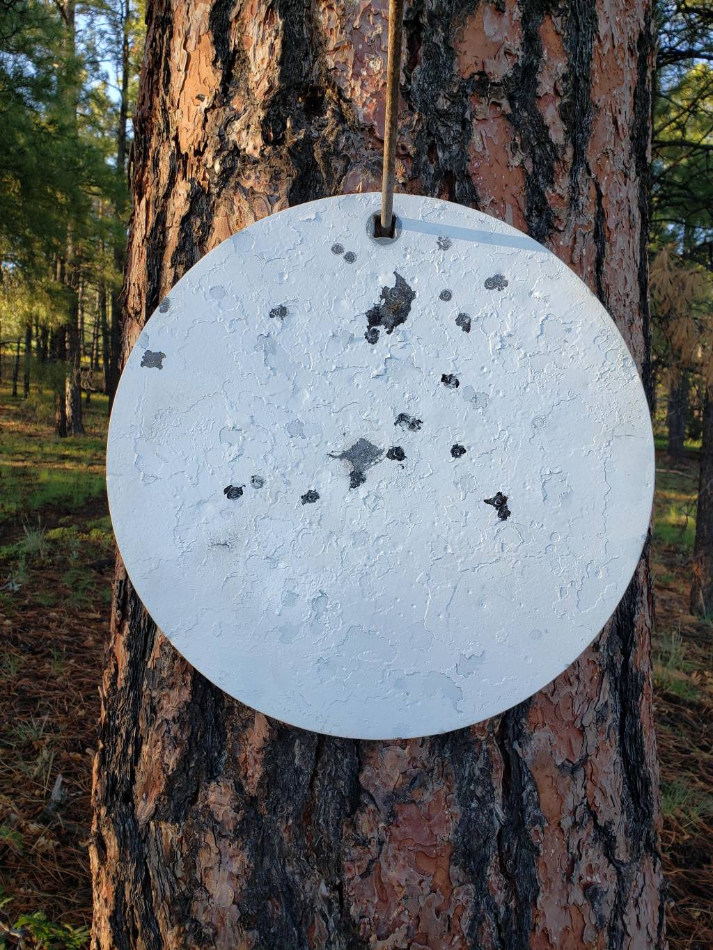

Here's 300Y from early this morning. Wind was 1-3 mph coming from the right at full value. Honestly it felt more like calm to 1-2 but.....
My perfect no wind morning got spoiled because I couldn't hit the steel even after 30 rounds of aiming all over the place - waisted a bunch of time figuring what was going on because I couldn't make out any misses in the dirt and grass below the tree either?! I went down to 230Y which helped and saw that I needed .8 mil windage to hit the middle and I was hitting .5 mil high.
Went to 267Y and had to hold a mil of wind. I was still hitting high though.
Then to 300Y again after painting the steel. It took most of a magazine to finally make that very top left splat on the edge with 1.2 mil holdoff. It turned out that I needed a 1.6 to 1.8 mil right wind correction for center of plate. That was why I couldn't hit the plate at first, I was high by .6 mil and hitting left 1.6 mil.
So most of the higher hits were from the first mag to get an idea of how high and left I was on average. Then most of the hits in the middle were after dialing down to the center.

I tried 300Y again this morning. I didn't bother taking a pic because 30 shots had 6" vertical and were 12" wide. Only needed 1 mil of holdoff for wind this time. General trend for an average was more like 4" tall and 8" wide.
Knife, by 300Y these .07BC slugs are pretty well spent and blow so much in the tiniest bit of wind it's only a novelty shooting at this distance. I'll still take a few shots every once in while just for the fun of it but 200Y and less is where this combo of fps and BC shines.
