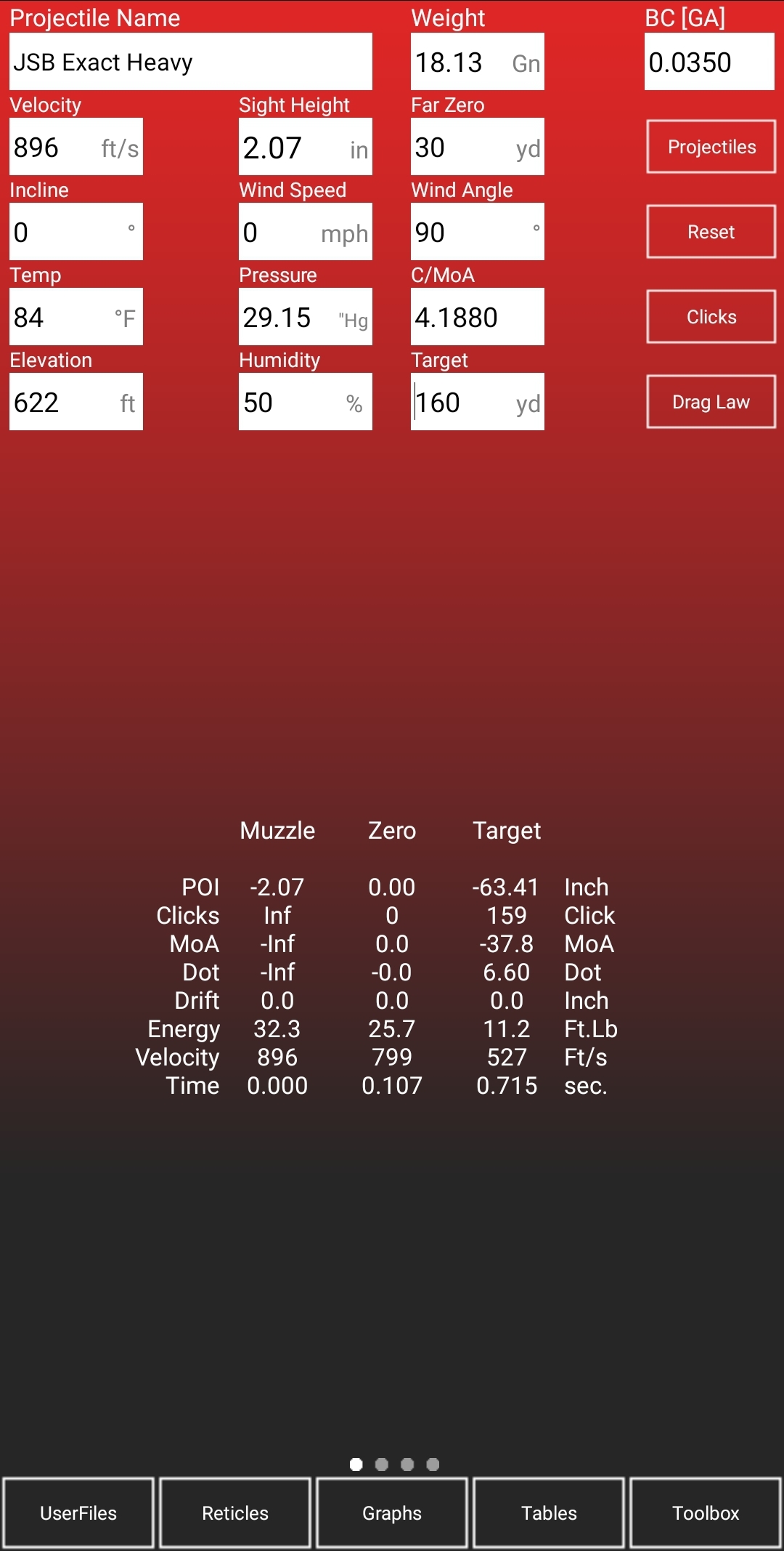

Here is my set up and the dot holdover is for my scope at 6x zoom. 16x zoom says 17.61 dots down... I only have 9 lol. I really like to see what I'm shooting at so if I were doing 160 yards man I'd have a 7 foot diameter blaze orange or neon yellow target! Lol

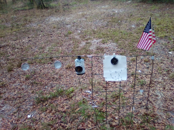

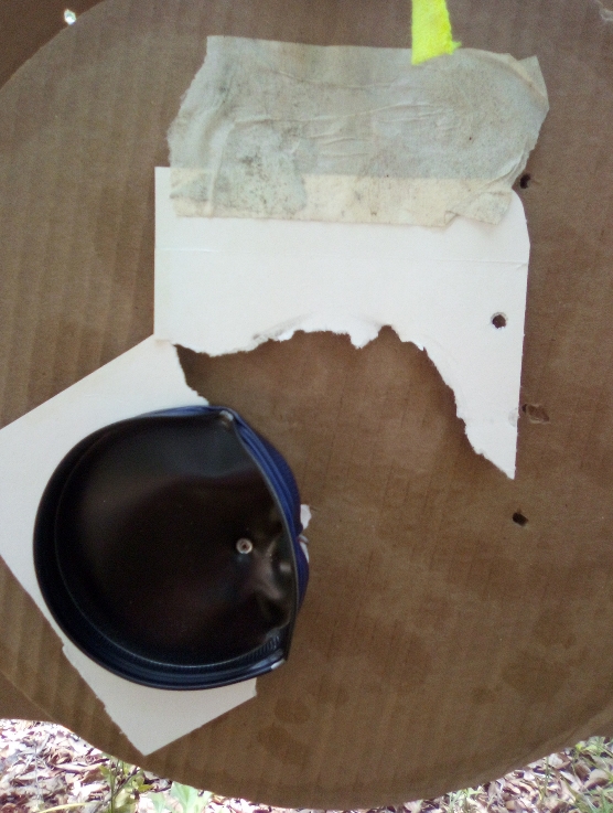

Man youd be lucky to even get 1/4 of that here..lol.
100y rack and crosman lids blackened taped on for a bulls. Thats top end stuff.
