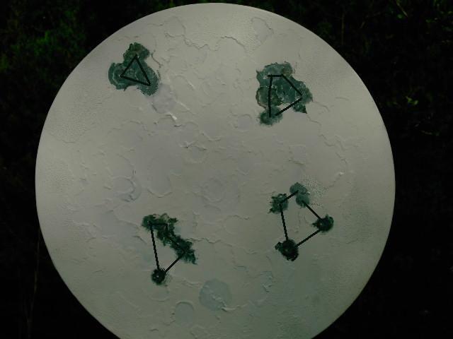

Here are a few real-world results-
Four consecutive SIX-shot groups at 100 yards in medium winds with 33.95 grain JSBs at 915 PFS/63/3 foot-pounds from my .25 Sumatra-

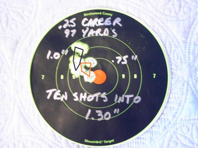

Two five-shot groups with the same ammo and power-level with a .25 Shin Sung Career rifle at 97 yards in still winds-
