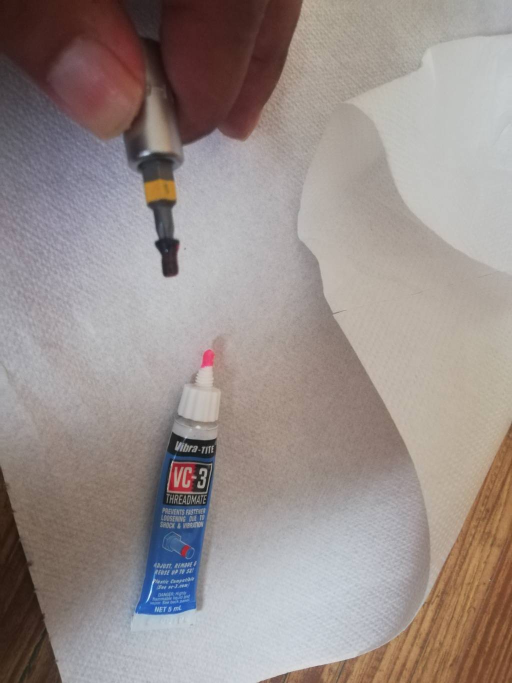

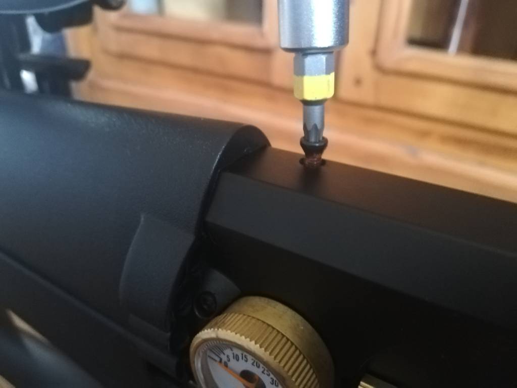

One drop on the screw
Yes!!! it works the air leak is fixed
