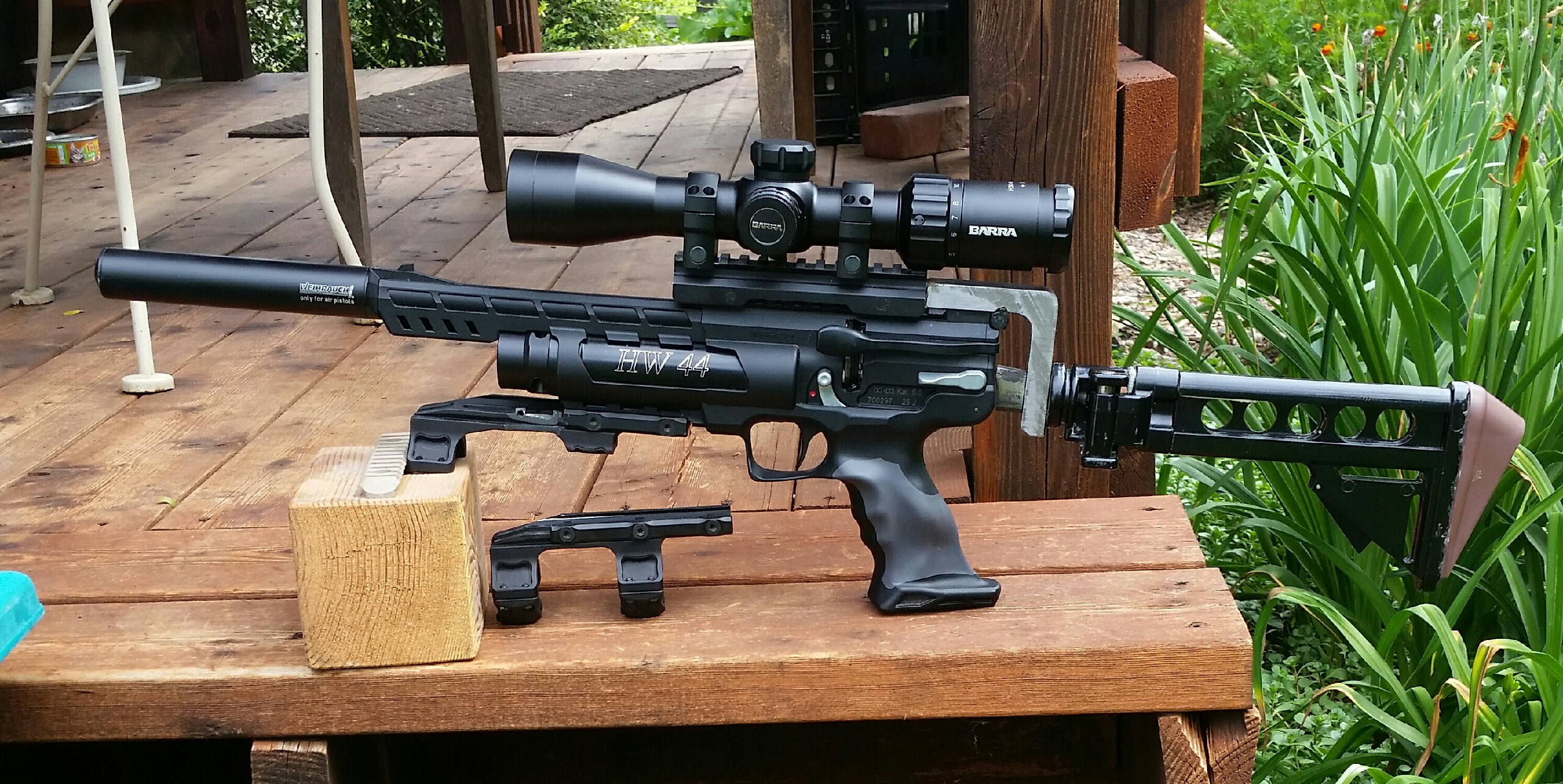

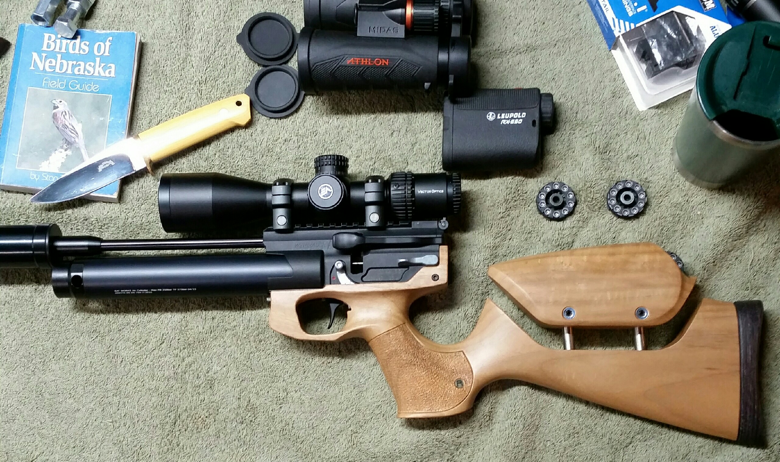

two things to figure out
1, butt pad is wood and slips down, the rubber door stop wedge on the ole frankie gun worked better, but is junk yard dog stuff. I like the wedge shape for holding the pcps up higher on the shoulder and rubber material helps it hold against clothing
2, need something under the air tube, I am thinking about sacrificing the old barrel/tube sleeve
this piece but they are out of stock,,, I like to have a good one on hand just incase, to switch everything back to original
but I know me,,, I probably will chop up the one I have and hope I can get a replacement

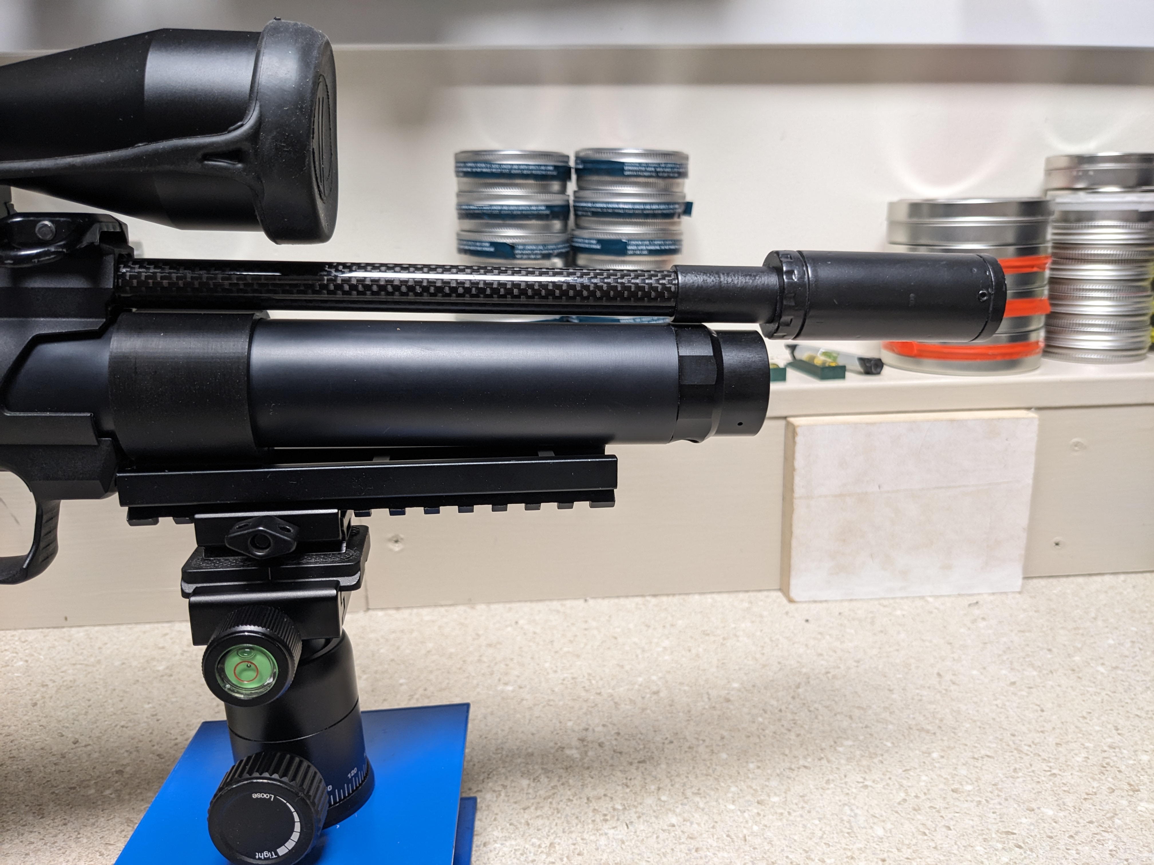

Check these out. They are very well made.

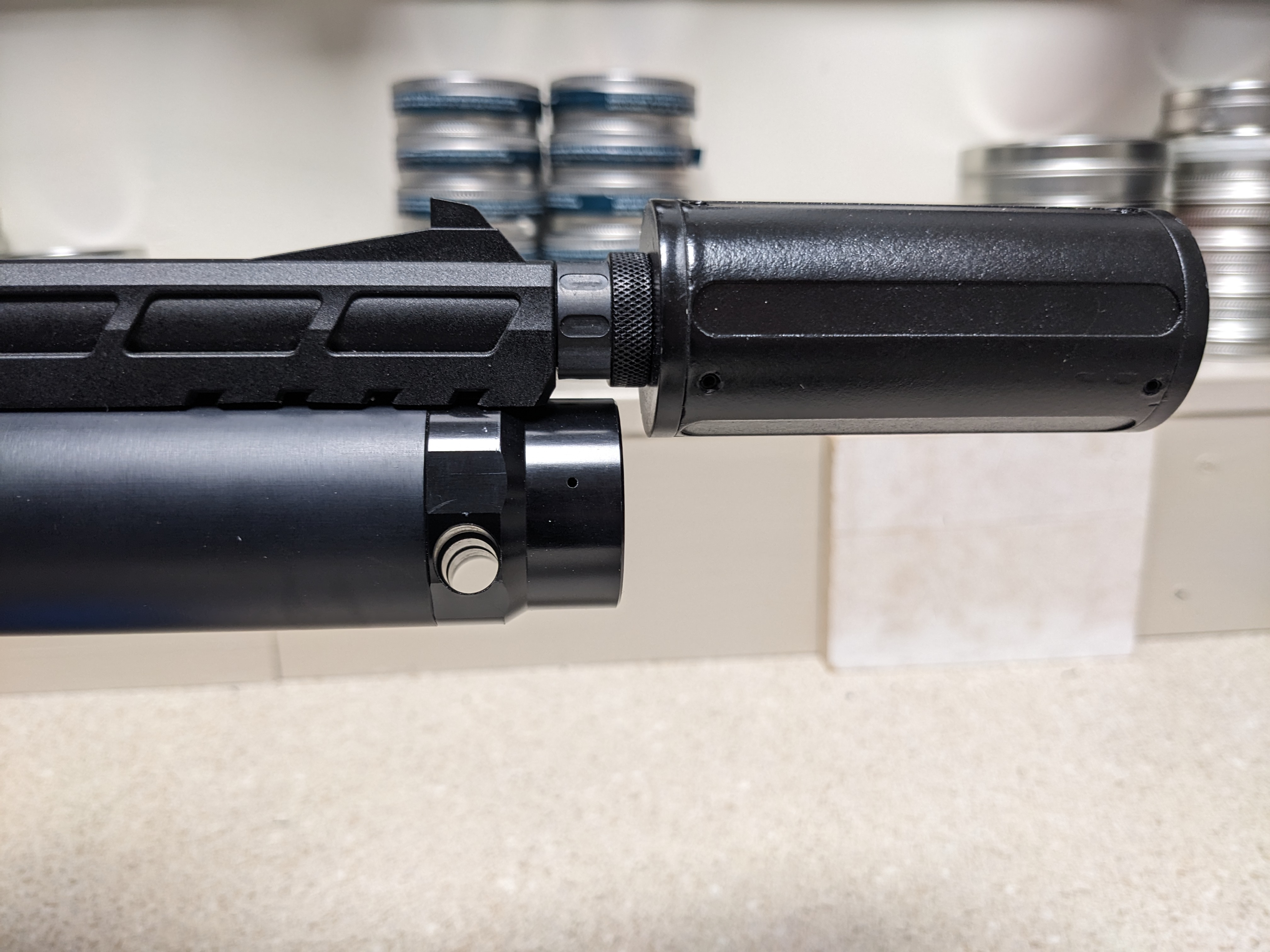

If you should decide to cut your barrel sleeve down I highly recommend this barrel adapter from Trajectron
Using this you can simply trim the lower part of your barrel sleeve down and get a nice fit.
I originally cut the end off the sleeve and added a DFL adapter. I would not recommend that method.
I've spent waaay to much money trying to figure out what works best (for me). I personally like trimming the lower part of the barrel sleeve and adding the barrel adapter.

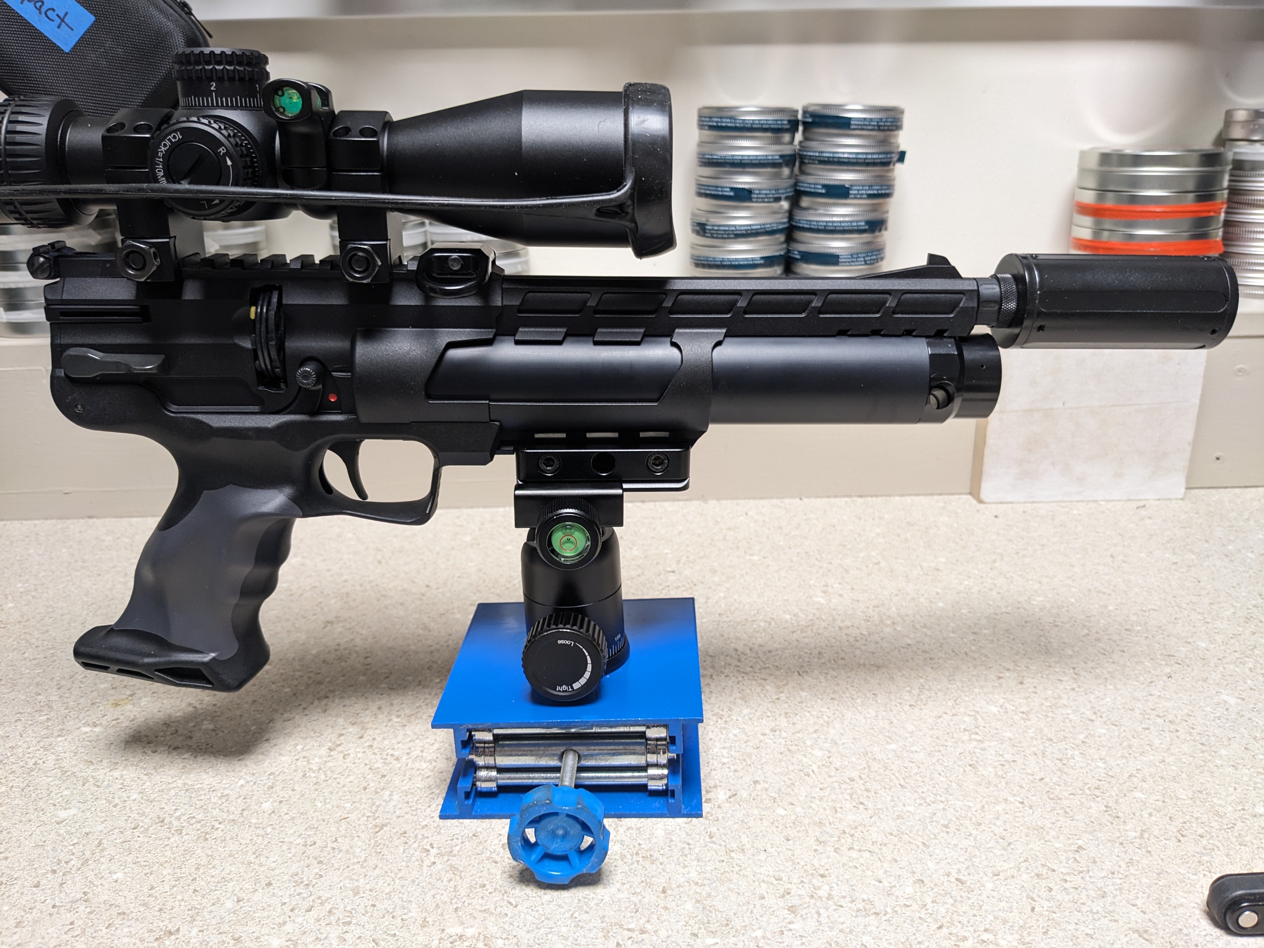

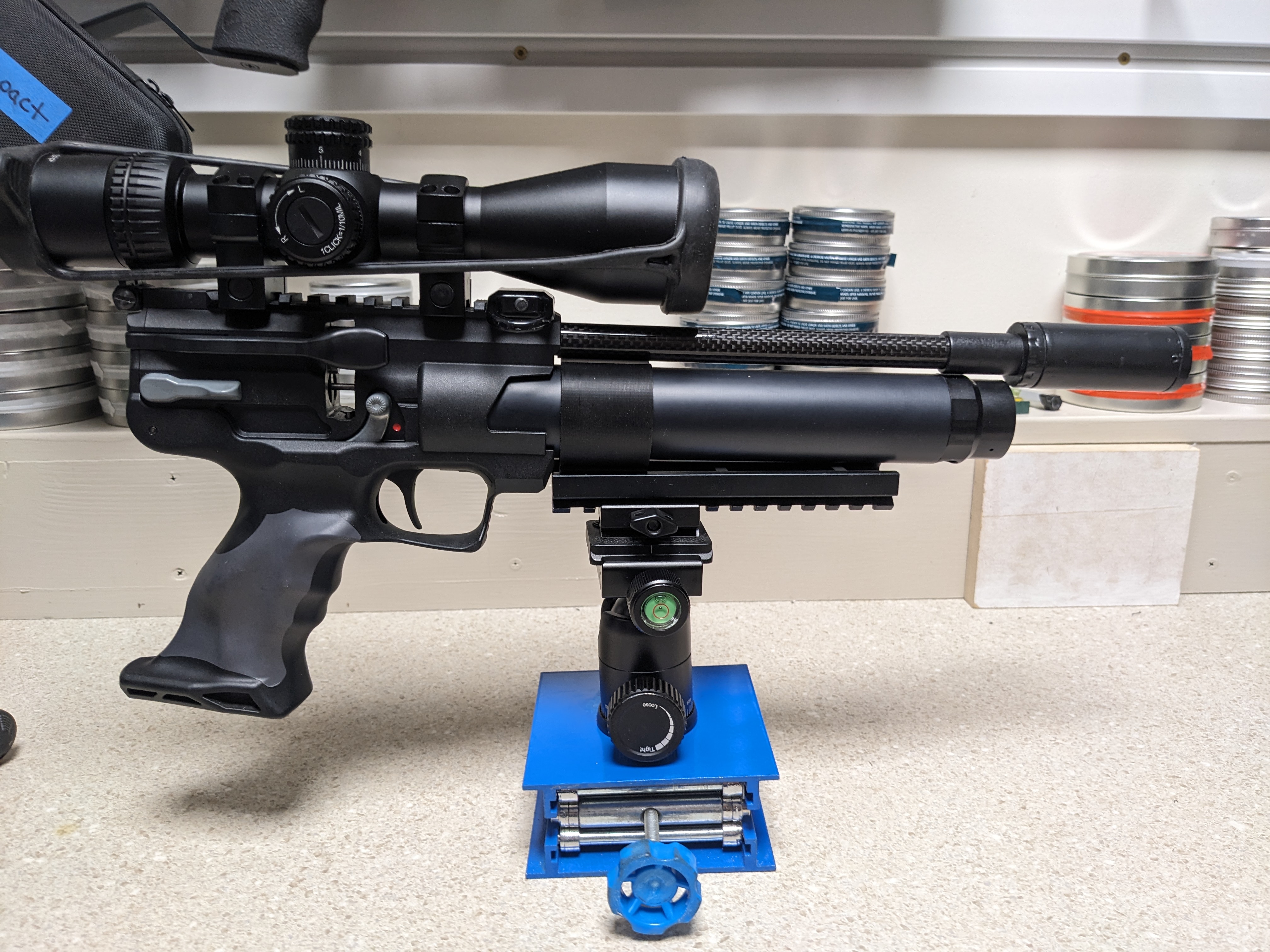

Here's some pictures of my current set ups. I'm fine with trimming the sleeve because there's no way I'd ever want to got back to the original cylinder.
I added carbon fiber sleeves on one to dress up the skinny barrel a bit. One to fit the barrel and another to fit over it. Overkill but I thought it looked pretty good.

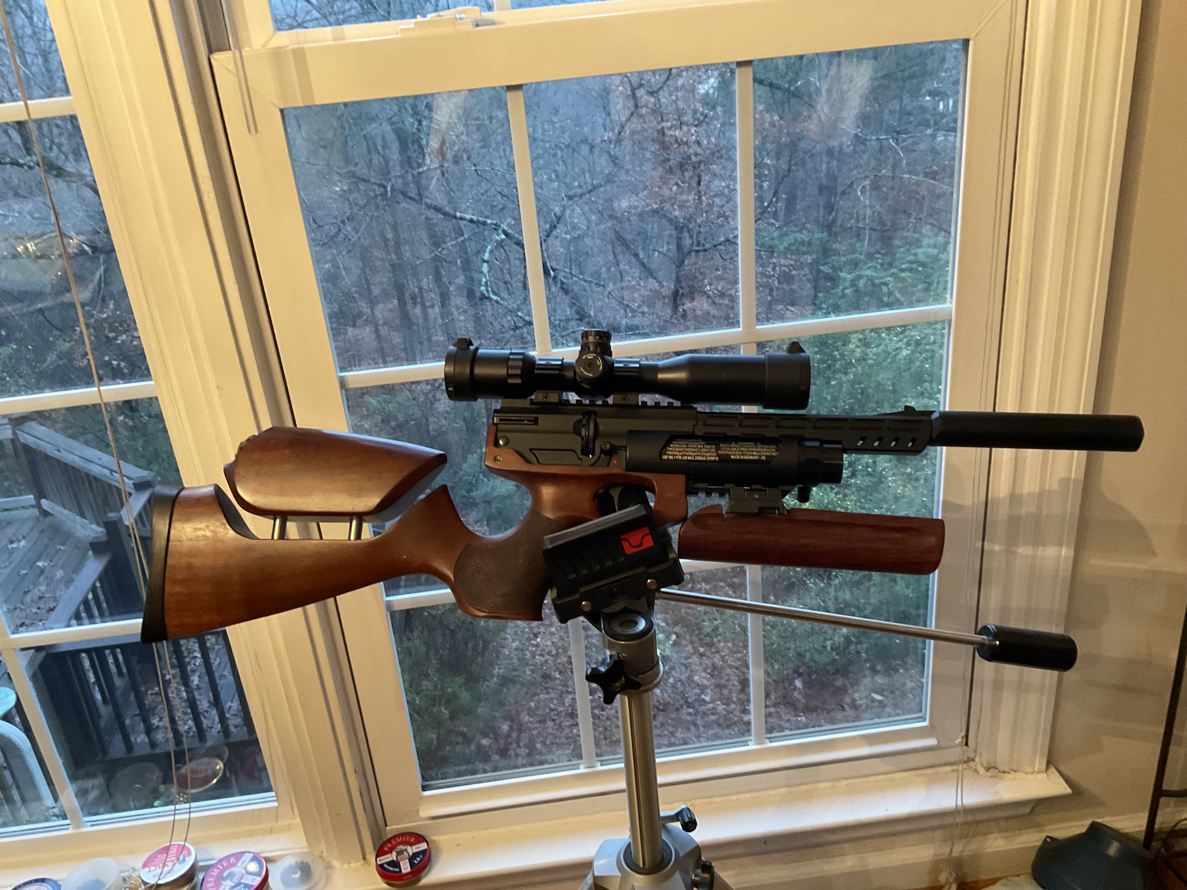

PHOTO bomb away lets see your Frankie gun
Reactions: Str8tshooter

The Weihrauch moderators work super well but they are sooooo long. Much as I like the way they work I've reduced the power on all my HW44's and HW100's and replaced them all with much shorter ones. The Weihrauchs seem to waste less air, shoot smoother and bark less at lower power levels. I'd say they're more accurate, but I think that not exactly the case. They're probably still just as accurate, just more difficult to shoot accurately. It made a huge difference on my HW44/.22.

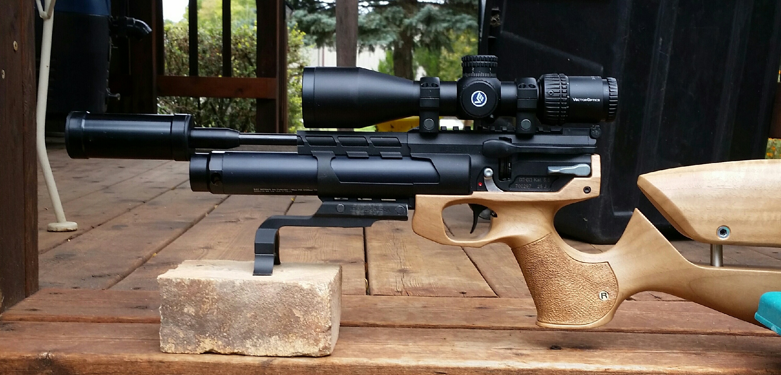

My eyes tell me that the cocking lever is moved over to the right side of the pistol. And the picture doesn't seems to mirrored. Just to make sure there's nothing fishy going on here: Is it a straight forward modification to move the cocking lever from the left side over to the right side? If so the HW44 with a HW100 cylinder and a Rink stock is rocketing rapidly up on my "wanna have" list. :)
Reactions: maxtrouble
