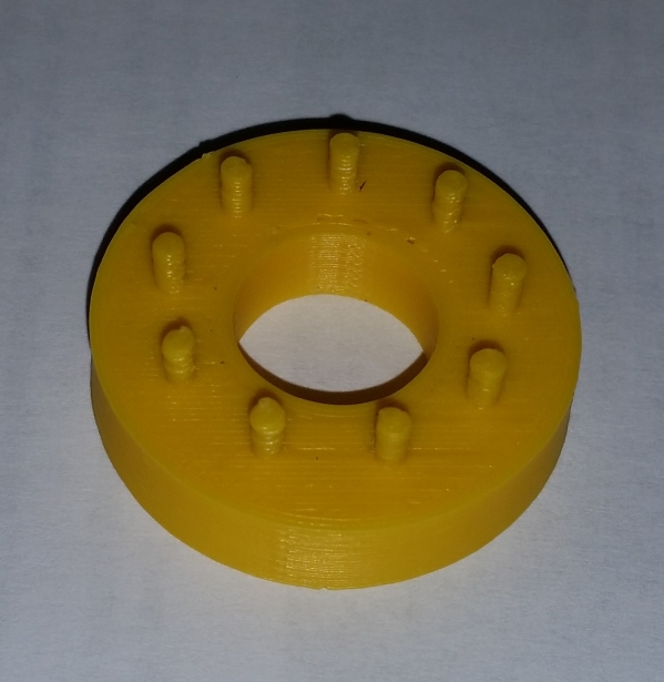

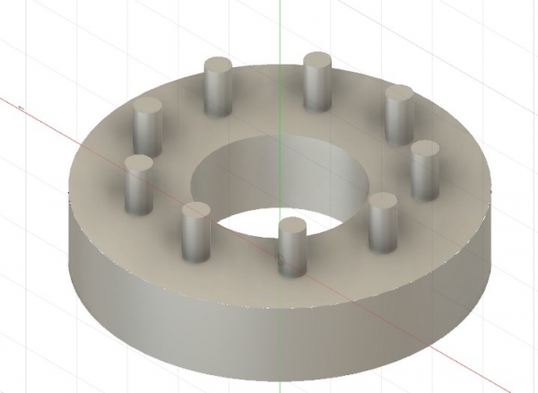

Does anyone else find loading pellets deep enough into Edgun mags a PITA? Sometimes I don't press the pellets far enough in and the mag hangs up when inserted into the gun, R5M. Fixing the problem destroys the skirts of one or more pellets. So I drew up this 3d printed part to push the pellets deeper all at once. I should get it in about a week I hope it works well.

My friend I'm going to save you a lot of time, here's what you do. Load the pellets into the mag. Then simply lightly slap it, pellet nose side, down on the counter, floor, shooting table, once or twice. This will shift all the pellets down into the magazine and they will all be sitting at the same distance from the magazine edge. This is what I do and it works well without any need for any additional tool. And you are right, if the pellets are not all positioned below the edge of the magazine it will hang up. At least it does on my Lelya.
