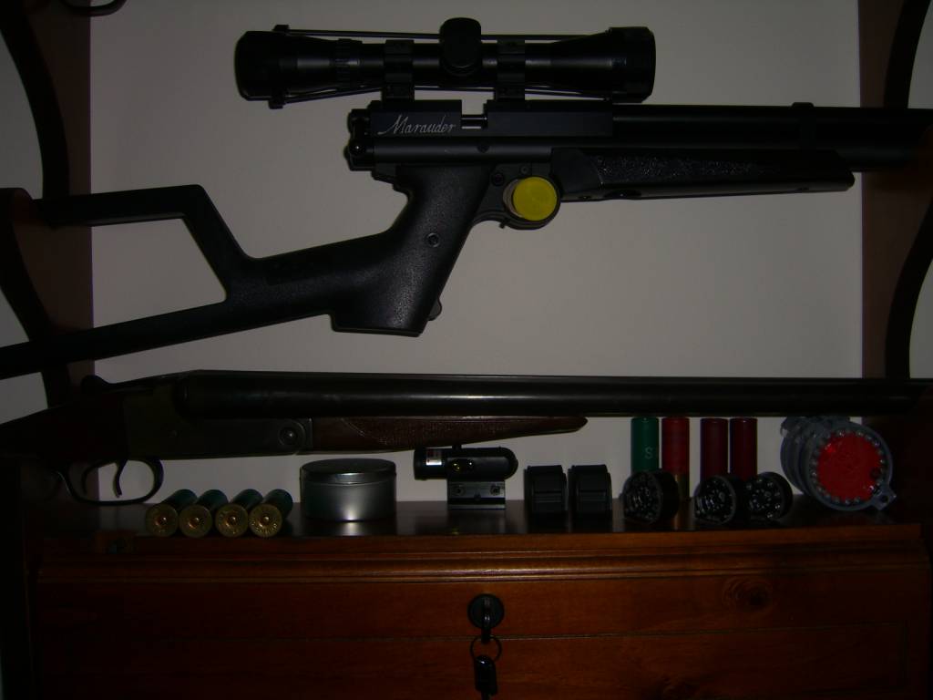

The biggest problem with using a cleaning rod or wooden dowel is the possibility you may damage the chamber O-Ring in the process. I have a system that I use that works reliably in this scenario. If I have a round chambered and I don't fire it:
  1. I remove the magazine, then uncock my gun (Benjamin Bulldog).
  2. I fill up my magazine I just removed minus one round and put everything away.
  3. When I go back to my gun, I look at all the magazines I have in the case. If every magazine isn't full, I know that's the one that I had in the gun last.
  4. I cock my gun and insert the magazine that's missing one round. I then rotate my magazine to the empty slot so I don't double feed a round into the chamber.
  5. If I am ever in doubt, I click the gun, and while leaving the bolt open, I shine a laser into the chamber with the gun pointed at the floor. If I see a the laser on the floor, the gun is empty. If not, something is in the chamber.
  6. Under no circumstances should you ever look down the barrel of a cocked, pressurized gun! Never!

    I have two Bulldogs, and I meticulously follow this same procedure on both guns. Once you build a process, stick to it.
