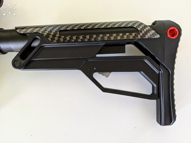

Yes. I believe those are standard AR15 thread and lock nut on the back though I haven't tried replacing it. The one included with the Backpacker feels cheaper...even toylike, compared to the one that came with the HP Varmint. Which is a good segue for my one other quality comment. The attachement between the buttstock and the receiver is a little looser than I'd like. I tried shimming it with a piece of aluminum can...in between the tube and the receiver but that didn't make a lot of difference. I think the right sized washer slide in between the delrin spacer at the front might be the solution...but it would be an odd size an maybe something best machined from delrin.

Yes, the folding mechanism that goes into the receiver is loose between the tube and the receiver. It is retained by two knurled pins. The issue is the length is depth in the receiver is not a lot and there needs to be clearance to slide it in...that clearance combined with the short length allows it to move more than I like. I don't have an AR15 but I'm guessing the attachment into an AR15 receiver is different.
It collapses and extends. It took me a little while to figure out how it worked on the Backpacker. I hadn't seen a mechanism like the one on the backpacker before and neither gun came with any type of manual. On the Varmint it works like most I've seen. Push the button down to slide the stock in and out. Pull it up to remove. On the Backpacker, you push the button down to release the entire lower assembly which pivots down to release the lock pin.
Interesting... Looks like the Buffer Tube it slides on is pretty standard. What's up with all the pins? I wonder if some long screws with acorn nuts could be used so they could be tightened a bit more and have it feel more secure?
I doubt you could get any compression on the tube. I think the best bet is to shim the spacer tube.
By the way, that buttstock does not match the one in the photo I bought or the new photo they show. I don't like it. Too ostentatious...and feels a bit cheap and toylike to me. I contacted the seller on that and am hoping he can get me the correct one.
One final note. The grip is not standard AR15, unfortunately, so you can't just swap it out. It is a two piece affair...a nylon internal part that attaches to the receiver with a 5mm allen bolt and a rubberized cover. It actually feels pretty good so I wouldn't have swapped it out anyway.

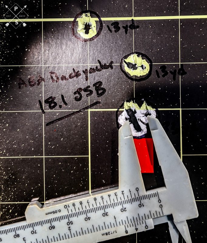

Got rid of that abysmal Tasco scope and put on a 4-14x Athlon FFP. Got some quick groups in to sight it in. .38" @ 33 yds resting on ottoman with 18.1 gr. JSB's shooting out back door...a very specific shot. 😉
13 yd. groups were to get a confirmation of holdover.
