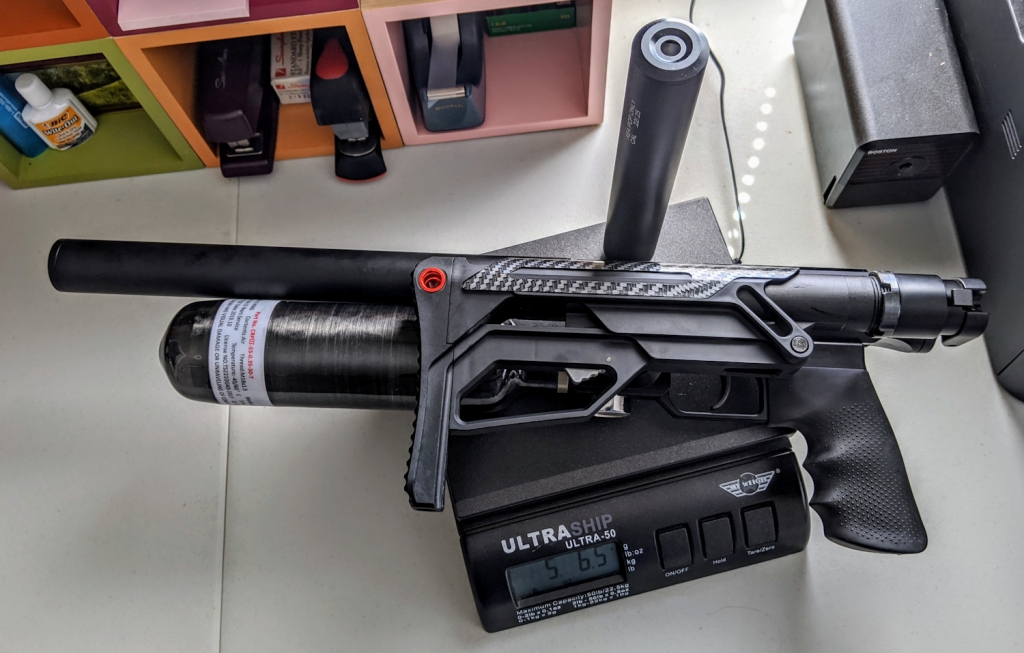

The little Backpacker folds up nice and small and is relatively light (5lb, 6.5oz.) I've got a crap Tasco scope mounted on it right now that I'm still evaluating.

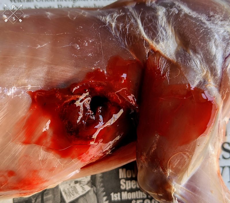

H&N BHX's do an impressive job at those velocities.
Entrance wound.

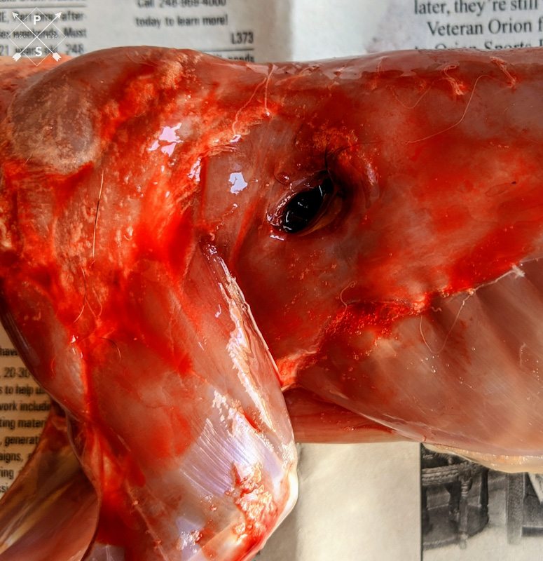

Exit wound.
13" barrel. Length folded with mod off is 20".

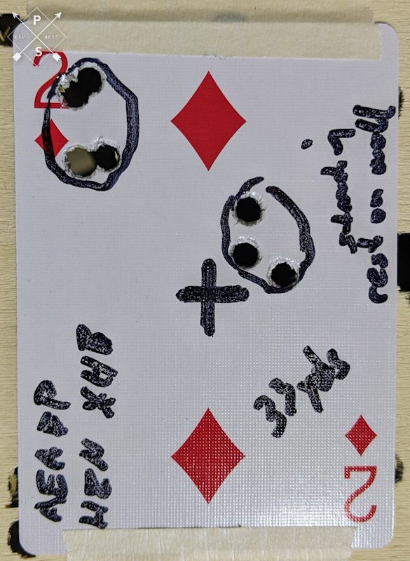

Here's a couple 33 yd. groups I shot earlier today, standing using the door frame as a rest. They were supposed to be three shots but I miscounted.
